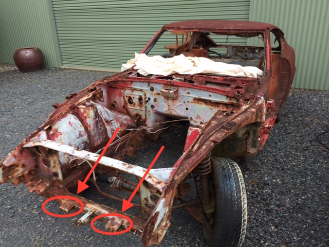

June 3, 20177 yr comment_522239 On 5/27/2017 at 9:55 PM, kats said: Thanks Blue and Alan, We want to know what purpose does these nuts have for ? Kats Since we're on the topic, I feel like someone may have mentioned this before. But I can't recall now. What is the purpose of these brackets on the lower radiator support panel? The photo is car HS30 00836 - yes she's seen better days... Link to comment https://www.classiczcars.com/forums/topic/23900-datsun-240z-vs-fairlady-z432/?&page=63#findComment-522239 Share on other sites More sharing options...
June 3, 20177 yr comment_522241 32 minutes ago, Gav240z said: Since we're on the topic, I feel like someone may have mentioned this before. But I can't recall now. What is the purpose of these brackets on the lower radiator support panel? Apparently they were part of a short-lived factory air con prep, relocating the horns to make more space for the condenser. 74820-E4201 was a factory replacement 'one size fits all' front crossmember/lower radiator support panel which incorporated them. It was superseded in 7/72. They are a little odd because they seem to be more often seen on cars that have had replacement crossmembers/lower rad supports fitted than on cars that left the factory with them... Link to comment https://www.classiczcars.com/forums/topic/23900-datsun-240z-vs-fairlady-z432/?&page=63#findComment-522241 Share on other sites More sharing options...

June 4, 20177 yr comment_522294 22 hours ago, 240260280 said: Hurray Alan!!! Finally an answer!!! Mystery solved. I wouldn't close the file just yet. I still think there's more to be learned and understood about them and the story behind them. It's a mod/supersession that seems to have gone off half-cocked as far as I can see. I suppose we could surmise that the coming re-design of the rad support and lower crossmember (for the bigger radiator area) made the additional brackets obsolete, but I'm still curious. Link to comment https://www.classiczcars.com/forums/topic/23900-datsun-240z-vs-fairlady-z432/?&page=63#findComment-522294 Share on other sites More sharing options...

June 7, 20177 yr Author comment_522491 Thanks everyone, I really like these conversations, anything is well come here. Gave, I too think the support member is generic , as Alan mentioned it has a part number Z432 code, E42 . That is strange because Z432 does not have air conditioning system. And we see the member even has a small brackets for a Z432's air filter box. Would Nissan engineers have intended to put the two big rudders just for horns for Z432 with an oil cooler , and for a condenser for air conditioned car ? "If you do not use it, just leave it" Kats Link to comment https://www.classiczcars.com/forums/topic/23900-datsun-240z-vs-fairlady-z432/?&page=63#findComment-522491 Share on other sites More sharing options...
