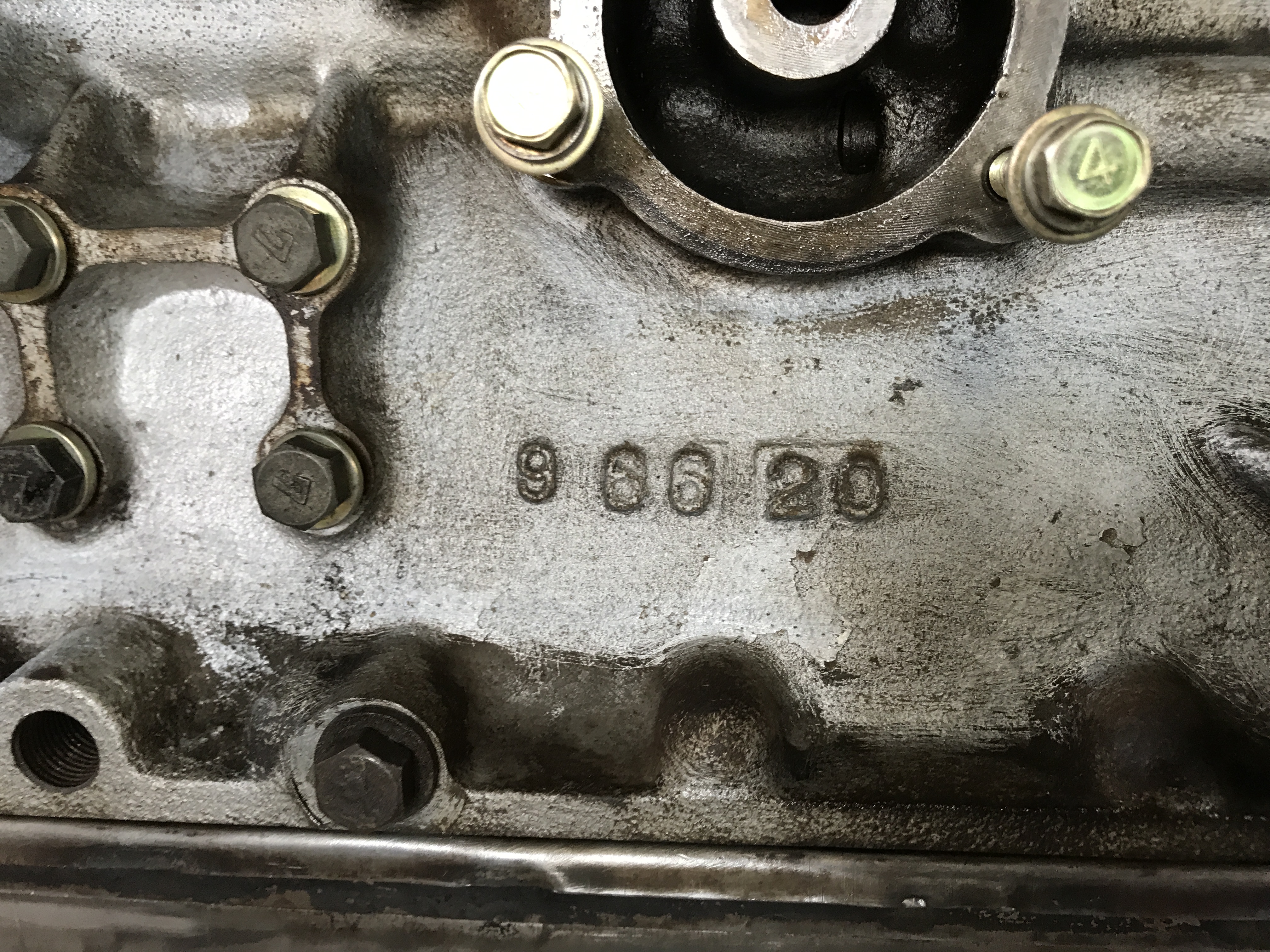

June 16, 20177 yr Author comment_523252 A front cover of the S20, an unusual surface at top of the crank hole immediately caught my eyes, what is that? I am worrying about this cover has had repaired once before, has not it? As a reference, the third picture is my Z432's cover, I see a lot of casting small dents, and some rough surface at top of the crank hole. I need to look at it more carefully. Kats I see casting code, "9 6 6 20 " I think this means "1969 June 6th " , I do not know last "20" And the water pump, temporarily a GTR one is fitted. Edited June 16, 20177 yr by kats Link to comment https://www.classiczcars.com/forums/topic/23900-datsun-240z-vs-fairlady-z432/?&page=66#findComment-523252 Share on other sites More sharing options...

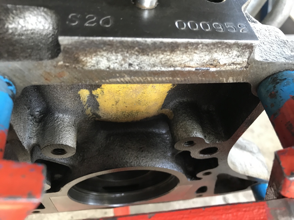

June 16, 20177 yr comment_523258 31 minutes ago, kats said: I see casting code, "9 6 6 20 " I think this means "1969 June 6th " , I do not know last "20" Kats, For reference, the 432-type S20 engine in my 432-R replica is stamped engine # S20-000877, and block casting numbers are 9 2 11 32: There was some suggestion that a batch of 432-type S20 engine blocks were cast at the same time as a batch of mid/late production PGC10 GT-R engine blocks, early in 1969. Link to comment https://www.classiczcars.com/forums/topic/23900-datsun-240z-vs-fairlady-z432/?&page=66#findComment-523258 Share on other sites More sharing options...

June 19, 20177 yr Author comment_523461 Hi Alan, your S20-000877 is also a good example, casting code is corresponding to the serial number. My 000884 is a bit later from yours , so that my casting code is showing bigger numbers than yours. Alan and anyone please help me to identify this LSD, do you think this is a correct R192 "4 pinion " / 2 way LSD ? I only see two round windows which are open for pinion shaft, these are supposed to be four , are not they? And two way or 1.5 way, it looks two way for me, but I am not for sure. I visited Matsui -san today, he said hello to you Alan, I wish I had plenty time to talk with Matsui-san , it was so fun. Kats Link to comment https://www.classiczcars.com/forums/topic/23900-datsun-240z-vs-fairlady-z432/?&page=66#findComment-523461 Share on other sites More sharing options...
