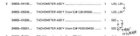

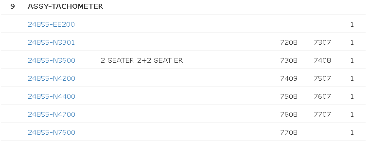

January 5, 20187 yr comment_539046 On 1/4/2018 at 9:54 PM, kats said: Thank you Blue !! I did not know it is able to swap, what a wonderful solution . Am I the only one who did not know this here ? I have never heard of this in Japan, even some Z shop is telling it is almost impossible to make a replica , not only mechanical but also 10000 face. Or if it can be , you have to pay big money. Internal issues are cleared, then if you have some good painter for the 10000 face, you can get a Z432 tach easily. Some questions, #1 when did S30s have voltage type tach ? Was it related to the change that they became to have a transistor ignition system ? #2 In this swap, the 280Z tach is really capable to bring its needle up to 10000 rpm ? I am just a skeptical person little bit, because I do not have any electronic/mechanical knowledge. Kats Hi Kats, I'm glad to help. #1 I checked the FSM's for North American Z's and the first electronic ignitions started in 1974 with the 260z. The start date would be 08/73. You can see the tach part numbers here: http://www.carpartsmanual.com/datsun/Z-1969-1978/electrical/meters. I checked the 260z schematic and the input to the tach is taken from the coil -neg terminal so it is voltage type tach. #2 I did not calibrate 280z meters yet but I have some spares and can try to see if I can adjust the sensitivity and scale to respond to the equivalent to 10,000 rpm (input = 500Hz). The 280z unit goes to 8,000 rpm which is driven by 400Hz so there is not a huge input difference. Edited January 7, 20187 yr by 240260280 Link to comment https://www.classiczcars.com/forums/topic/23900-datsun-240z-vs-fairlady-z432/?&page=77#findComment-539046 Share on other sites More sharing options...
