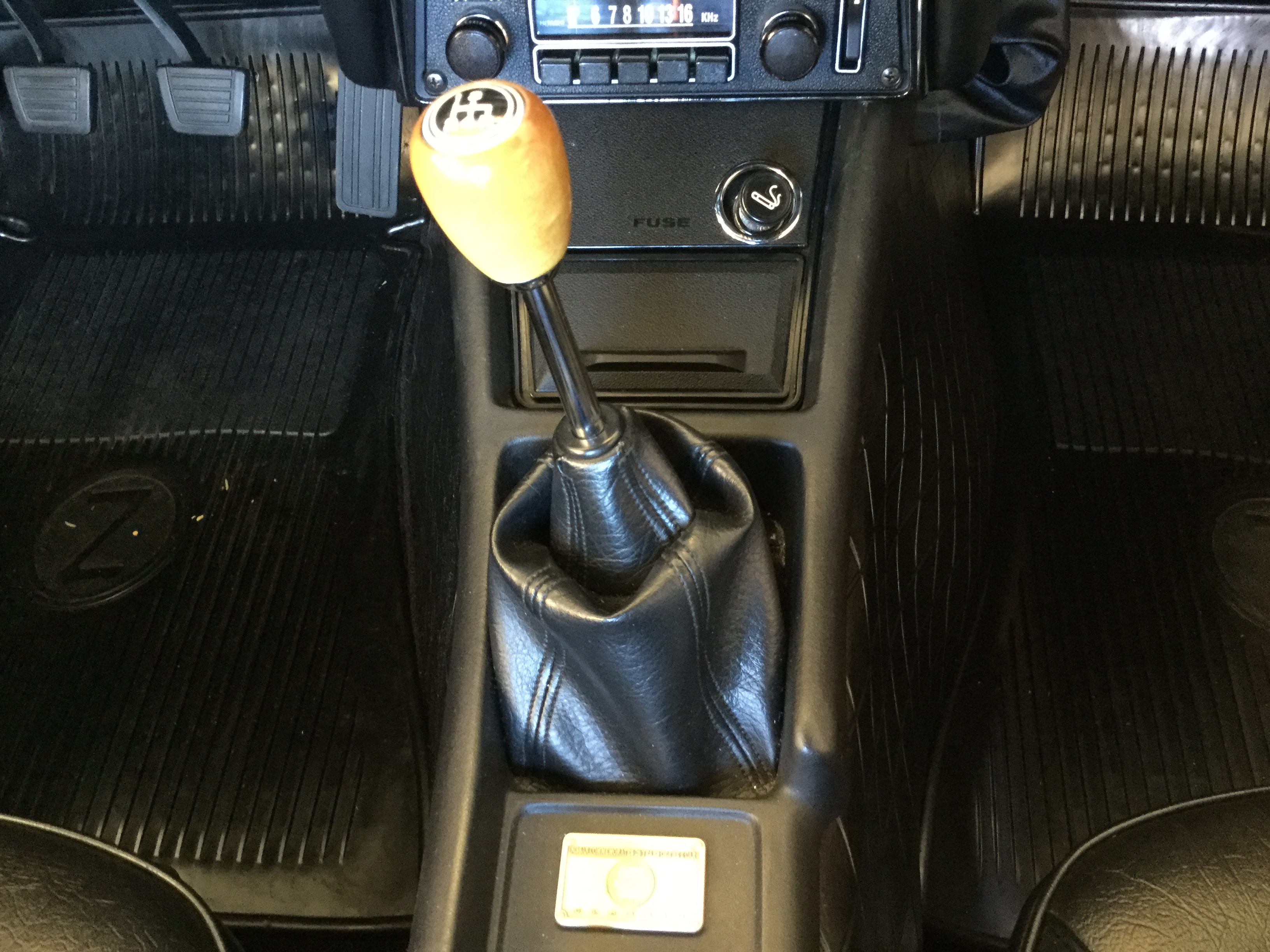

January 27, 20187 yr Author comment_540908 Which style do you mostly like ? Can I say I am doing my original style for the shift boot ? My favorite is ‘ grommet on top ‘ style. But I checked various pictures in brochures and old magazines, there are different kind of style. Enjoy pictures. Kats Link to comment https://www.classiczcars.com/forums/topic/23900-datsun-240z-vs-fairlady-z432/?&page=79#findComment-540908 Share on other sites More sharing options...

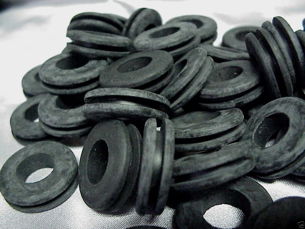

January 27, 20187 yr comment_540909 Here is a rubber grommet that looks like it will work: 25mm diameter 12.5mm hole Some car rubber detailer fluid will make it black and shiny. https://www.ebay.com/itm/30-Rubber-Grommets-1-O-D-x-1-2-I-D-Hole-plus-or-minus/272214549916?hash=item3f6140659c:g:LJMAAOSwiylXBQk2 Link to comment https://www.classiczcars.com/forums/topic/23900-datsun-240z-vs-fairlady-z432/?&page=79#findComment-540909 Share on other sites More sharing options...

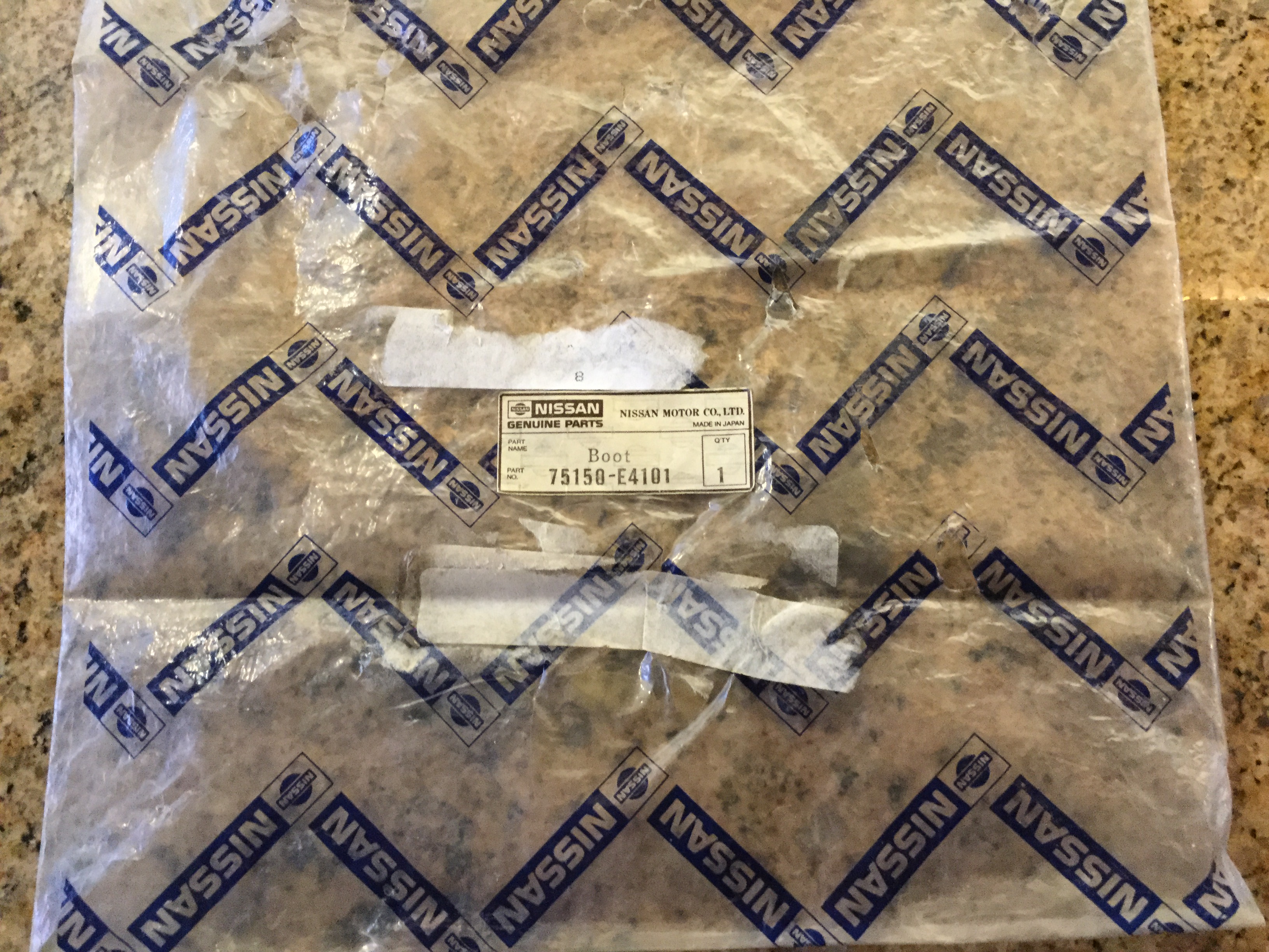

January 27, 20187 yr comment_540921 Hi Kats, Before I found my NOS shift boot shown below, I too was trying to find the correct grommet in order to make a good reproduction boot. You may want to contact Nix at www.240zrubberparts.com to see if he could make this grommet. I would think that a well reproduced early shift boot would be very popular. Dan Link to comment https://www.classiczcars.com/forums/topic/23900-datsun-240z-vs-fairlady-z432/?&page=79#findComment-540921 Share on other sites More sharing options...

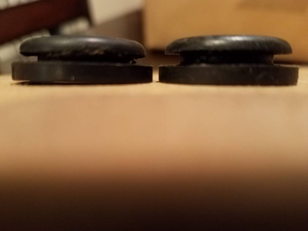

January 28, 20187 yr comment_540949 I've got two originals I could send you. One is softer than the other. I guess one hardened over time. The overall height is the same but one has a bigger gap than the other.Sent from my [device_name] using http://Classic Zcar Club mobile Link to comment https://www.classiczcars.com/forums/topic/23900-datsun-240z-vs-fairlady-z432/?&page=79#findComment-540949 Share on other sites More sharing options...

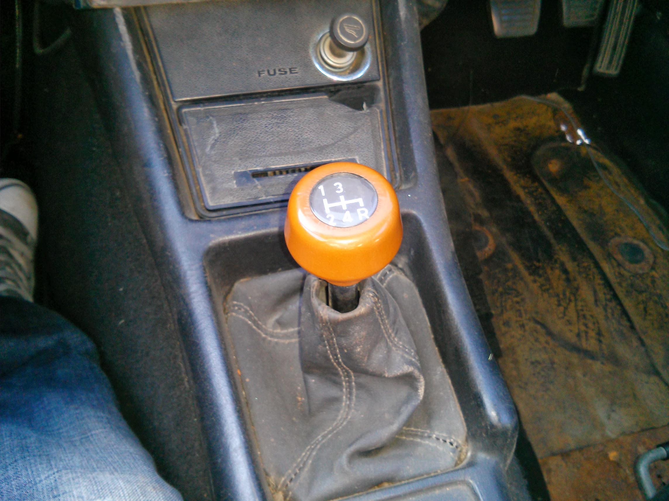

January 28, 20187 yr comment_540965 20 hours ago, kats said: Which style do you mostly like ? Can I say I am doing my original style for the shift boot ? My favorite is ‘ grommet on top ‘ style. But I checked various pictures in brochures and old magazines, there are different kind of style. Enjoy pictures. Kats Hi Kats, that photo is from HS30 00004, I have not seen the grommet top part of the boot on an AU market car. I have to say it's also my favorite style. I have attached a photo of the boot from HS30 00150 which I assumed was just missing the grommet, but now that I see the photo of HS30 00004's in more detail I'm inclined to think maybe it never came with that grommet? Link to comment https://www.classiczcars.com/forums/topic/23900-datsun-240z-vs-fairlady-z432/?&page=79#findComment-540965 Share on other sites More sharing options...
