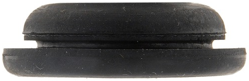

January 28, 20187 yr comment_540989 Here is a common Ford PCV 1/2" grommet part 42065 available at most autozone, canadian tire, etc shops. It comes close: 1/2" hole, 1" top curved face, 1.4" bottom face https://www.oreillyauto.com/detail/dorman-help--4422/filters-16470/pcv-valve-grommet-12023/dorman-help-pcv-valve-grommet/42065/4527812/1989/ford/f-350 Part 42066 comes close too: https://www.oreillyauto.com/detail/dorman-help--4422/filters-16470/pcv-valve-grommet-12023/dorman-help-pcv-valve-grommet/42066/4527813/1968/ford/mustang Edited January 30, 20187 yr by 240260280 Link to comment https://www.classiczcars.com/forums/topic/23900-datsun-240z-vs-fairlady-z432/?&page=80#findComment-540989 Share on other sites More sharing options...

January 30, 20187 yr Author comment_541135 On 2018/1/29 at 4:28 AM, 240260280 said: Here is a common Ford PCV 1/2" grommet part 42065 available at most autozone, canadian tire, etc shops. It comes close: 1/2" hole, 1" top curved face, 1.4" bottom face https://www.oreillyauto.com/detail/dorman-help--4422/filters-16470/pcv-valve-grommet-12023/dorman-help-pcv-valve-grommet/42065/4527812/1989/ford/f-350 Part 42066 comes close too: https://www.oreillyauto.com/detail/dorman-help--4422/filters-16470/pcv-valve-grommet-12023/dorman-help-pcv-valve-grommet/42066/4527813/1968/ford/mustang This looked very close to mine ! Kats Link to comment https://www.classiczcars.com/forums/topic/23900-datsun-240z-vs-fairlady-z432/?&page=80#findComment-541135 Share on other sites More sharing options...

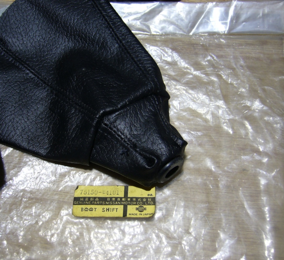

January 30, 20187 yr Author comment_541136 I will break down my original boot , cut every thread and spread the boot to see how the vinyl is shaped and sawed . Kats Link to comment https://www.classiczcars.com/forums/topic/23900-datsun-240z-vs-fairlady-z432/?&page=80#findComment-541136 Share on other sites More sharing options...
January 30, 20187 yr Author comment_541142 On 2018/1/28 at 5:55 PM, Gav240z said: Hi Kats, that photo is from HS30 00004, I have not seen the grommet top part of the boot on an AU market car. I have to say it's also my favorite style. I have attached a photo of the boot from HS30 00150 which I assumed was just missing the grommet, but now that I see the photo of HS30 00004's in more detail I'm inclined to think maybe it never came with that grommet? Hi Gavin, thank you for the photo of HS30-00150, it looks like a genuine leather. Maybe a dealer option at that time ? About HS30-00004, it looks it has an exact stock boot for me. I do not see any reason that Nissan would apply multiple type of boot according to its destination. I believe there was an only one boot for early models up to sep 1971 is , this one , thin vinyl leather with the grommet, 75150-E4101. Kats Edited January 30, 20187 yr by kats Link to comment https://www.classiczcars.com/forums/topic/23900-datsun-240z-vs-fairlady-z432/?&page=80#findComment-541142 Share on other sites More sharing options...
