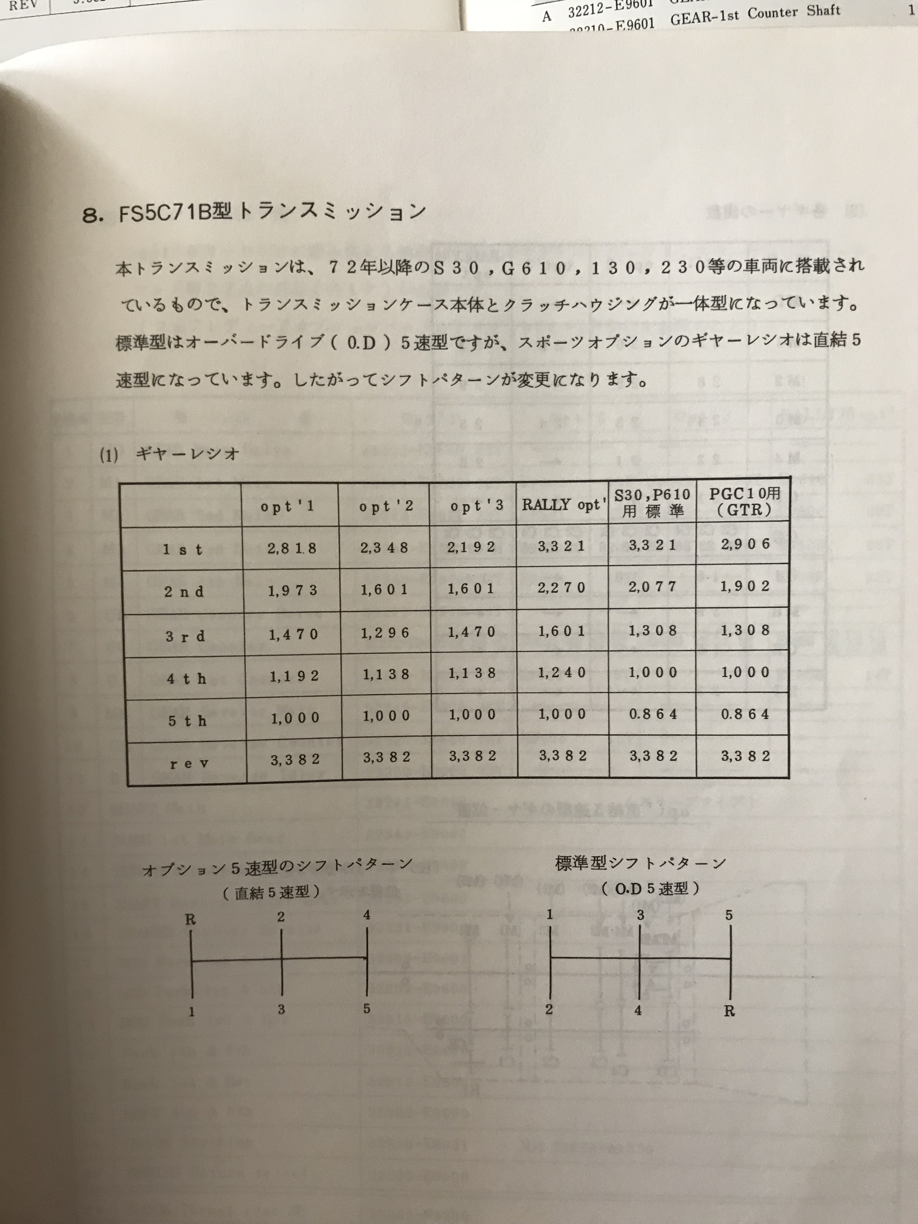

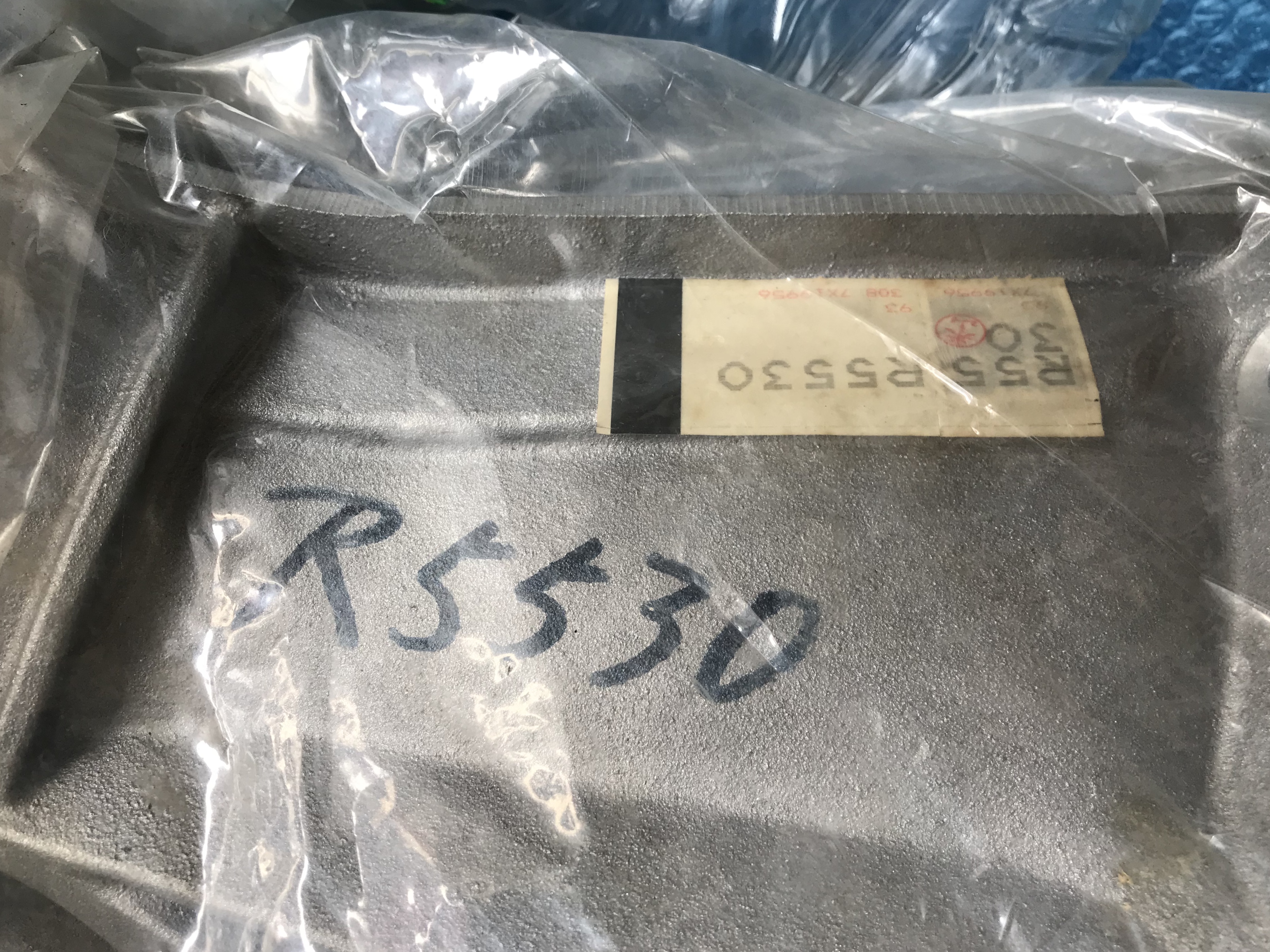

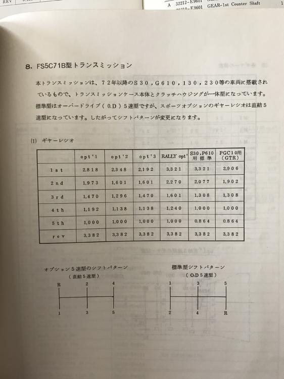

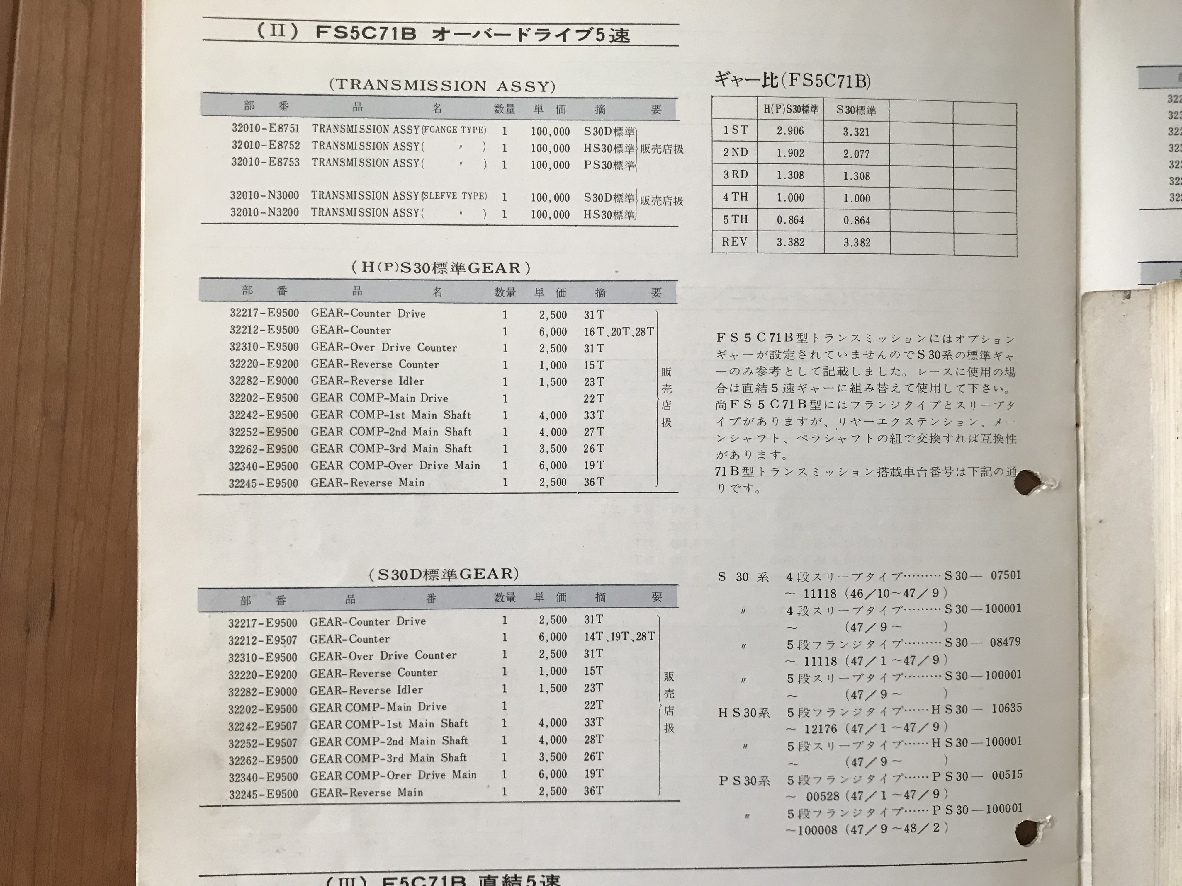

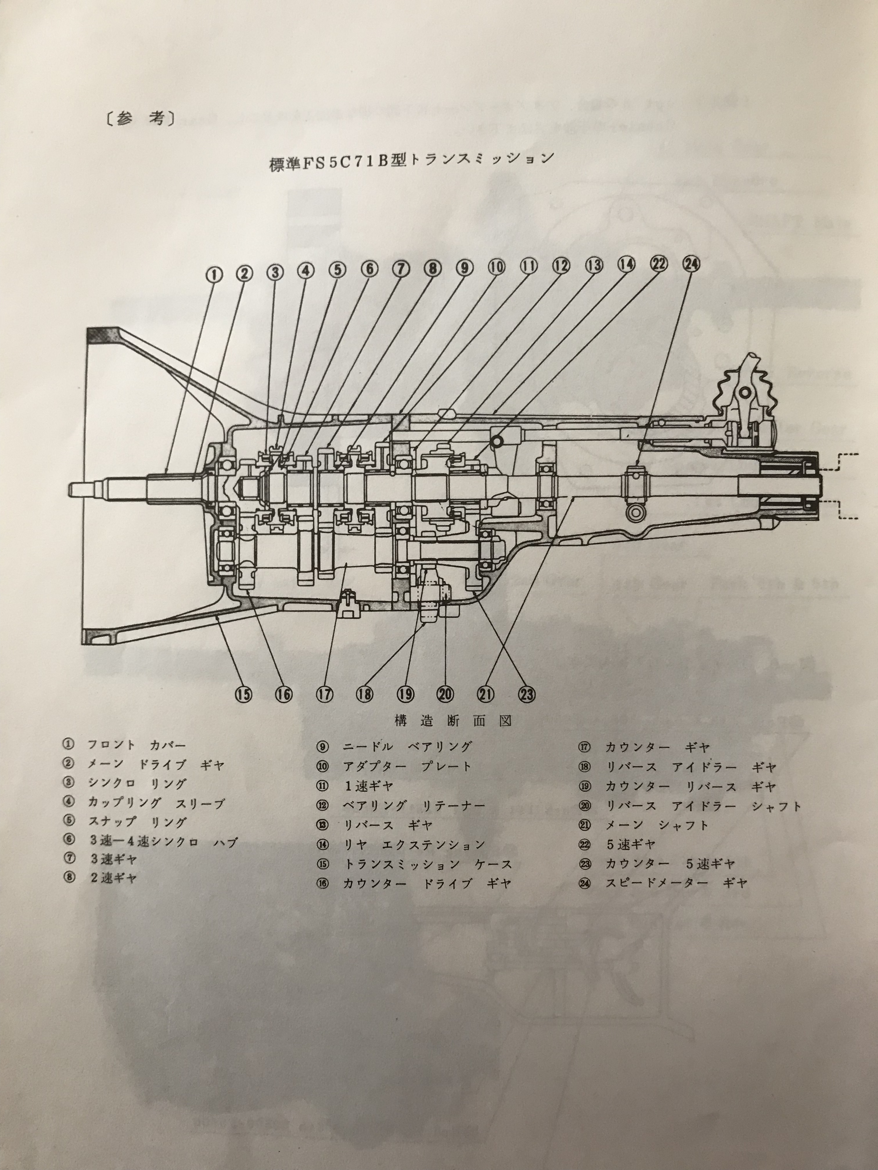

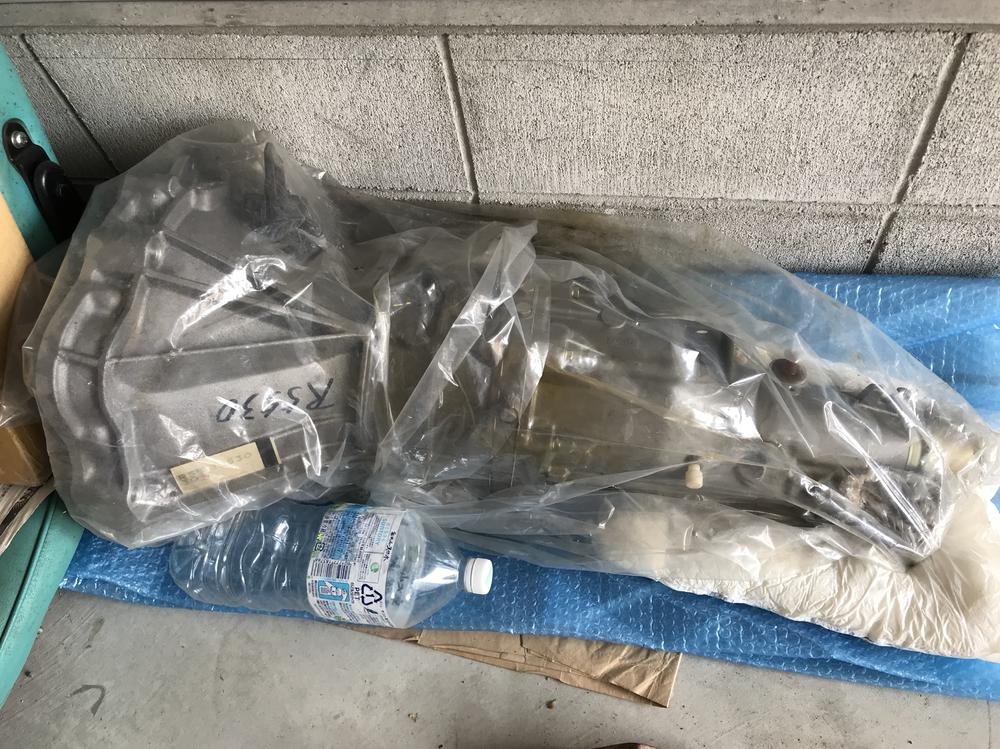

April 23, 20186 yr Author comment_547891 Today I show you a new old stock 5speed gear box “ FS5C71B” which is used for Z432 , Fairlady 240Z series and Skyline GTR . ( this one is specifically derived to Skyline GTR , as a part number 32010-R5530) After Jan 1972, (for example HS30-10635 And after ) FS5C71B was applied, but gear ratio was different from other model. Those three types of cars has very nice ratio. 1st 2.906 (3.321 std) 2nd 1.902 (2.077 std) 3rd 1.308 (same std) 4th 1.000 (same std) 5th 0.864 (same std) Rev 3.382 (same std) I have a question about export Zs which have 5 speed , are they have this special gear box ? I am thinking using this for my 240ZG , I will replace S20 front section to its original L24 one then I will sell the S20 front section (so many S20 owners in Japan want to swap FS5C71A to FS5C71B, because it’s good feeling and plenty of parts availability) Also I need to have a spline type propeller shaft (my ZG has a flange type as an original , soon after they went spline type ) this one will not be difficult to find because so many S30 models used this one since September 1971 (I mean longer one for the diff mount changed) Or should I stick with its original gear box and propeller shaft ? Everything on this car is original down to exhaust tip with its build date stamp. Hmmm.. Alan , please let us know. Kats Edited April 23, 20186 yr by kats Link to comment https://www.classiczcars.com/forums/topic/23900-datsun-240z-vs-fairlady-z432/?&page=83#findComment-547891 Share on other sites More sharing options...
April 23, 20186 yr comment_547895 32 minutes ago, kats said: Today I show you a new old stock 5speed gear box “ FS5C71B” which is used for Z432 , Fairlady 240Z series and Skyline GTR . ( this one is specifically derived to Skyline GTR , as a part number 32010-R5530) After Jan 1972, (for example HS30-10635 And after ) FS5C71B was applied, but gear ratio was different from other model. Those three types of cars has very nice ratio. 1st 2.906 (3.321 std) 2nd 1.902 (2.077 std) 3rd 1.308 (same std) 4th 1.000 (same std) 5th 0.864 (same std) Rev 3.382 (same std) I have a question about export Zs which have 5 speed , are they have this special gear box ? Or should I stick with its original gear box and propeller shaft ? Everything on this car is original down to exhaust tip with its build date stamp. Hmmm.. Hi Kats, I will have to check my factory parts manual for HS30's (UA - Australian Market) to see if they list ratios along with part no.s but in the interim I have some press releases here. https://goo.gl/photos/yGt15kkjKMxXx6Sb8 72 + 73 model years had the following ratios with 71B box. https://photos.app.goo.gl/zB8zJzHE5MTlPffw2 70-71 model years had the following with 71A box. https://photos.app.goo.gl/f6rwh6bxr9LKFumw1 Zoom in to see them. Or I listed below. 73 model - 71B box 1st = 2.906:1 2nd = 1.902:1 3rd = 1.308:1 4th = 1.000:1 5th = 0.864:1 Diff ratio = 3.9:1 Early 240z 71A box 1st = 2.957:1 2nd = 1.858:1 3rd = 1.311:1 4th = 1.000:1 5th = 0.852:1 Diff ratio = 3.9:1 74 260z 2 seater (71B) 1st = 2.905 2nd = 1.902 3rd = 1.308 4th = 1.000 5th = 0.864 Discussion here: http://www.viczcar.com/forum/topic/5575-260z-gearbox-ratios-what-are-they/ I have a 71b/C hybrid box in mine, with the closer ratio 260z 2 seater box gears for the first 4 gears and the taller 5th gear with reverse lockout to prevent shifting into reverse. We used the 71B/C hybrid box because my car is HS30 10552 - which had a 71A 5 speed from factory so the shifter hole is further back and instead of bending the gear stick back to fit, we used this combination so that the shifter would come out in the stock position. Given your cars originality, I'd be inclined to stick with the original box. I wanted to go back to a 71A box in my 72 240z HS30 10552 but I already have 3 other 240z's that will receive this style box. So decided against it for now. Previously I had the 280zx/240K gearbox with the wider gap between 2nd and 3rd gears, synchro's were well worn, so it drives night and day different now. I also fitted Triple 44's at the same time, so it's hard to say which I like better. The new gearbox or the response of Triples. Both have transformed my L28. Link to comment https://www.classiczcars.com/forums/topic/23900-datsun-240z-vs-fairlady-z432/?&page=83#findComment-547895 Share on other sites More sharing options...
