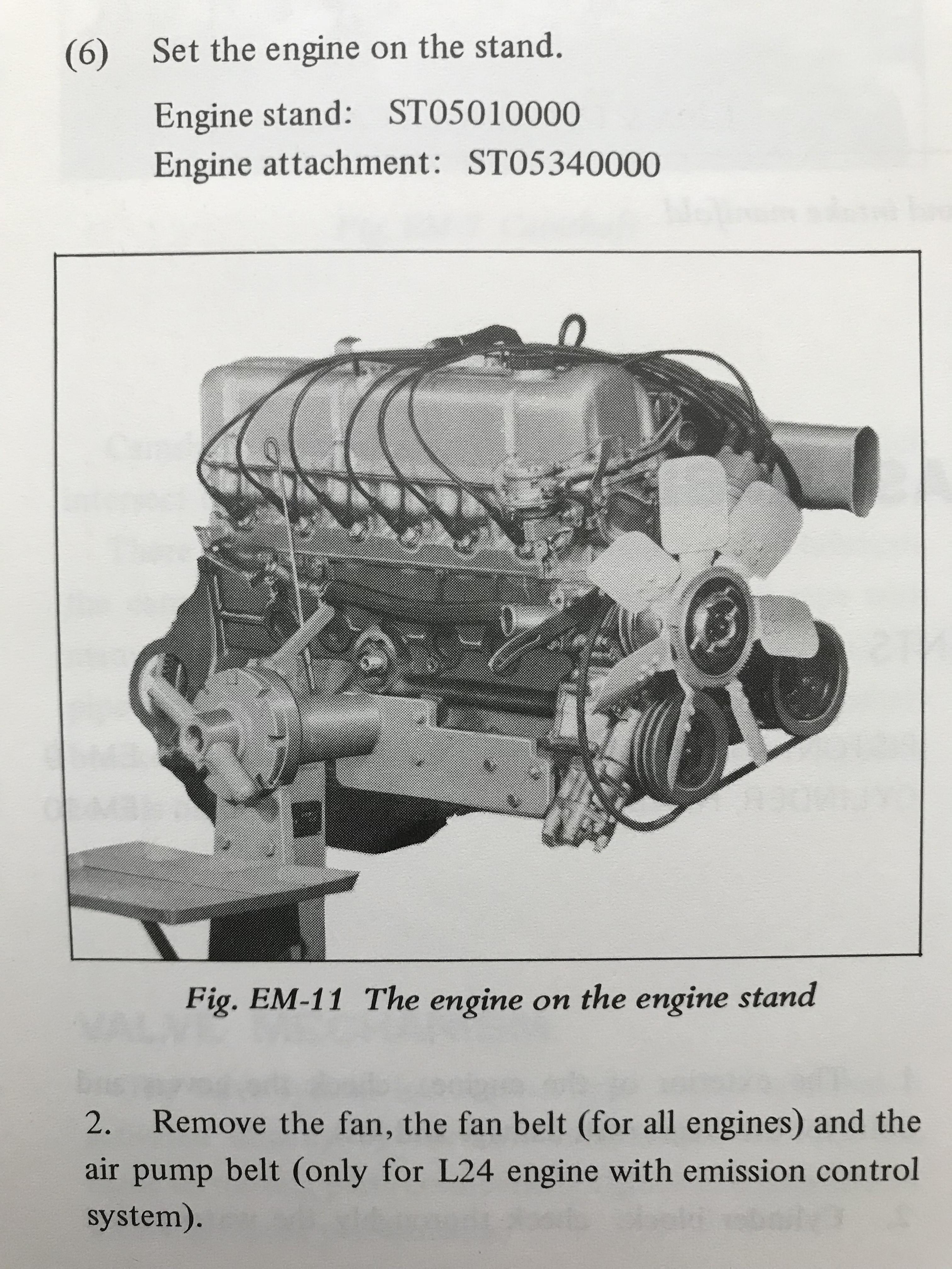

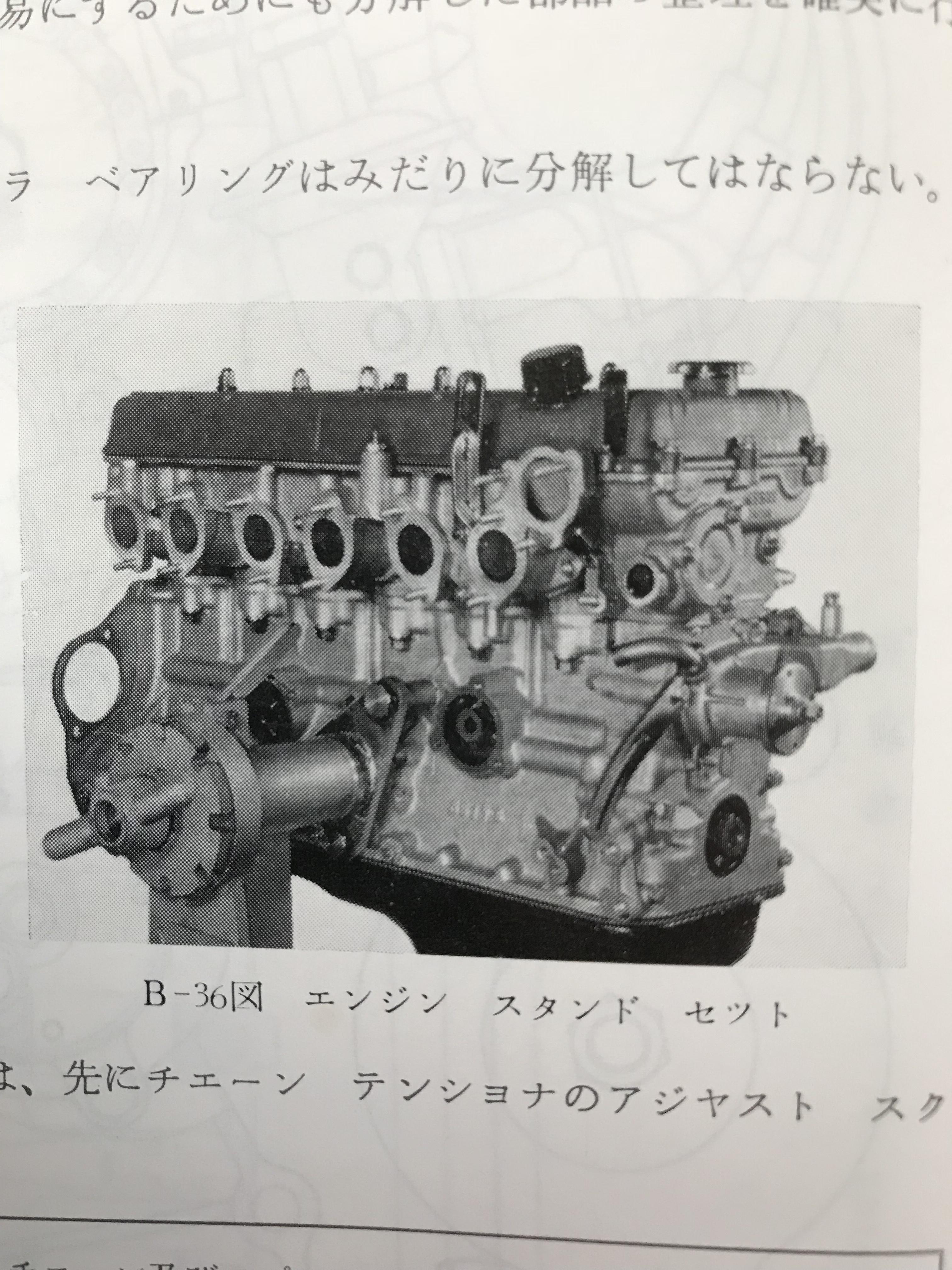

On 5/12/2018 at 1:15 AM, Lumens said:
That side mount engine stand is the way to go.
A friend here has one for L24 26 28 engines.
Hi Lumens, I did not realize that,  I was wondering what the huge threaded hole is for .
I checked service manuals ,  ( 1st NOV 1969 for export , NOV 1969 and OCT 1971 for Fairlady Zs) there is a Nissalco ? stand , the difference is an adapter for each type of engine.
And you will be surprised, Fairlady Z manual is omitting description of disassembly and assembly for L -6 engine , it says “ because it is the same as L16 engine, omitting desB26C3A5F-9BCB-43BF-A917-8641500C11F2.jpegcription “

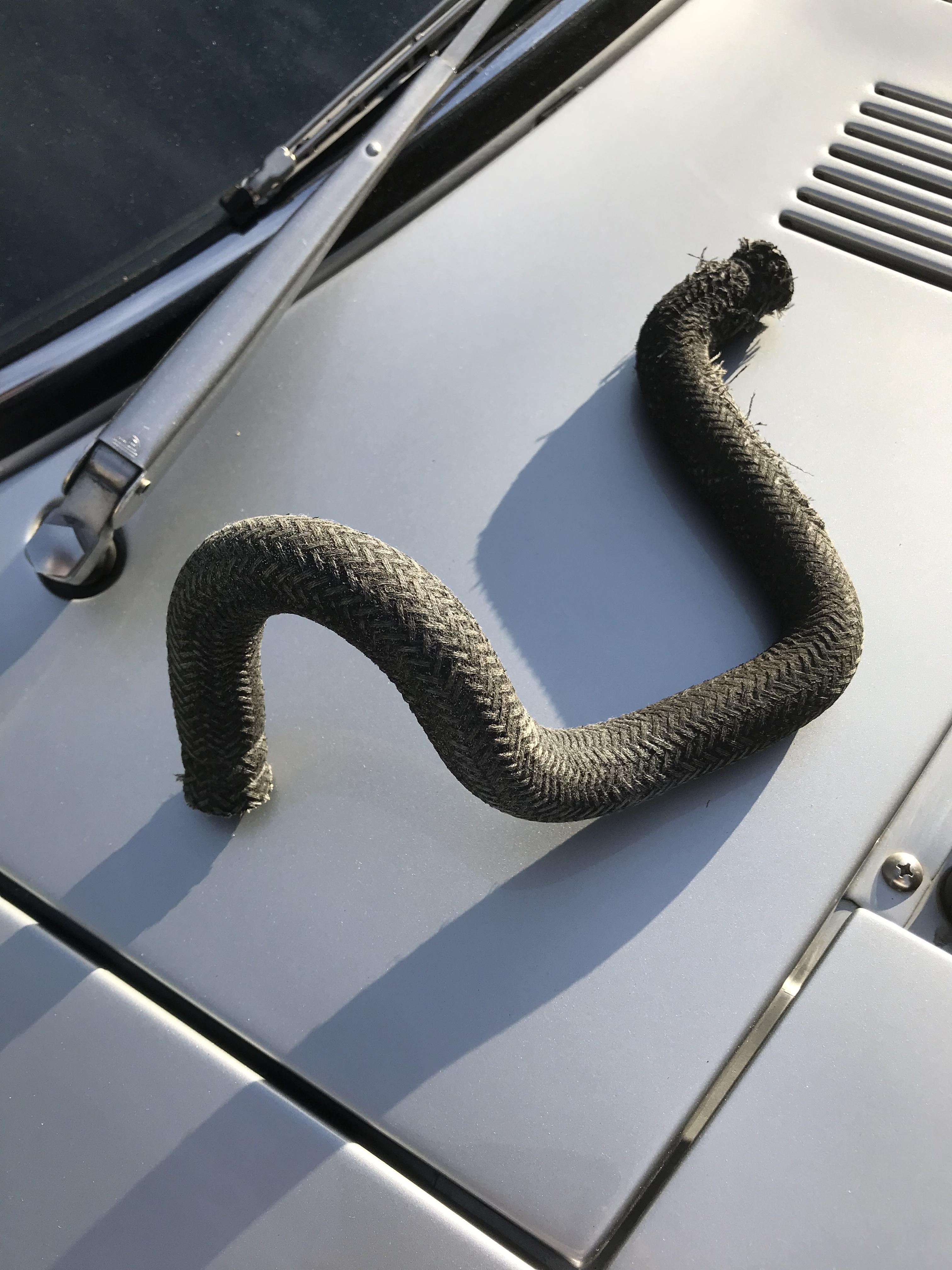

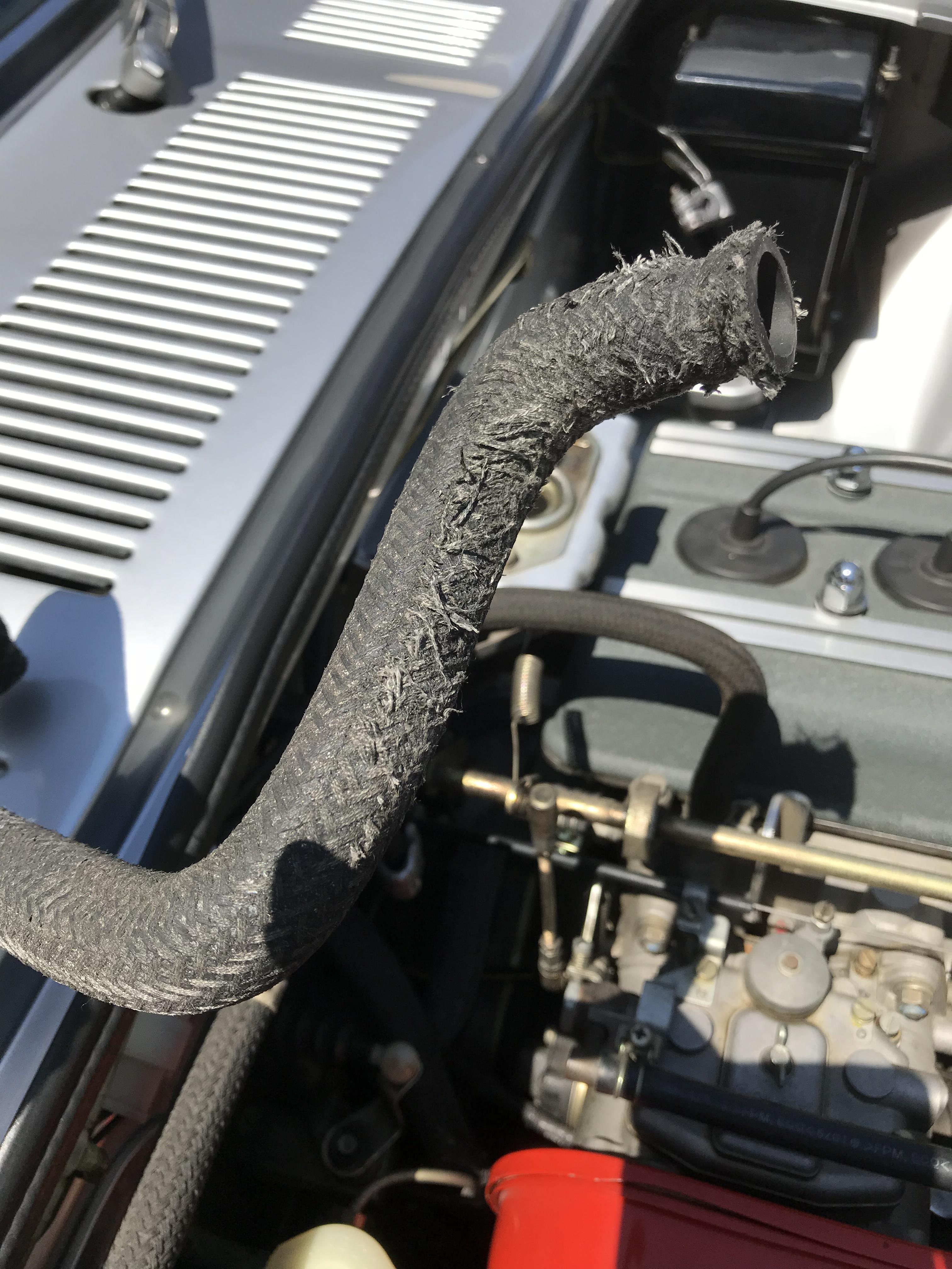

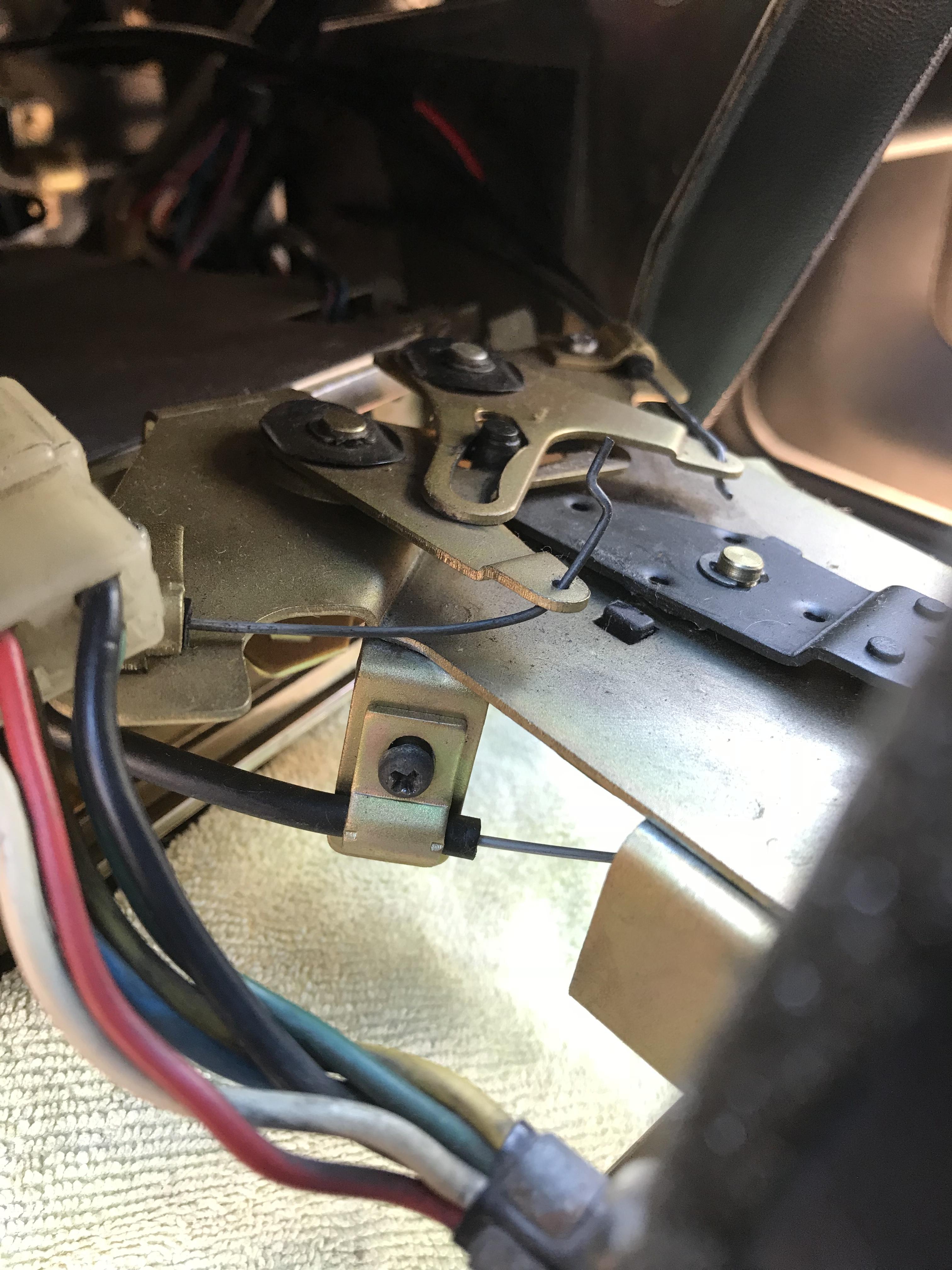

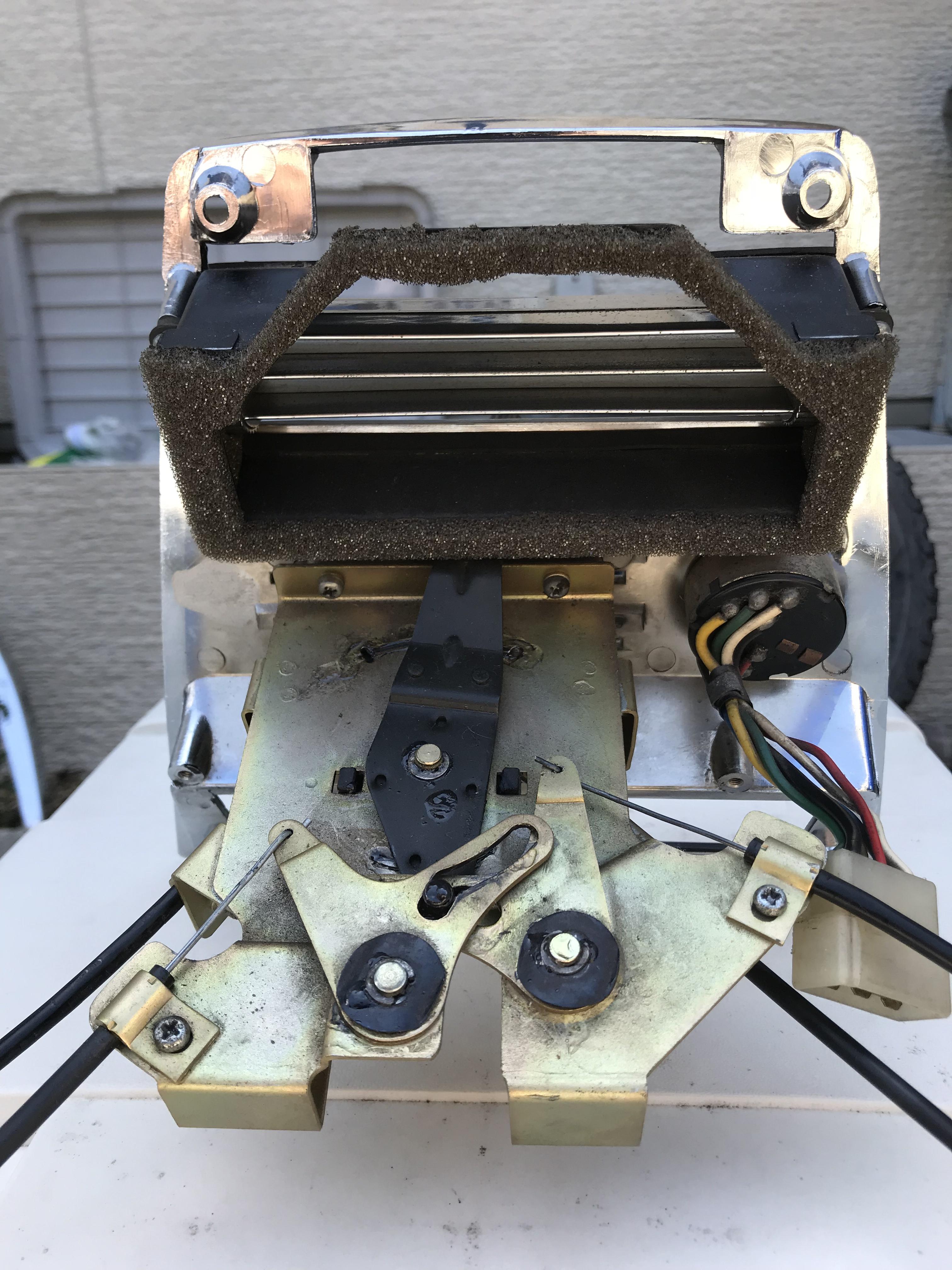

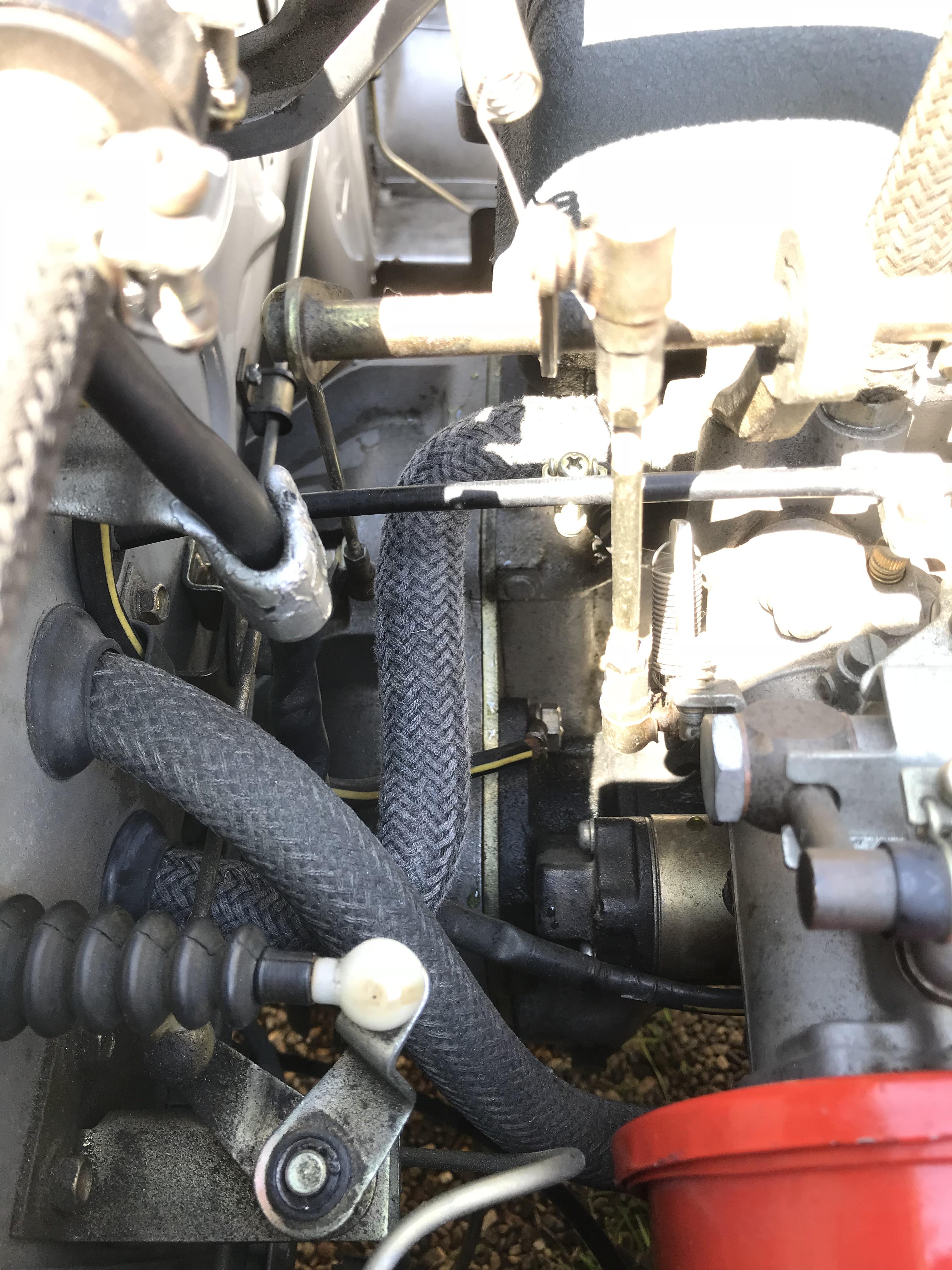

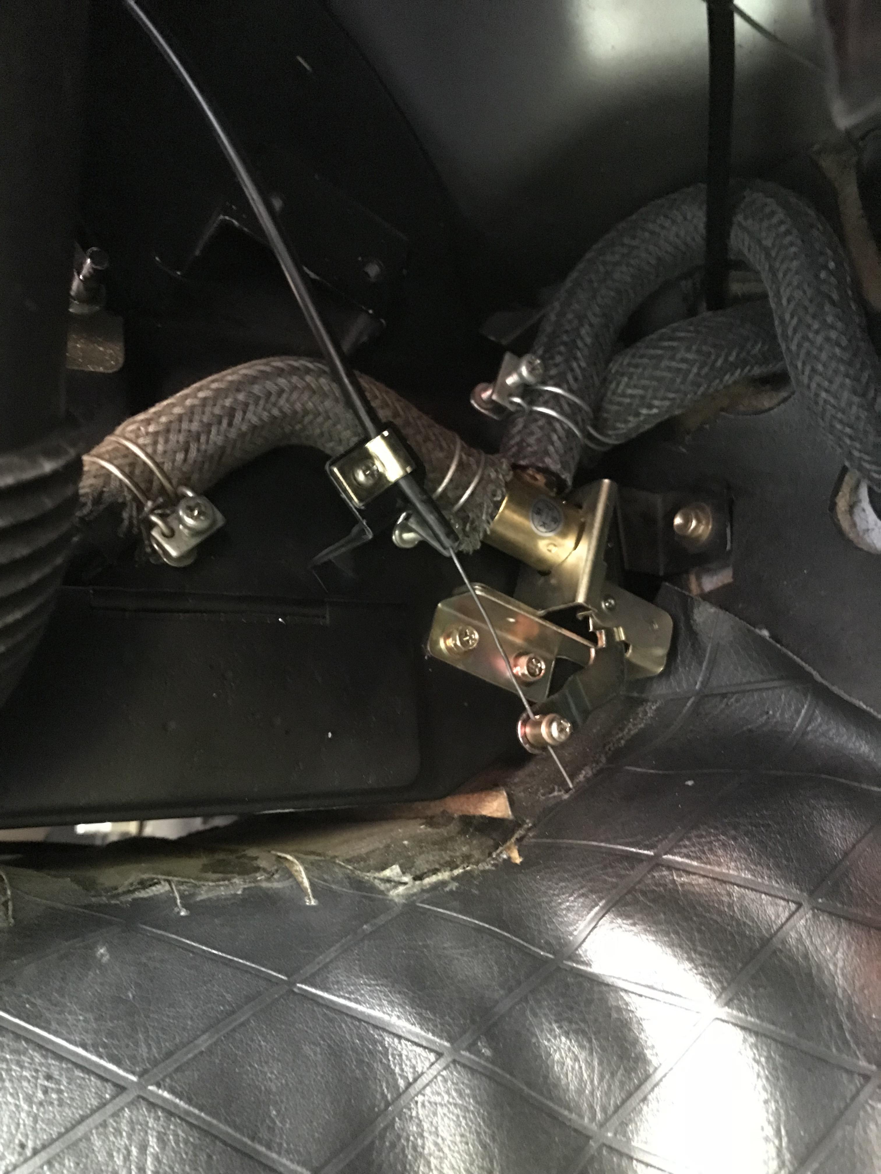

Yesterday I replaced a heater hose of my Z432 , it was deteriorated.
The Inlet hose for heater is much more stressful than outlet hose, especially S20 engine creates high RPM , and circulation of water is very good , it means water runs very fast.

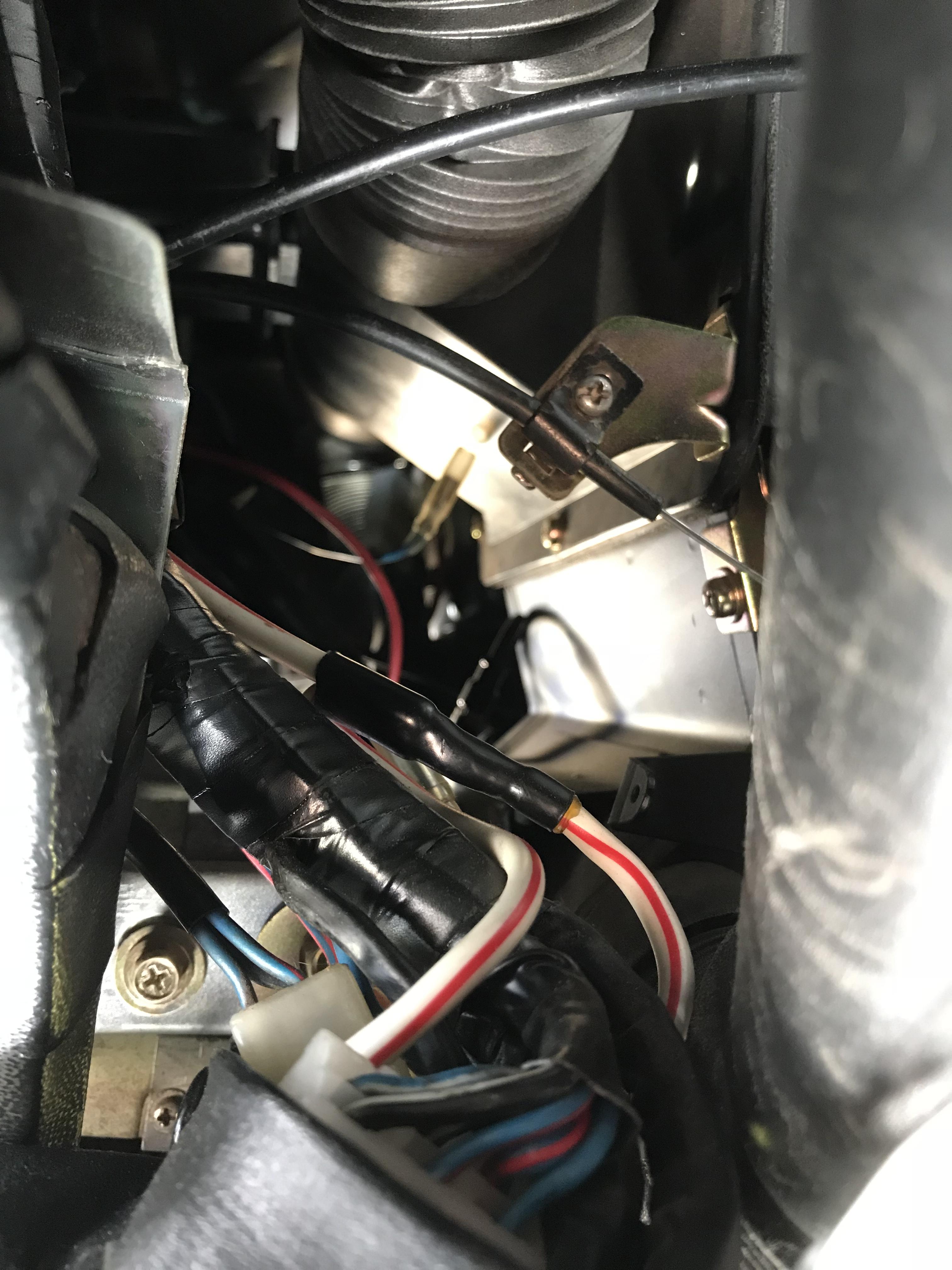

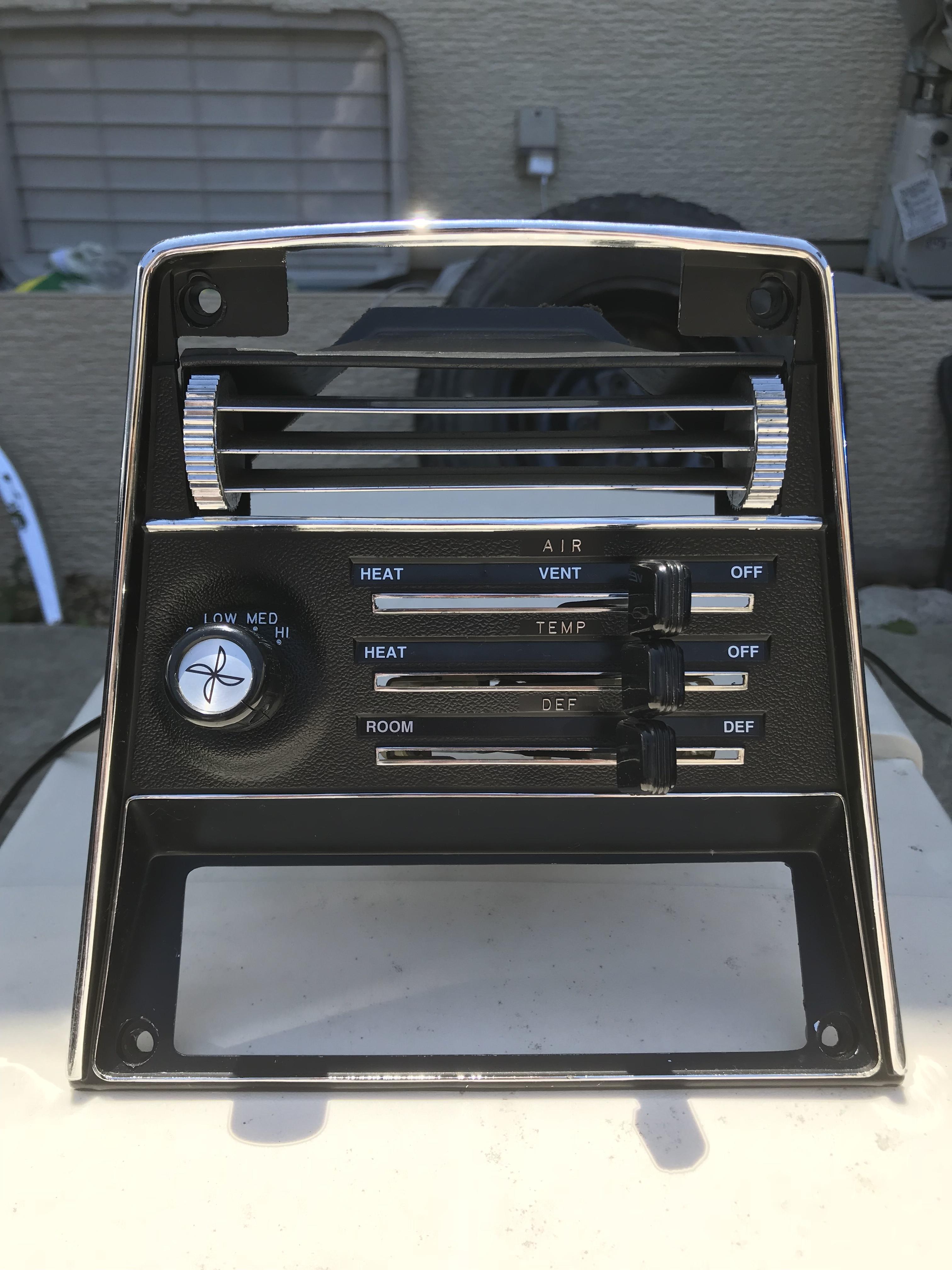

And During the operation I broke a heater control mechanism. I had to disassemble the heater control facia , I added my work road by myself!
I was so glad that the control mechanism trouble was only a steel wire , it was going wrong as it pushed so hard that the wire’s 90 degrees corner could not stop hold the lever.
I fixed the wire , and pulled all the wires from their plastic tubes to lubricate . And I put a drop of oil on the every pivot and contact of the mechanism.
Now levers move nicely, no effort for selecting positions. I was lucky I did this maintenance before breaking the mechanism and plastic control facia .

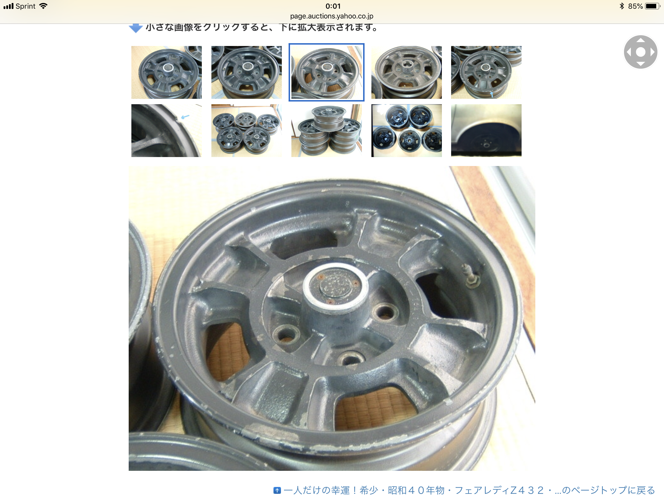

Hi ,
I saw this auction in Yahoo Japan , but it was too late . Just after an hour of starting , it was sold out with buy it now .
https://page.auctions.yahoo.co.jp/jp/auction/t572315354
5 wheels with caps and even they still remaining original air valves .
1 000 000 JPY , last time similar a set of 5 wheels was sold for 1 500 000 JPY.
