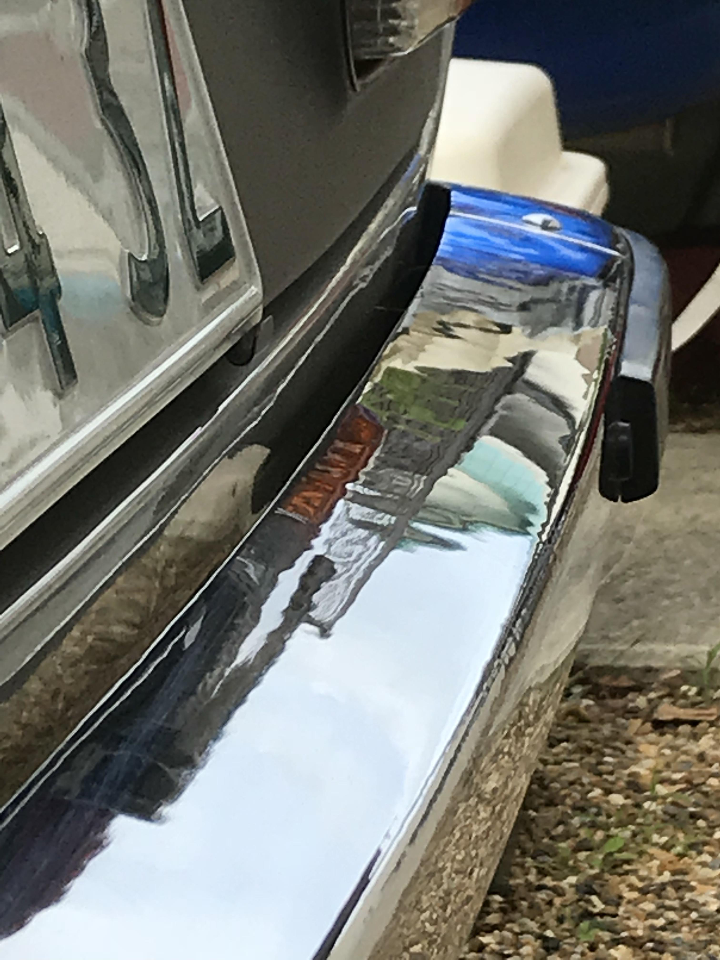

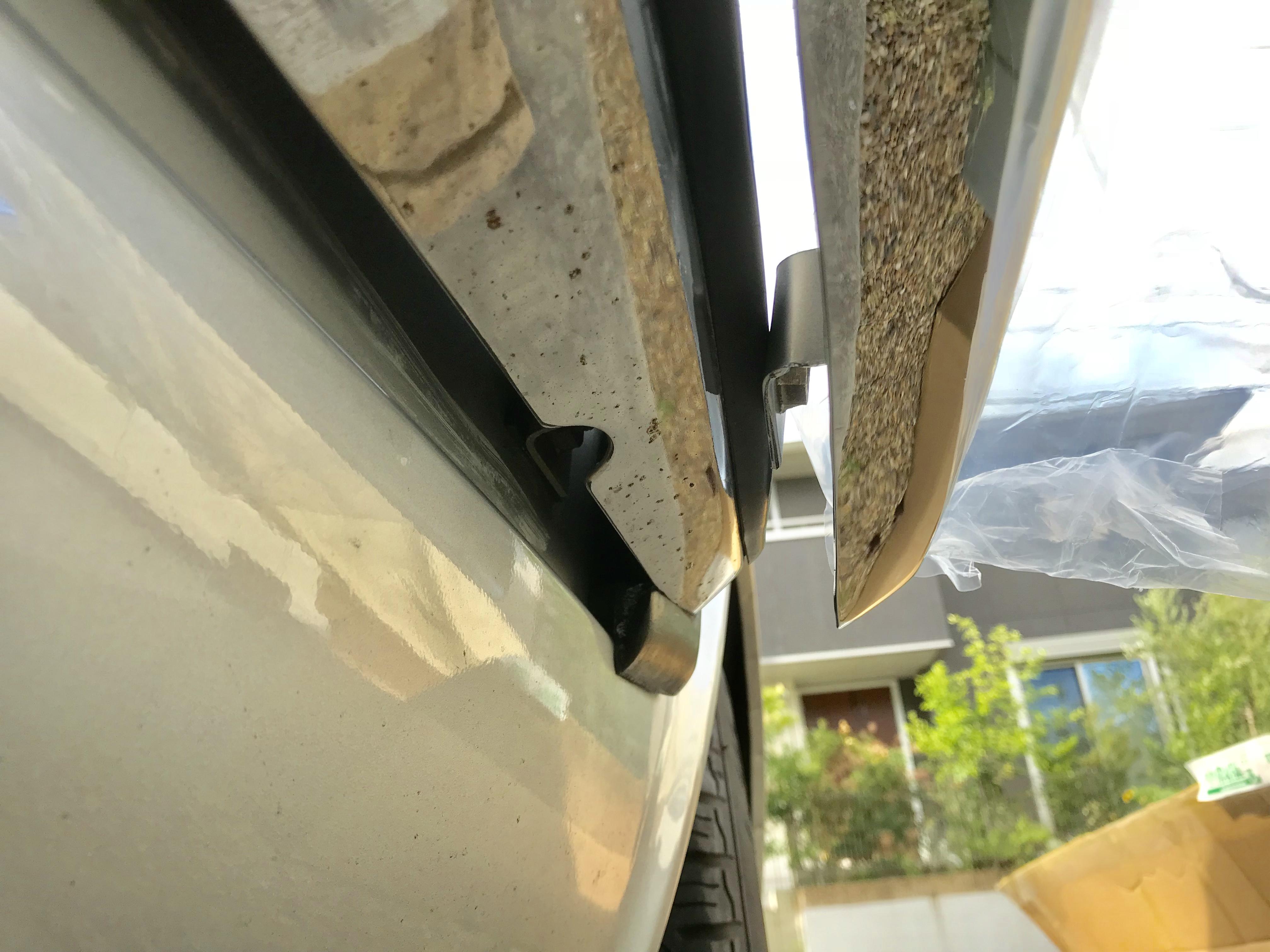

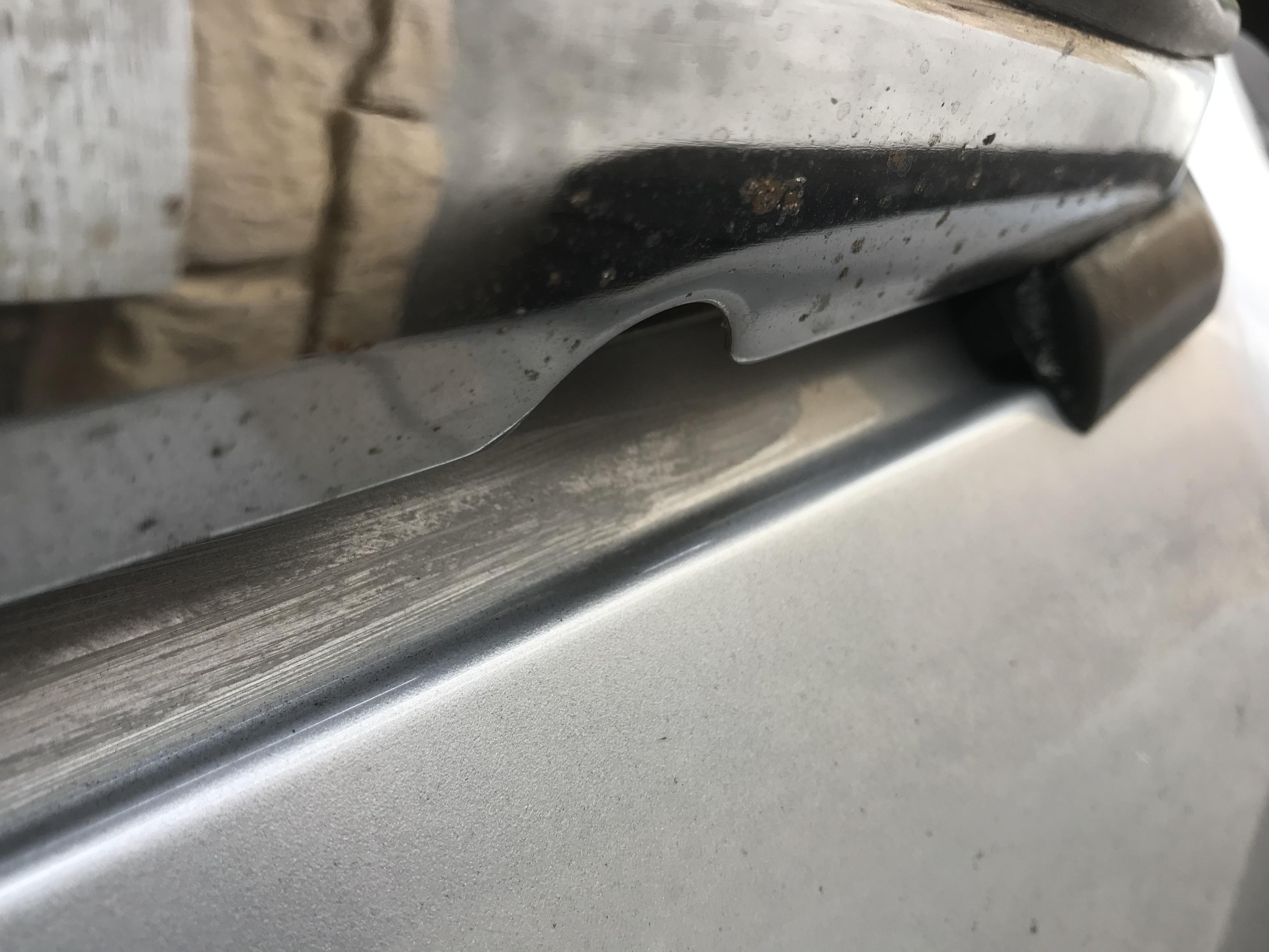

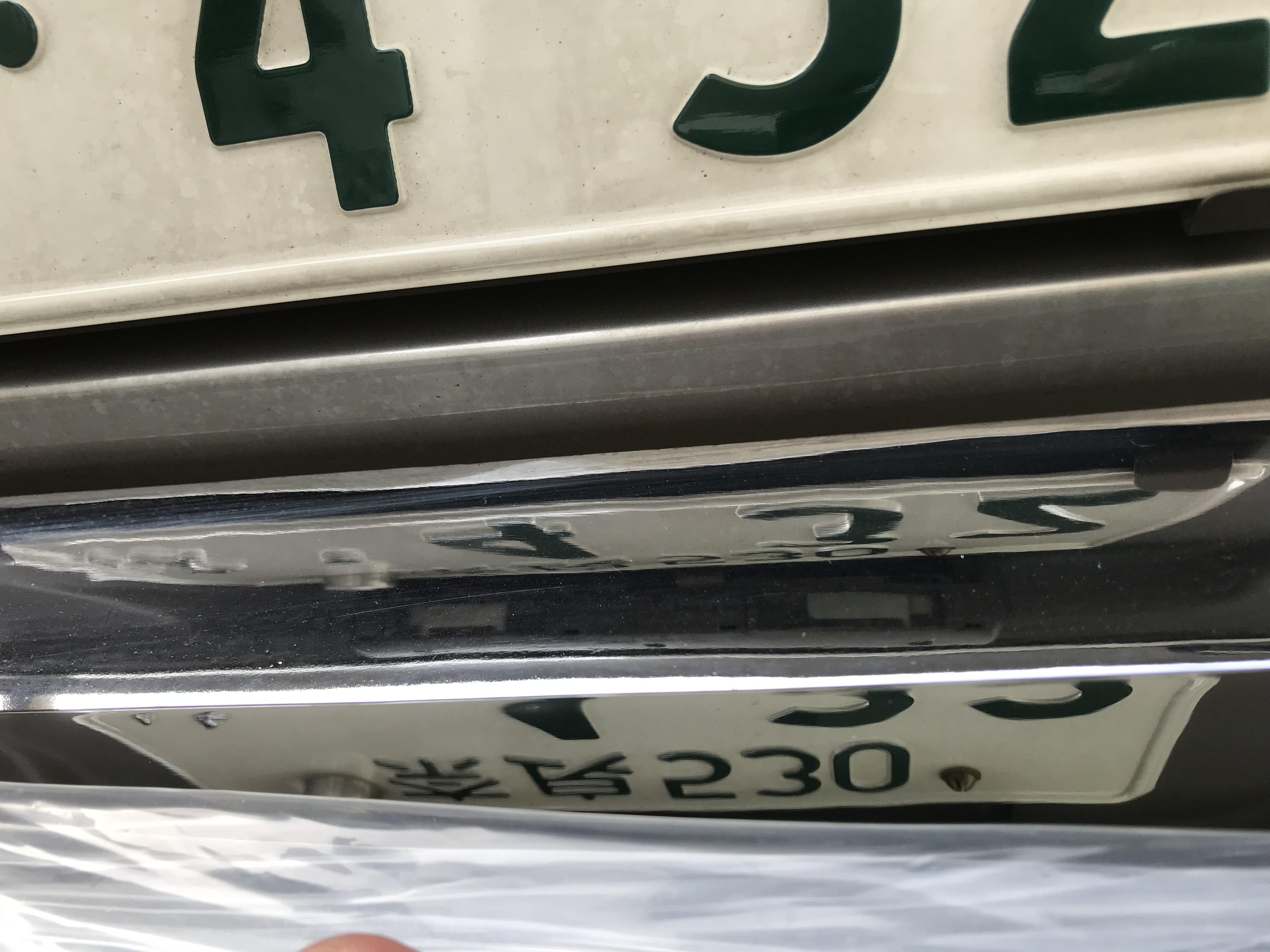

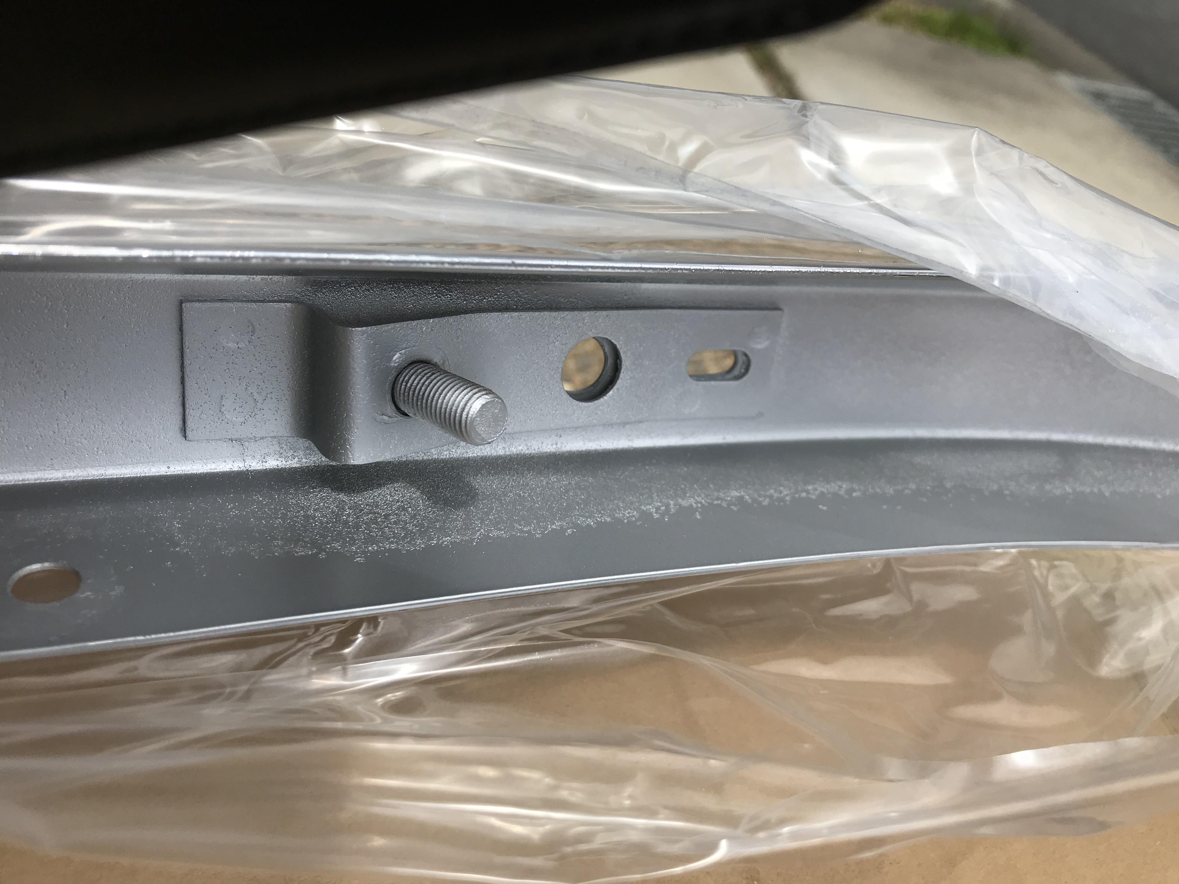

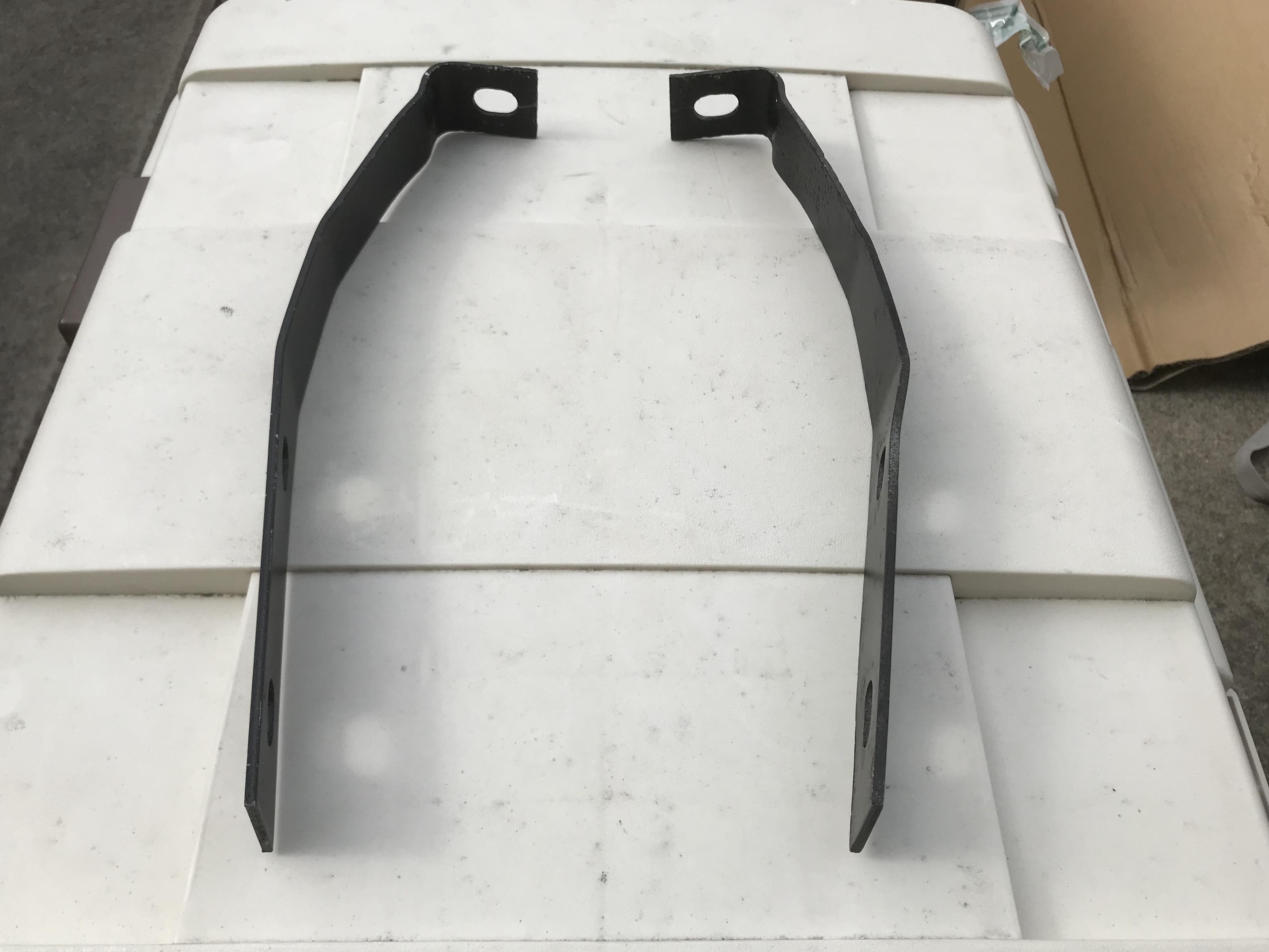

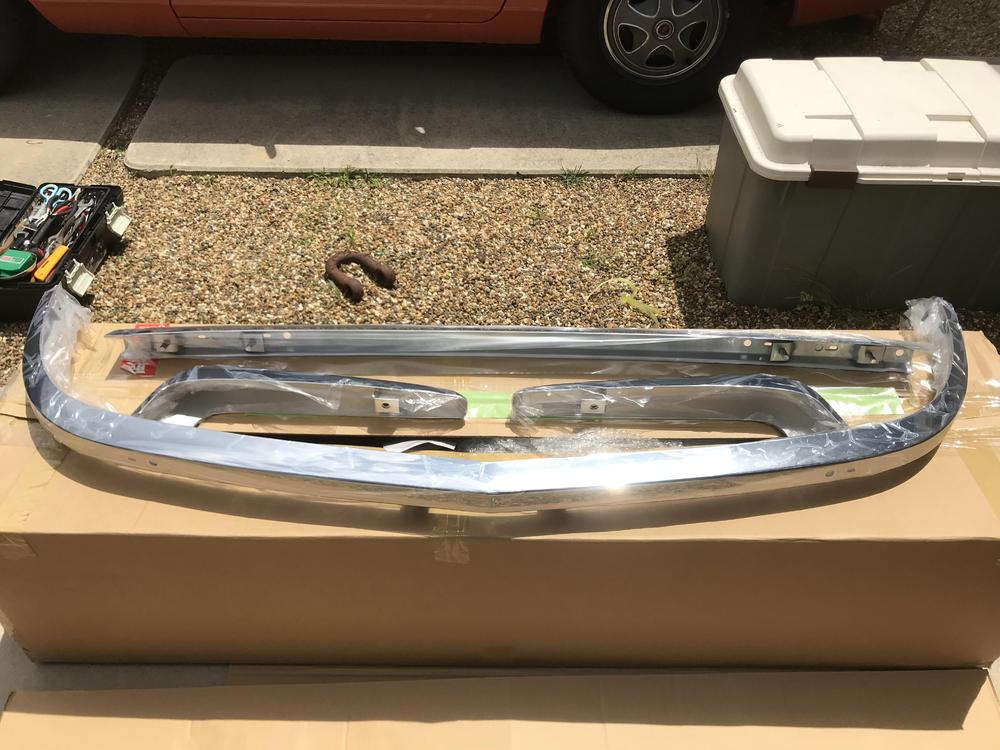

July 4, 20186 yr Author comment_552372 Hi everyone, today I show this , early bumpers. The earliest bumpers are unique, for example, the front bumper has only one stud bolt per each side. And the associated brackets are very thin . These are the same for all the early S30 series cars. But I do not know when it bacame to two bolts per side. Once I was told by a 1970 Z432 -R owner , he told me that he thought his car has very thin bumper brackets because of his car is Z432-R . And the rear bumper, it does not have a recess near the side mount bracket for each side. This is true for at least up to 1973 model , including Fairlady 240ZG which has gun grey painted bumper. Some of you noticed already, my Z432 has later ones. They are genuine stock bumpers from Nissan , but they all were purchased around 2005-2007 . We all were happy that Nissan still providing these old parts , but we were little bit unhappy about its quality about chrome. The finsh of surface was not so good . You can tell from the pictures , about front and rear bumper’s imperfection. The original old bumpers has much better chrome I think . Today I show my re-chromed early bumpers , one bolt version on a front and non recess version on a back . Safari Motors ( remember ? They are taking care of Nissan’s historic racing cars ) did a wonderful job for it , but expensive!! Kats Edited July 4, 20186 yr by kats Link to comment https://www.classiczcars.com/forums/topic/23900-datsun-240z-vs-fairlady-z432/?&page=90#findComment-552372 Share on other sites More sharing options...

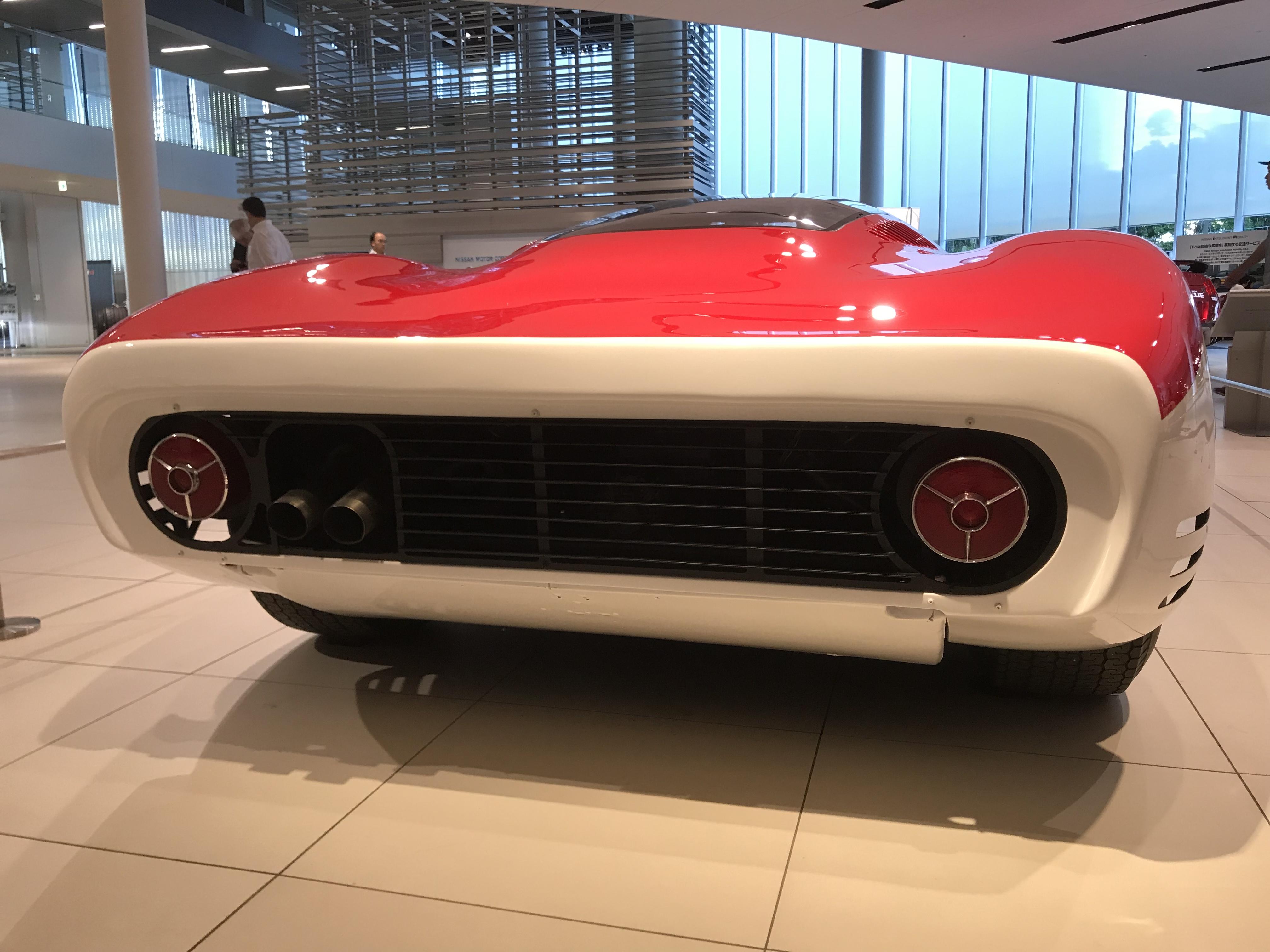

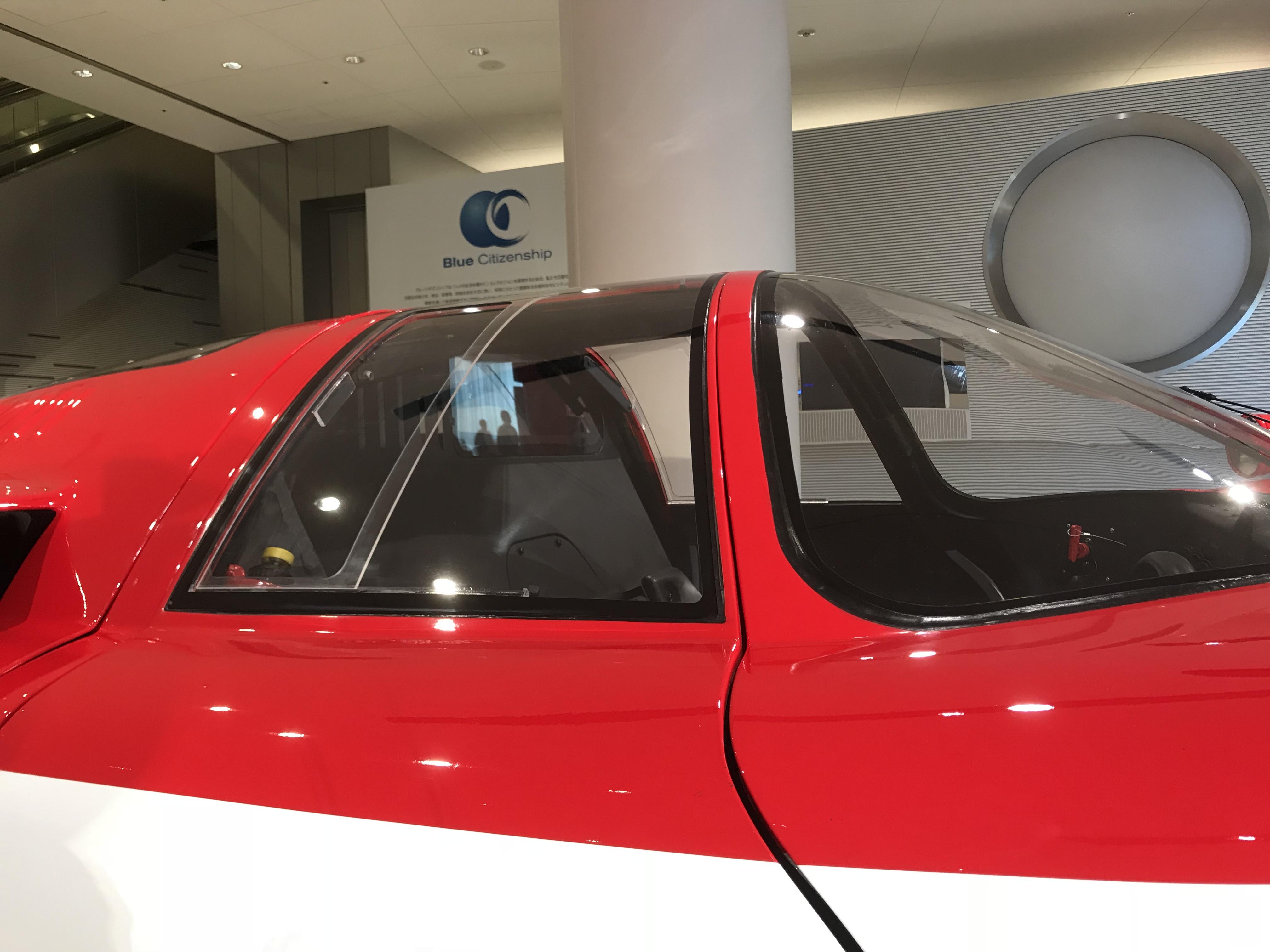

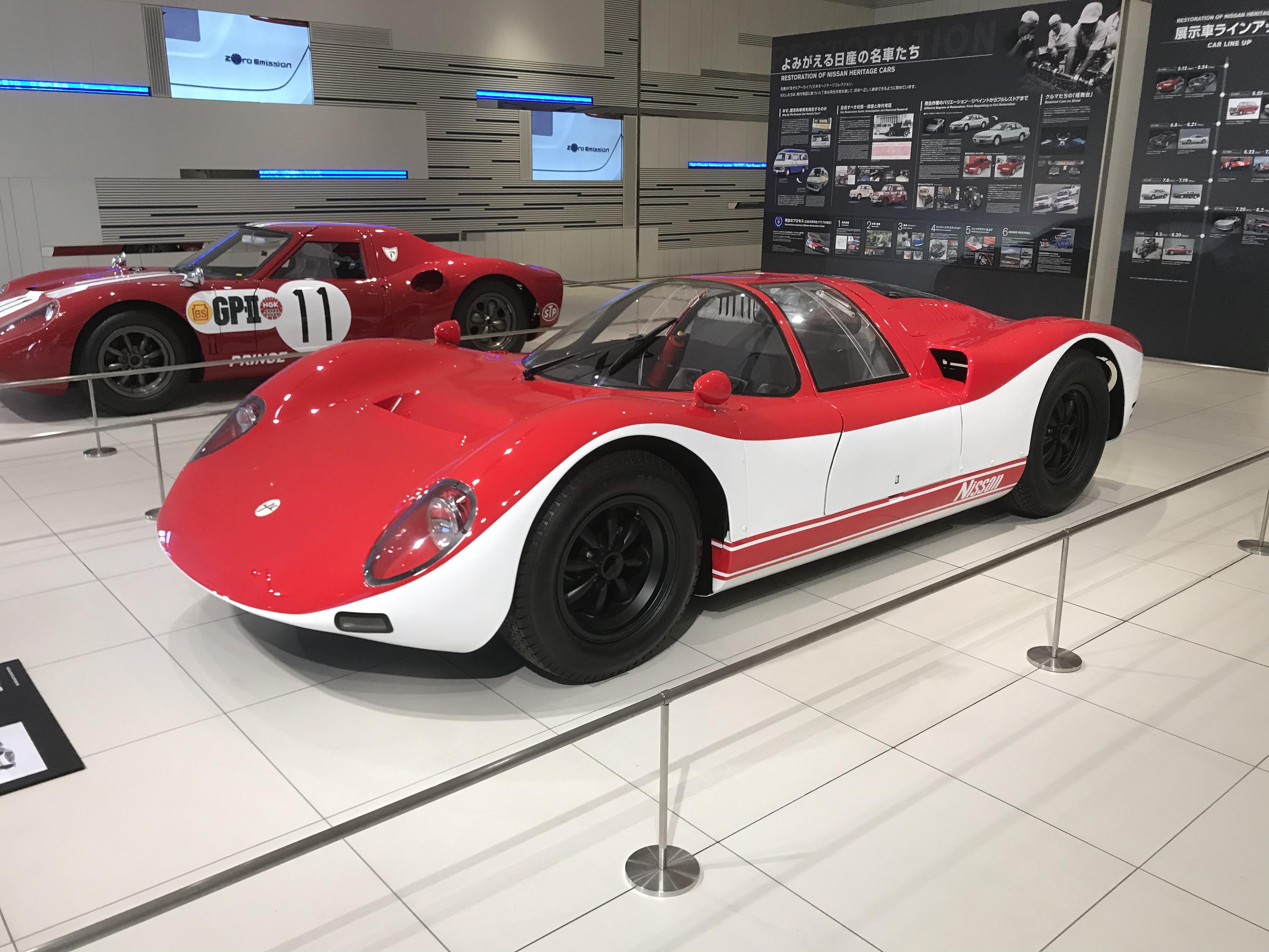

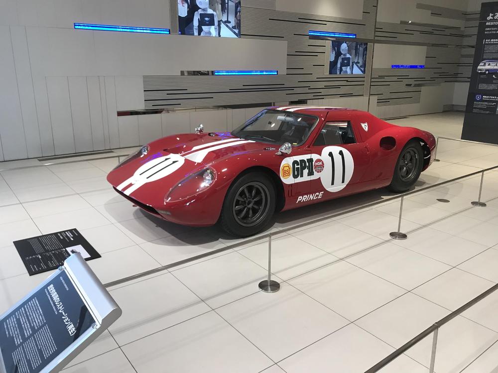

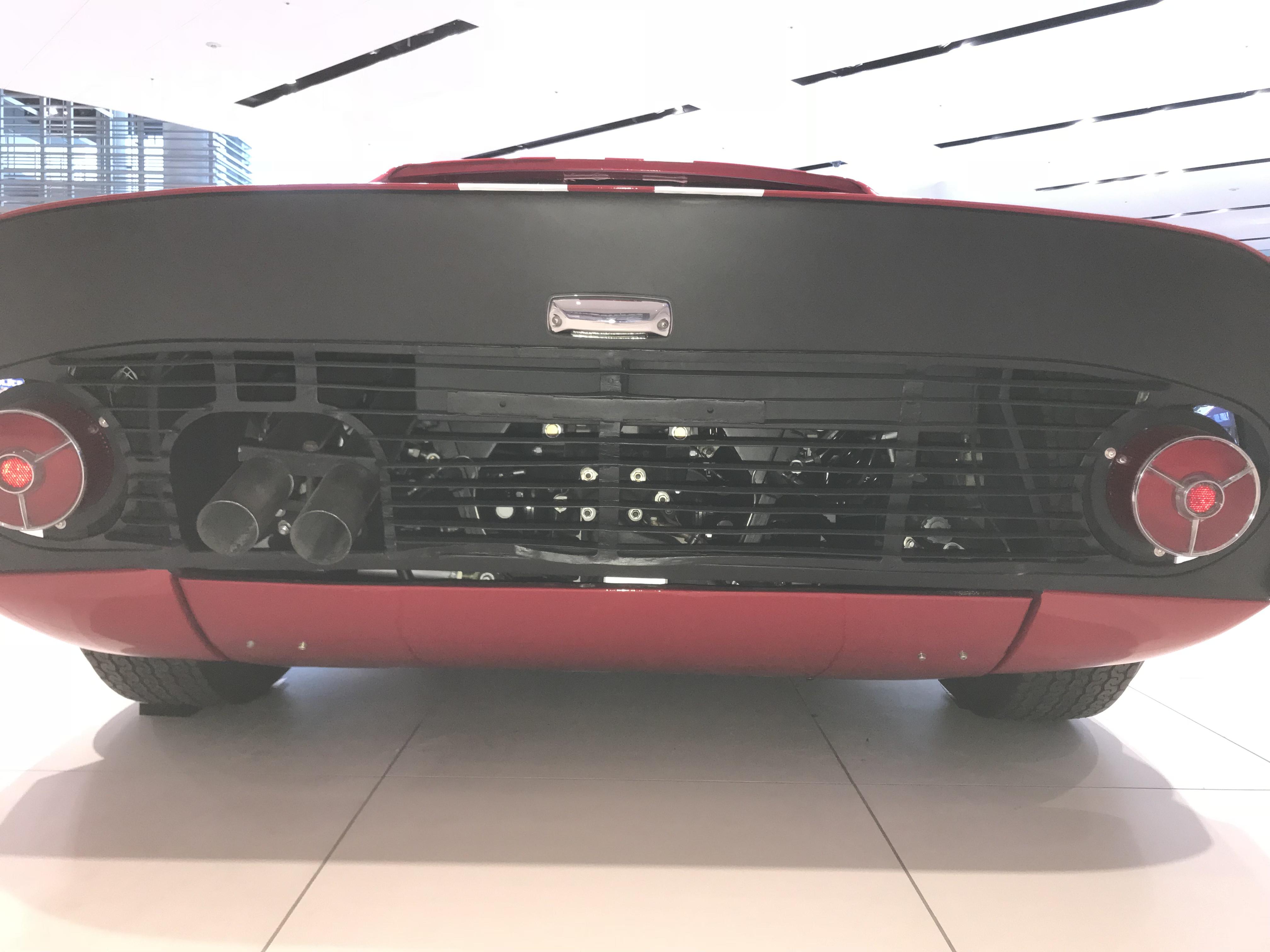

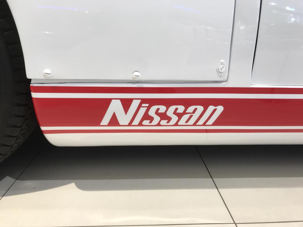

July 4, 20186 yr Author comment_552373 Prince and Nissan R380s at Nissan Yokohama HQ gallery . They are restored recently, Safari motors is supporting this activity. Kats Edited July 4, 20186 yr by kats Link to comment https://www.classiczcars.com/forums/topic/23900-datsun-240z-vs-fairlady-z432/?&page=90#findComment-552373 Share on other sites More sharing options...

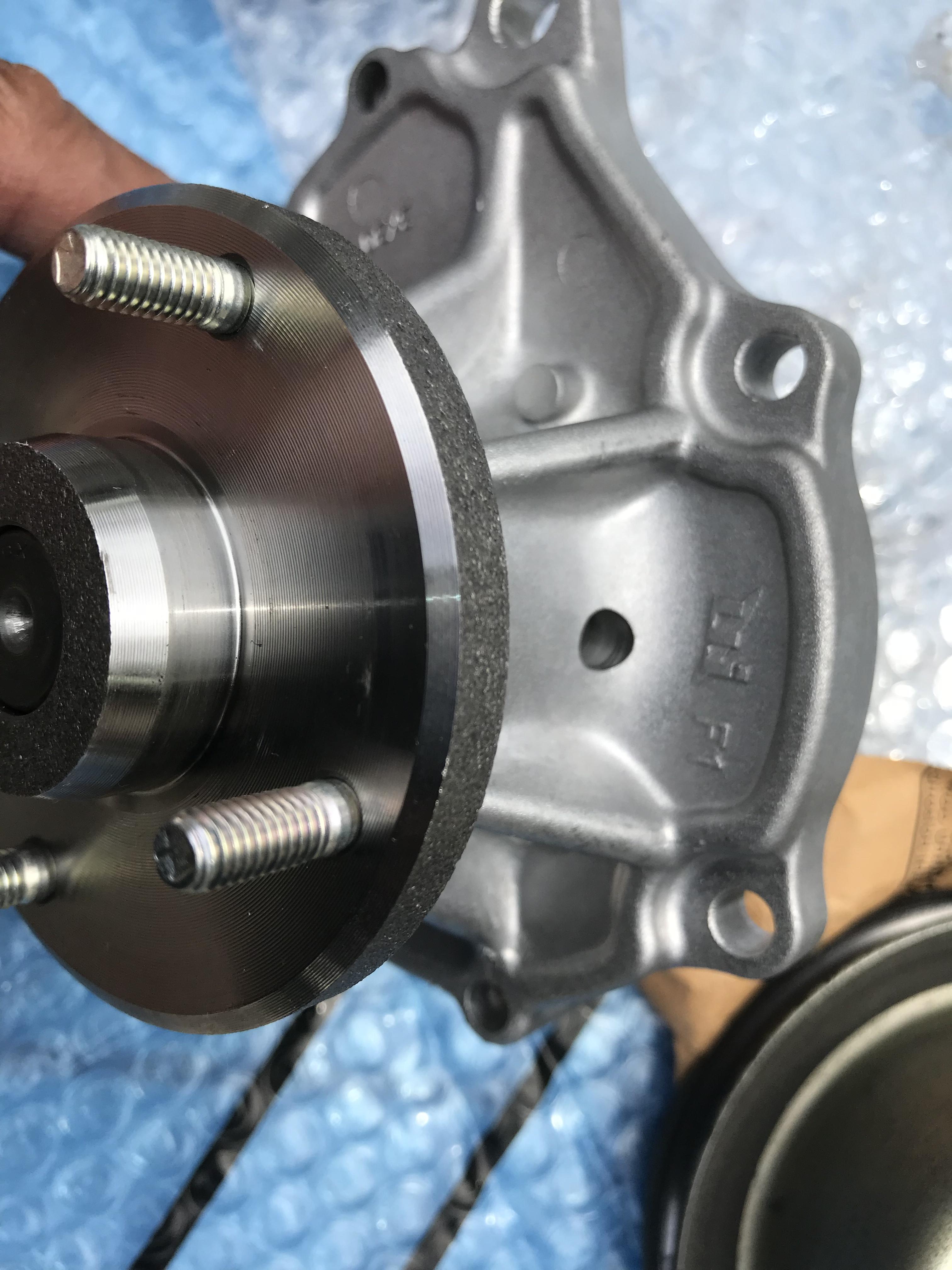

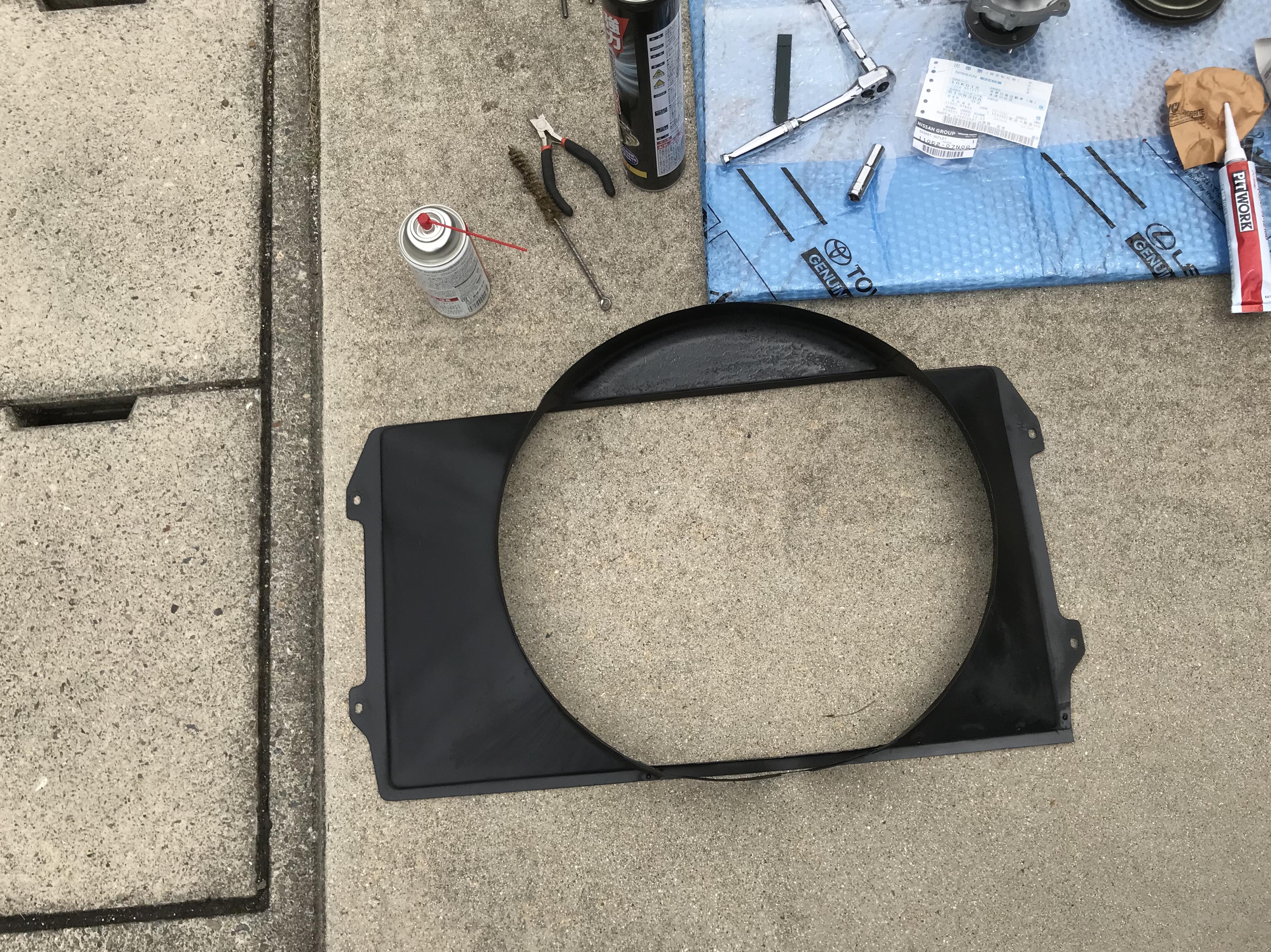

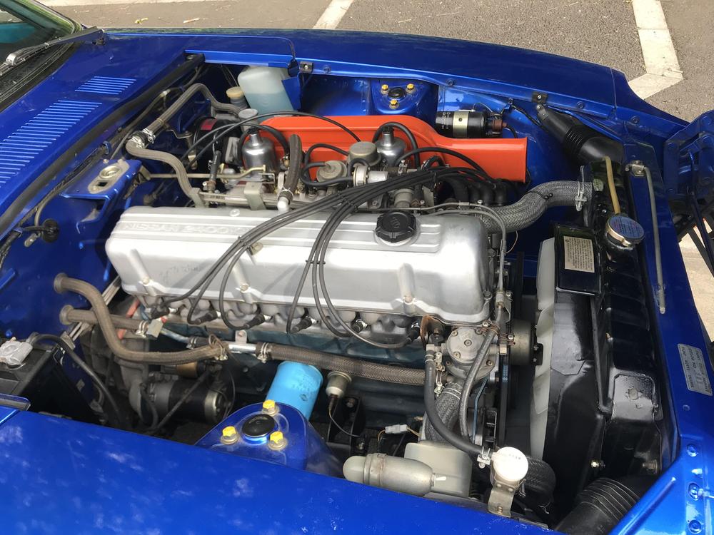

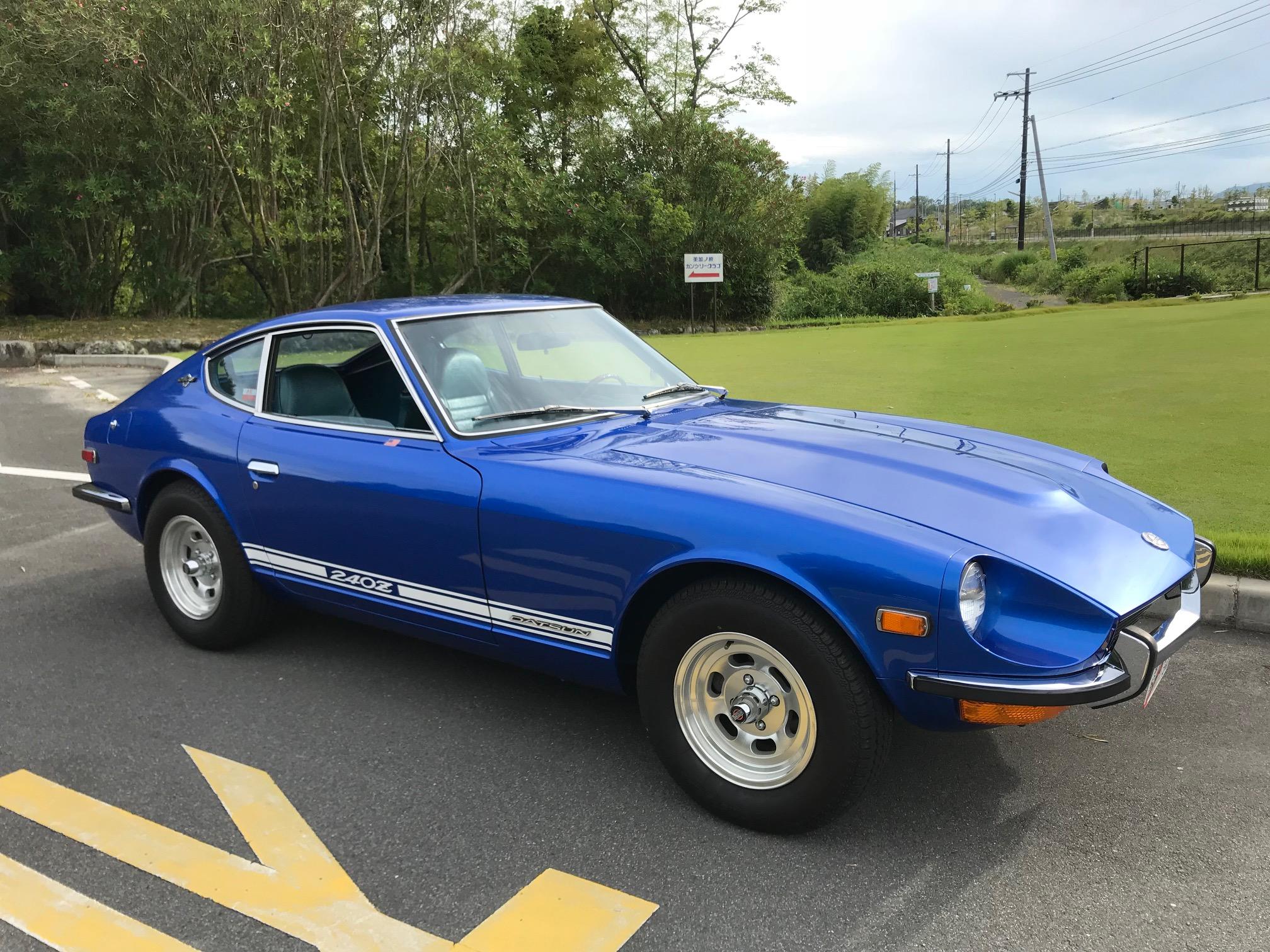

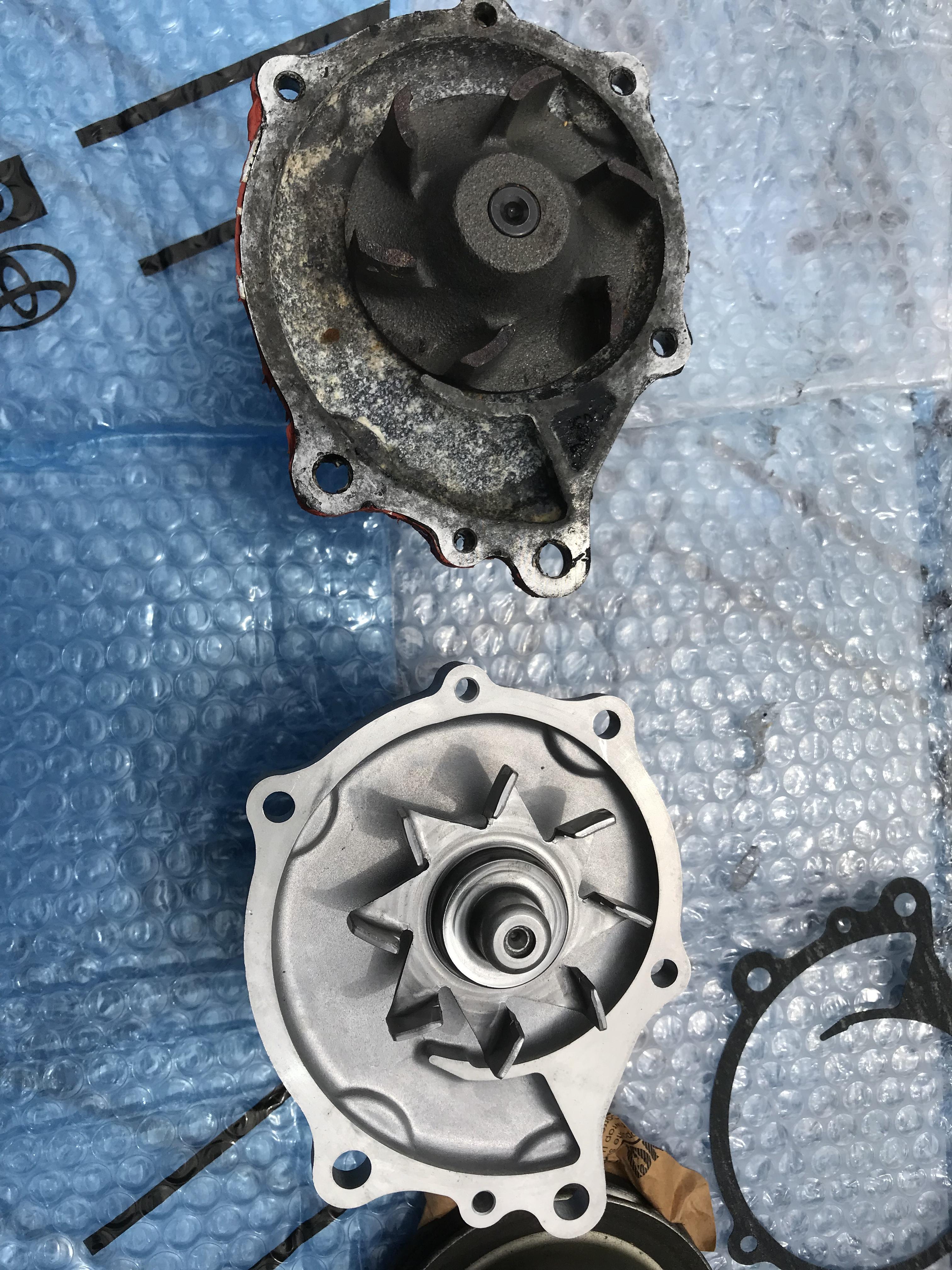

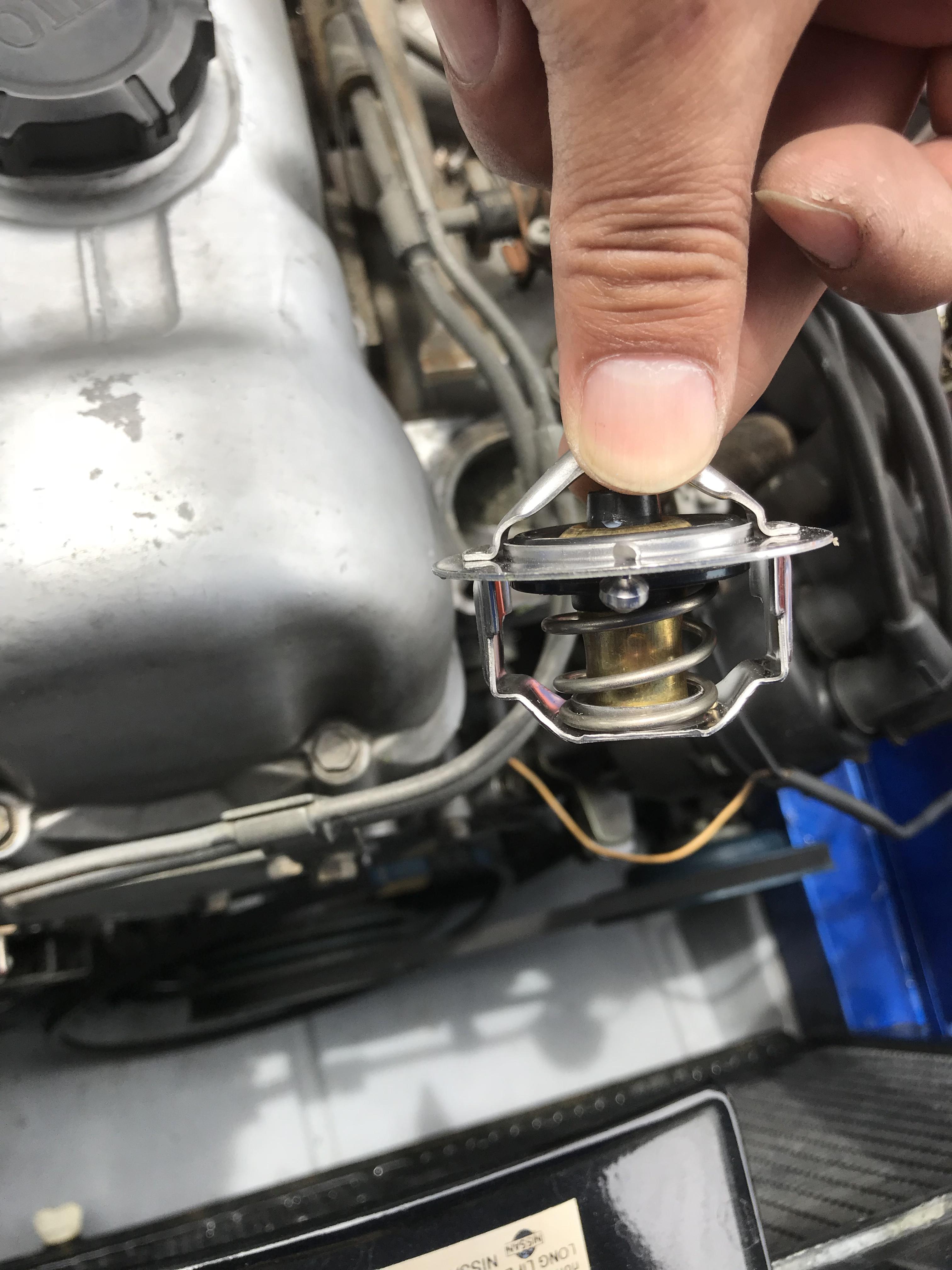

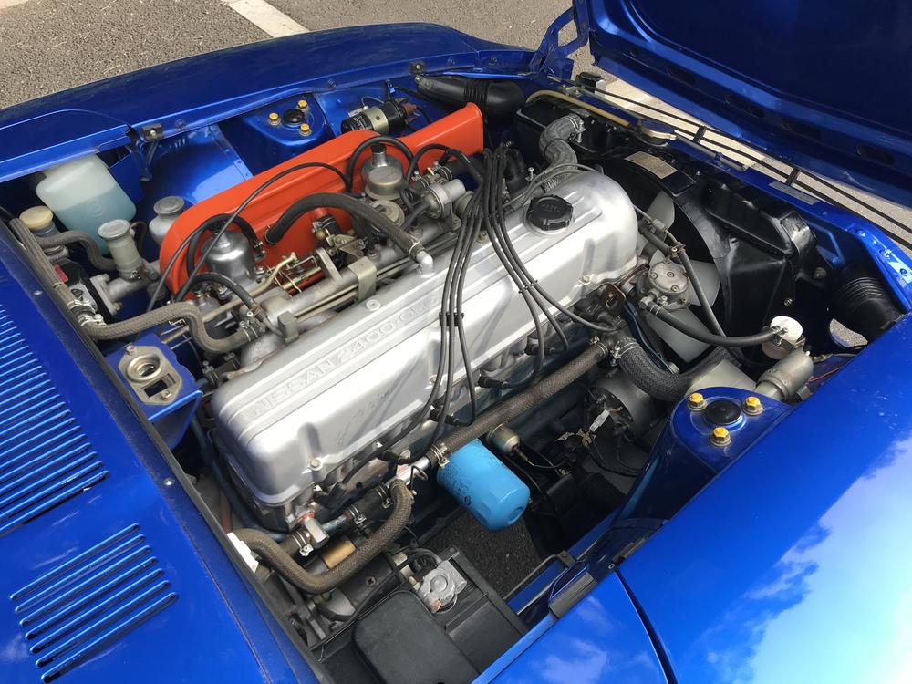

July 4, 20186 yr Author comment_552380 Update of my blue 240Z , I replaced an water pump, it went bad after a few months I reported here last time when I installed the metal fan . Anyway this previous pump was old enough to be going wrong. Also a thermostat, a radiator cap , and installed a fan shroud . Kats Edited July 4, 20186 yr by kats Link to comment https://www.classiczcars.com/forums/topic/23900-datsun-240z-vs-fairlady-z432/?&page=90#findComment-552380 Share on other sites More sharing options...
July 13, 20186 yr comment_552966 Hi Kats, I noticed that you still have a mechanical fuel pump and stock fan. Maybe it never gets very hot where you are so you must not have trouble with vapor locking problems. Here in central Texas I must use a flex fan (very LOUD) and electric fuel pump only and I still get a jumpy ride after sitting at traffic light for a while. don Link to comment https://www.classiczcars.com/forums/topic/23900-datsun-240z-vs-fairlady-z432/?&page=90#findComment-552966 Share on other sites More sharing options...
July 13, 20186 yr Author comment_552977 Hi Don , thank you for the joining here , Yes I still use the mechanical fuel pump and the cooling fan , I do not want to change those things because I love Stock . I have had a trouble once or twice about fuel during my ownership since 2000 , that was overflowing from the SU carb fuel chambers . I opened the chambers and checked the fuel floats, they seemed twisted sideways and sticking to the wall , then fuel valves were stuck open. If I drive my Z in a traffic jam under such a hot day , I will have the same trouble again . Oh , when I brought my 240Z for Las Vegas ZCON 2000, I had a vapor locking . I parked my car under the strong sunshine , after returning from the drugstore , the engine hesitated to fire up . I tried to start several times , then finally I made it . Nowadays Japan’s summer is extremely hot , tomorrow will be 37 degrees Celsius (98.6 Fahrenheit) , when I was a kid , max was like 30 C ( 86 F ) . We can see this in the first service manuals ( Nov 1969 ) , a section Engine shows SU fuel mixture diagram. The diagram has a scale only up to 30 C or so . This is my biggest question, people in hot area like you Don , did they have a vapor lock trouble back in 1970s ? Was it not hot that high back in those days ? Kats Link to comment https://www.classiczcars.com/forums/topic/23900-datsun-240z-vs-fairlady-z432/?&page=90#findComment-552977 Share on other sites More sharing options...
July 13, 20186 yr Author comment_552978 The Fairlady Z manual says , Z432 has a fuel pump ( electrical ) which is located under the floor near the diff . This prevents vapor locking . The reason why Z432 does not have a fuel return system is , no need to concern vapor locking . I did not know that , is this true ? Kats Edited July 14, 20186 yr by kats Link to comment https://www.classiczcars.com/forums/topic/23900-datsun-240z-vs-fairlady-z432/?&page=90#findComment-552978 Share on other sites More sharing options...

July 13, 20186 yr comment_552987 Your fan should not be loud. Is the fan clutch working properly? Link to comment https://www.classiczcars.com/forums/topic/23900-datsun-240z-vs-fairlady-z432/?&page=90#findComment-552987 Share on other sites More sharing options...
July 13, 20186 yr comment_552993 the reason its loud is that I replaced the fan clutch with a totally different flex fan assembly. As it speeds up it flattens out but at low rpm it pushes lots of air which helps the vapor lock situation. Its not terrible but it makes it unpleasant to hit 6k. As I go forward with schemes to reduce the vapor locking I'm hoping to use an electric fan. Link to comment https://www.classiczcars.com/forums/topic/23900-datsun-240z-vs-fairlady-z432/?&page=90#findComment-552993 Share on other sites More sharing options...
July 14, 20186 yr comment_553040 On 7/13/2018 at 8:11 AM, kats said: The Fairlady Z manual says , Z432 has a fuel pump ( electrical ) which is located under the floor near the diff . This prevents vapor locking . The reason why Z432 does not have a fuel return system is , no need to concern vapor locking . I did not know that , is this true ? Kats Here is the interesting thing. The Z's don't experience vapor locking until the temperature get's over 95. So if the temp never gets higher than that no problem. My feeling is that the problem happens in the fuel bowls on the carburetors and in that small hose going to the jets, however, if the fuel is recirculated back to the tank then the fuel that goes to the carbs is cooler so it improves the margin. The other thing is that the Z432A may have ceramic coated exhaust pipes and a very good shield over the exhaust header. That would be a much better design although more costly for the mass market that the 240z aimed at. Link to comment https://www.classiczcars.com/forums/topic/23900-datsun-240z-vs-fairlady-z432/?&page=90#findComment-553040 Share on other sites More sharing options...
