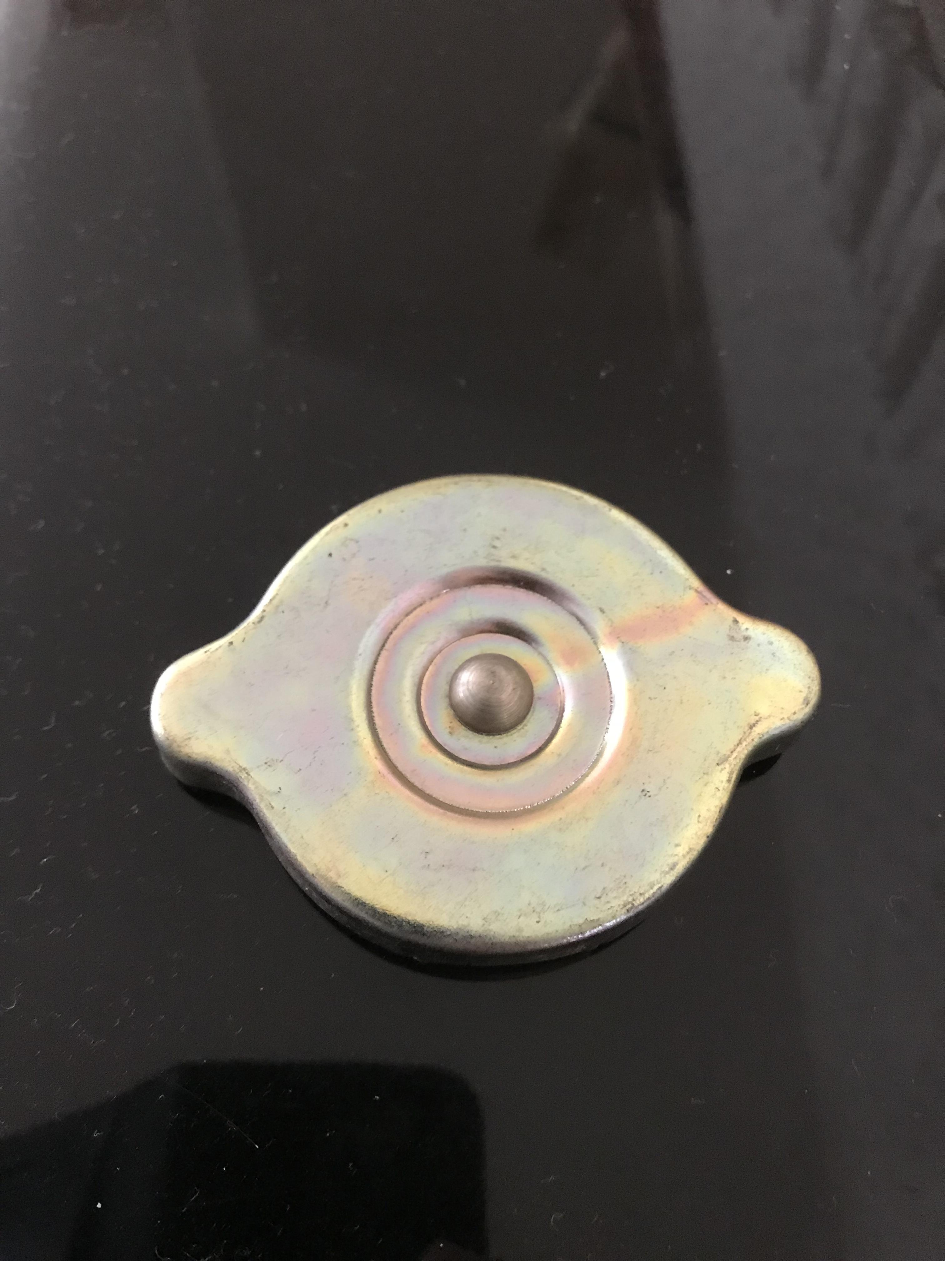

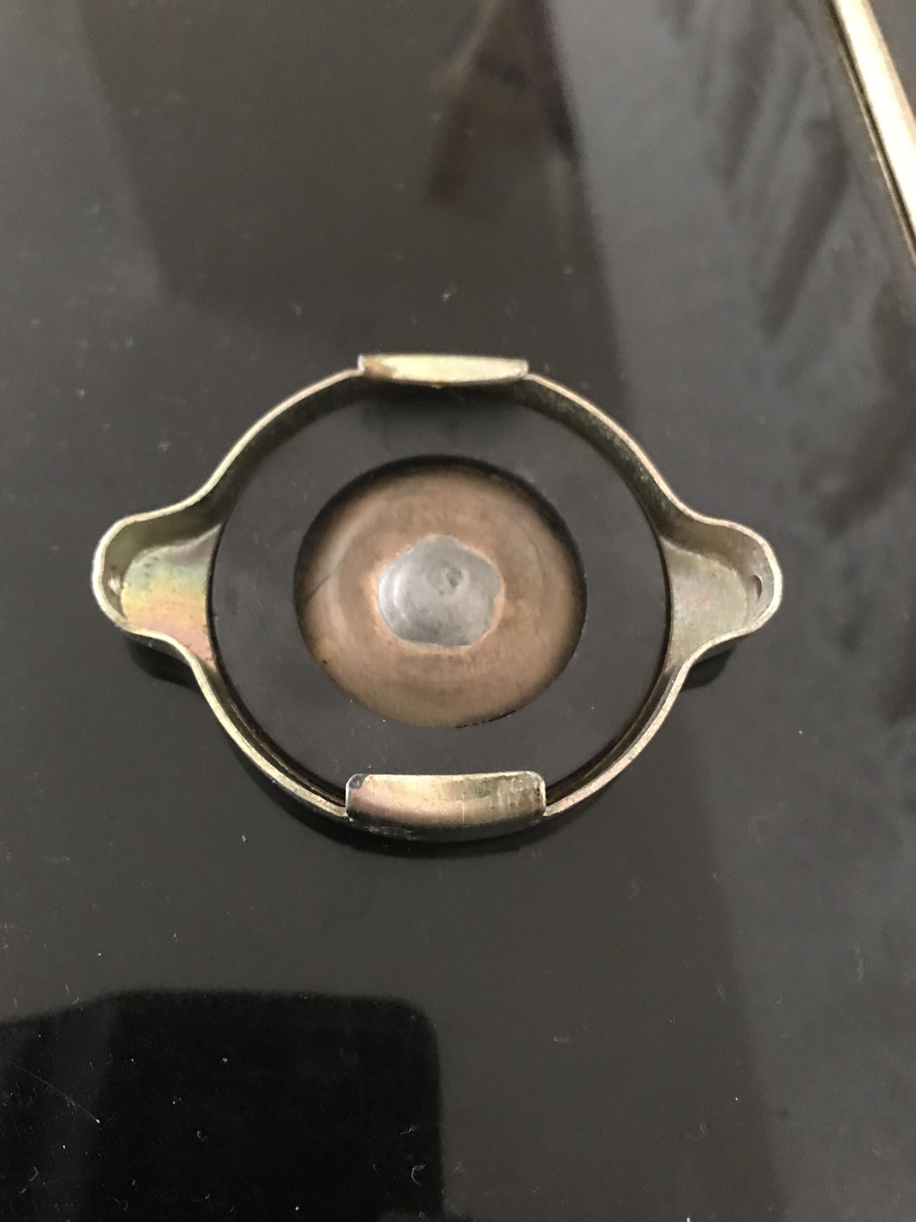

Hi ,
I found this cap in my father’s tool box , looks like it can be used for the Z432 , little bit different from an original NICHIRA cap  though. My father never owned Z432 nor Cedric/ Gloria , so this cap used for some track or some vehicles used in a  rice field .
I will run my Z432 with this plain cap on the radiator, while pressure relief type cap on the reservoir bottle.
Kats
Hi Kats,
Does the plastic reservoir bottle accept the same kind of cap? I saw pictures with a white plastic cap, but I didn't see anything with a metal pressure relief cap installed on the plastic bottle.
And also, have you confirmed that the plastic reservoir bottle was designed to contain the pressure involved?
Hi Captain!
I will try it within a few days , not on my blue 240Z because the 240Z does not have a pressure proof type tube for the bottle. The bottle itself is designed for a pressure acceptable, and it is designed for both plastic cap and metal neck , you  just need to twist the cap / metal neck for attaching or removing.
My Z432 has a pressure proof type tube , so I can load the certain pressure in the bottle , when I do it , I put the plain metal cap on the radiator , while pressure relief type cap on the bottle just like a description on the service manuals and the parts catalogs.
Let’s see how it goes , I hope I don’t break anything because they are so rare !
Kats
