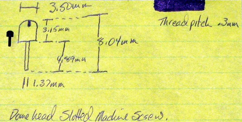

April 10, 200717 yr Author comment_205450 Here is a measured drawing(pardon my lack of drafting training!) Please let me know if I have made this complicated enough-I can do better! Will Link to comment https://www.classiczcars.com/forums/topic/23901-member-in-need-of-a-good-screw/#findComment-205450 Share on other sites More sharing options...
April 10, 200717 yr comment_205451 That's perfect Will. I'll start going through my bins. I can probably make one if I don't find one. I usually use a mix of gun bluing to come up with the right color. Link to comment https://www.classiczcars.com/forums/topic/23901-member-in-need-of-a-good-screw/#findComment-205451 Share on other sites More sharing options...

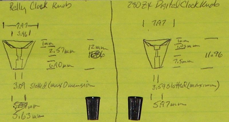

April 11, 200717 yr Author comment_205514 Ron, Here is skinny on the knobs! Will Link to comment https://www.classiczcars.com/forums/topic/23901-member-in-need-of-a-good-screw/#findComment-205514 Share on other sites More sharing options...
April 11, 200717 yr comment_205529 Ok Will - That's enough information to come up with one suitable. The 3.1mm head height is to provide more support for the knob to keep it from breaking. The one I have in mind would work well with a washer of the same diameter bonded to it. I need to come up with another thread gage. I'm using a gauge from my metric SnapOn tap & die set. The smallest gauge is .35mm and the smallest die in the set is 3mm (useless in this case). That makes it guesswork until I get the thread measured properly. I'll do it tomorrow. A thread pitch of .30mm is tough to measure with a .35 gauge. Link to comment https://www.classiczcars.com/forums/topic/23901-member-in-need-of-a-good-screw/#findComment-205529 Share on other sites More sharing options...
