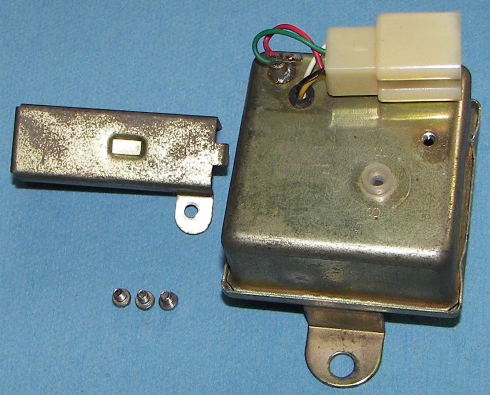

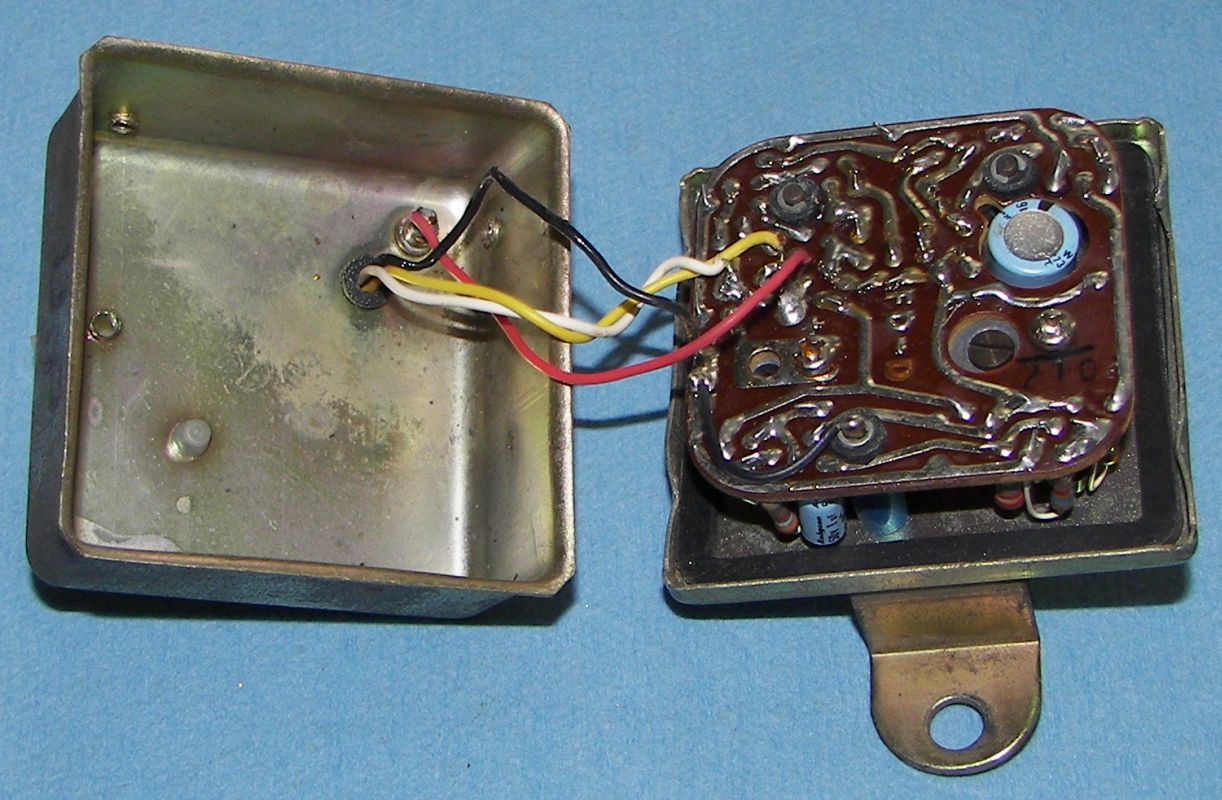

April 18, 200717 yr Author comment_206448 Naked Oscillator! This morning I received a broken Oscillator in the mail. Here is the progress on it! I have stopped at the point that I need to hunt down and clean my desoldering station-despite my enthusiasm! I don't want to create an issue from using the wrong tool, or have to stop again while I look for it, so I am parked until I find the right box and service its contents! Will Link to comment https://www.classiczcars.com/forums/topic/23919-a-good-screw-just-isnt-enough-it-must-oscillate/?&page=2#findComment-206448 Share on other sites More sharing options...
April 18, 200717 yr comment_206451 MMMM....printed circuits!! Will, we need a picture of the underside of that board! STAT!!!! I love stuff like this!Chris Link to comment https://www.classiczcars.com/forums/topic/23919-a-good-screw-just-isnt-enough-it-must-oscillate/?&page=2#findComment-206451 Share on other sites More sharing options...
April 18, 200717 yr Author comment_206456 Chris,Rather than possibly pull something out(the board is secured to three brass spacer posts that are swagged to the case by a combination of E clips and solder, but it looks like there is only one item that I could not readily identify as a resistor, Cap, or Transistor. All of the pieces I can see are typically identified with color code or printing!Other than the one oddity, there does not seem to be anything that will stop this from happening-though I DO RESERVE THE RIGHT TO BE WRONG ABOUT THAT!Trust me Chis, You don't want to dig into this any more than I do!But as this is not mine, I won't risk doing further damage to something that someone was kind enough to loan me/us!Will Link to comment https://www.classiczcars.com/forums/topic/23919-a-good-screw-just-isnt-enough-it-must-oscillate/?&page=2#findComment-206456 Share on other sites More sharing options...
April 18, 200717 yr comment_206460 But as this is not mine, I won't risk doing further damage to something that someone was kind enough to loan me/us!WillPerfectly understandable. Without permission I wouldnt want to surgically damage the unobtanium organ. Chris Link to comment https://www.classiczcars.com/forums/topic/23919-a-good-screw-just-isnt-enough-it-must-oscillate/?&page=2#findComment-206460 Share on other sites More sharing options...
