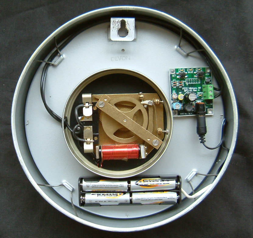

I have a ralley clock and no oscilator. I've been waiting for someone to find an inop one and perform reverse engineering. I wil help fund such a venture for the renumeration of a working unit!!
8 year old thread back from the dead. Probably nothing else was done after these guys ran into a dead end and gave up.
Well, since i've accumulated 3 of these clocks without oscillators, i've been doing a little research myself and ran across this thread.
I'm not an electronics guru for sure but this much i think i've figured a little more out. It's a slave and master type with the slave
being the clock gears and hands. The master is the oscillator/impulser.  Smith clock co used to make these and people have made universal
impulser's to retrofit the old smith clocks. Guess who made the oscillators for the later Smith clocks. Jeco supplied them.
I think the only way to solve this problem is to find the correct motor voltage and start by tweaking the pulses.
It would be helpful to know what the tuning fork frequency is but i have not found anyone who has hooked a scope
up to one and measured it. There is an equasion however that gets you in the ballpark. I just have to know how long
the fork is.
This guy measured frequency
https://www.youtube.com/watch?v=0vP3SE-wD6Q
I've seen references  to the datsun oscillator comparing it to the bulova tuning fork watch. The main difference is the bulova had a direct mechanical link
from the fork to the "slave" part of the clock. Whereas the datsun clock is 2 completely seperate pieces whereas the Jeco turns the tuning fork  motion
into electronic motion (pulses).  So it makes it easier to retrofit using more modern electronics.
Whats confusing though is that some of the old slave clocks have a coil and some of the "less old" slave clocks
refer to a motor. I don't  think it matters that its sending pulses to a coil that moves a mechanism or a motor.
I found a list of the types of clock motors and I believe the rally clock uses the stepping motor

Here is a universal impulser/oscillator they sell on ebay for 98$
http://www.piexx.com/imp2/imp22k.pdf
post-23403-0-61365600-1433195754_thumb.j
