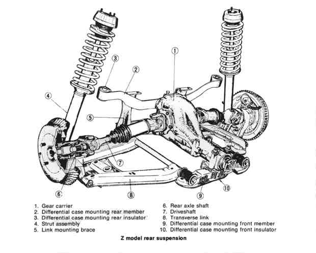

April 15, 200717 yr comment_206021 ddezso said: You mention removing struts without disconnecting the transverse link. Is there a way for me to replace struts and springs without making this disconnection? Hi ddezso: Yes - as mentioned by others, you remove the 4 bolts/nuts that hold the driveshaft on the hub {see #7}, disconnect the E-Brake Cable and loosen the bolts on the inner side of the Transverse Link {one on the front at the Differential case mounting front member - see #9 and the one on the other end} Disconnect the Brake Line! Put a floor jack under the rear hub to hold it in place {the rear of the car should be on jack stands at this point} - - Then take the 3 nuts off the top strut mount - let the jack down, move it out of the way and push down on the rear transverse link - and you should be able to pull the strut down, lay it toward the outside of the car... out past the outside of the rear fender arch. Then you can put a spring compressor on the spring - and change the shocks/springs etc. Actually you can do the rears without a spring compressor - but since you need a spring compressor for the fronts anyway - might as well use it. FWIW, Carl B. Link to comment https://www.classiczcars.com/forums/topic/23953-need-help-with-rear-suspension/?&page=2#findComment-206021 Share on other sites More sharing options...
