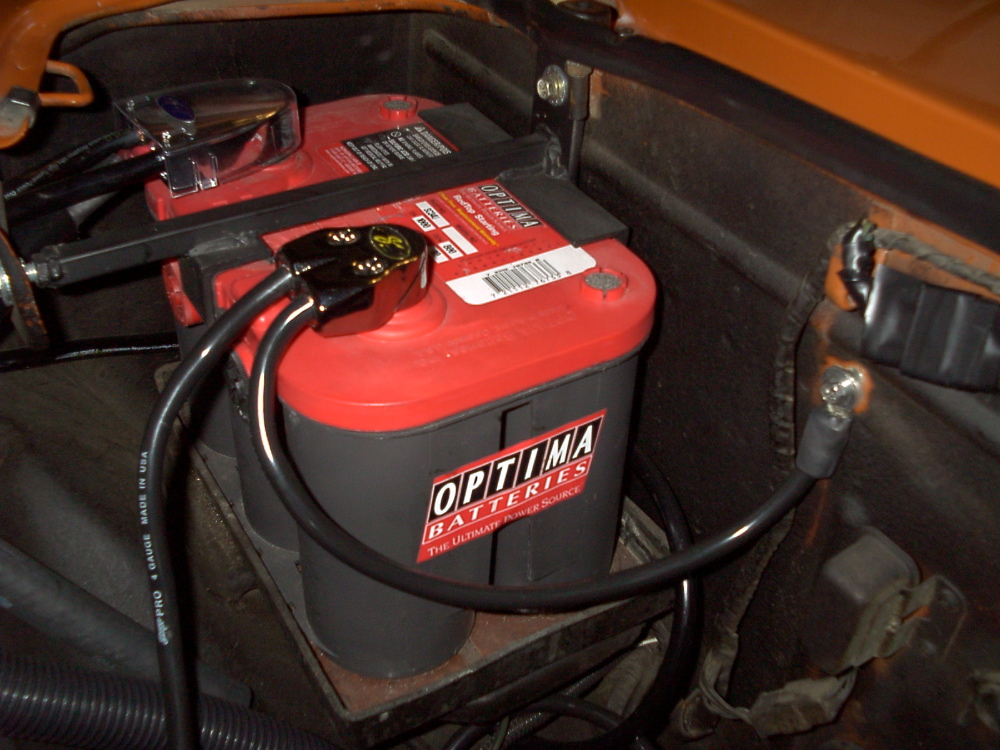

Boy, talk about some sharp eyes! I always thought the bumper guards looked funny, and even asked the PO the same question. He told me they were like that when he bought it from the original owner in 80' so I left it at that. The battery is "correct", somewhere along the line the battery cables were replaced and somehow, the red is the ground and the black is the hot. It is on my (small) list of things the fix. I have no plans to competitively show this car. I enjoy driving it too much and hate cleaning it plus I do not need anyone "nitpicking" my car and telling me "oh, I'll have to take a point off because you have incorrect hose clamps" sheesh! I'm just trying to keep it as a clean example of a 240z without going into a full on restoration....

I wouldn't worry about things like the color of the ground wire, or that kind of stuff. It doesn't matter. First time I took my yellow 240Z out in public, I attended a small show-n-shine of local Z enthusiasts (240-350 inclusive). When the owner of a beautiful show-quality V8 conversion asked which car was mine, I pointed it out and apologized for its shabby, rusty appearance. His comment was, "So what? It's a 240Z, and it runs, drives and is still on the road. That's more than can be said for most of them." I took that to heart. Yours is far better than that, so don't feel the need to apologize.

In the case of your battery, I really don’t think it’s a nitpicking issue but rather a safety issue. There is good reason why positive cables are red and negative cables black or some other color besides red. Now you may know and are aware of the fact that the cables are reversed but should someone else, a friend, mechanic, starts having to mess with the battery I can pretty much assure you they will not look down and search for the itty bitty + or – symbol on the battery. Rather, they will see red and assume positive and they will clamp the positive there and you might then have more than an itty-bitty problem. It’s a simple fix and it gives you a chance to not only clean the ground but also get a decent size ground wire to the firewall.
