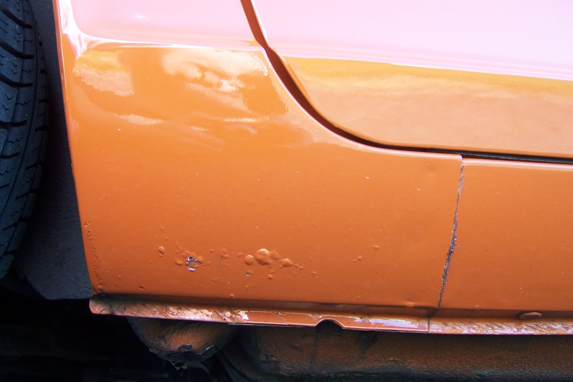

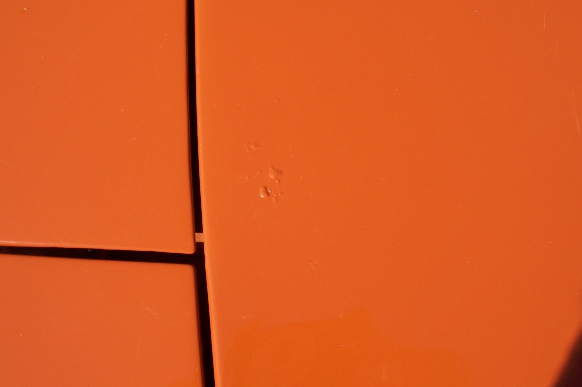

Posted April 21, 200717 yr comment_206817 I am getting ready to repair a few (rust?) bubbles in the paint. The affected areas are the doglegs and a small spot on the cowl, pictures are attached. I have next to nothing that I need for this and therefore need to get a shopping list together and y'alls help would be greatly appreciated. I do have an air compressor. A small stand up Craftsman model. 3hp @ 90psi / 1.5hp @ 150psi w/15 gal tank. I was thinking of buying an angle grinder but feel this may be overkill for the job. Should I just get a DA? If I do get a grinder will a 4.5" 10 amp 11000 rpm DeWalt grow with me through the rest of the restore in the years to come or do I need to shop for a 7" ? or both? What attachments would I need for this job? If a DA suits this job better, what should I look for? What attachments would I need? Best brands to buy? POR15 seems to be the most popular way to go and I've seen reference to Zero Rust (?) lately. This may not be a permanent fix as I plan to have the paint and body professionally done in 5 years or so. Will POR cause any issues for a shop later on? Should I buy the "starter" kit or piece my own together? Best place to buy? What other cleaners/strippers/etchers/primers will I need? I intended to rattle can these "repairs". Last year I bought a touch up tube of Atomic Orange (A16), a color available on '03 Xterras, to fill in a few chips and the match is uncanny to the Maaco like paint job that is on the car now. Nissan does not sell rattle cans of thier paints, does anyone know if there are paint shops that can make rattle cans? I haven't checked Dupli-color yet, they may have it available. Please fill in any areas I've left out. Thanks in advance, I look forward to your responses! Nate Link to comment https://www.classiczcars.com/forums/topic/24042-grinding-sanding-por-painting/ Share on other sites More sharing options...
April 21, 200717 yr comment_206819 Nate,Those Doglegs(at least one of them) are probably just holding on, and need to be replaced. Unless that is your intention, I would attack them (and the cowl) from the inside with metal ready and some POR to stablize them for the next 5 years and get the job done once, right. POR is a roysl psin in the A$$ to remove, and is made for permanent not temporary repairs.Will Link to comment https://www.classiczcars.com/forums/topic/24042-grinding-sanding-por-painting/#findComment-206819 Share on other sites More sharing options...
April 21, 200717 yr Author comment_206821 snip POR is a roysl psin in the A$$ to remove, and is made for permanent not temporary repairs.WillGood info, Will. I suspected as much. I may try the other product since it is supposed to be a spray on. I'm not looking to replace any sheetmetal just yet, but like you said "stabalize" it for now. I pulled the cowl last year for a look-see and the underside was in good shape, so I intend to POR or similar this time.As far as tools and chemicals go, any suggestions Will?Thanks-Nate Link to comment https://www.classiczcars.com/forums/topic/24042-grinding-sanding-por-painting/#findComment-206821 Share on other sites More sharing options...
April 21, 200717 yr comment_206823 Nate,If you're unable to get a good enough color match from spray cans on the shelf, a paint supply house can mix up your color, (by the paint code) and put it into spray cans for you. The supplier I use has a two spray can minimum and the price is around $10 per can. You might have a small difference in color from what's on the car now but it should be darn closeI agree with Will, keep the por products on the inside and any filler, primer and paint on the outside. Good luck with your efforts.Bruce Link to comment https://www.classiczcars.com/forums/topic/24042-grinding-sanding-por-painting/#findComment-206823 Share on other sites More sharing options...

April 23, 200717 yr comment_206998 Nate,Those Doglegs(at least one of them) are probably just holding on, and need to be replaced. Unless that is your intention, I would attack them (and the cowl) from the inside with metal ready and some POR to stabilize them for the next 5 years and get the job done once, right. POR is a roysl psin in the A$$ to remove, and is made for permanent not temporary repairs. Will Nate, we seem to have gone on to the equipment part of the problem. Back to the repair. Will has hit the ''nail'' on the head. Remove the trim from inside and have a look in the cavity of the dog leg. You most likely will find the rust has gone through the sheet metal causing the bubbles in the finish. You can Temporally repair this with POR . If it isn't so bad that the car is weakened in this area. From what is shown it shouldn't be. Be SURE , if you use POR that you follow the instructions from the manufacturer . Use the marine clean and metal ready to prep the metal , and it is imperative that the area to be treated is dry. You my need to use some of the ''cloth'' to cover the holes from the inside. I have found if this is needed , to paint on the POR and let it set until tacky then apply the cloth and press it in place. Then while still tacky paint on another coat of POR. I actually sprayed the POR into my rocker and doglegs . I didn't have any rust through only surface rust. I dodged that bullet . Harbor Fright has a syphon ''gun'' that works well for that . Only $6.00 too. I doubt the compressor you have will handle any of the air tools that have been recommended. They all need much more volume . I have a electric palm sander meant for wood working . It is a D/A Porter Cable brand . I used the hell out of it on my Z. When I was preping my Z for paint. Since I have no apparitions to be a professional body/paint guy I just used what I had . I did buy a set of air tools at Costco and also a angle die grinder from Harbor Fright which I used as much as any tool in my project to make ready for paint dealing with the rust issues, and doing the mechanical work. Even these little die grinders use lots of air volume you will find. Not so much pressure but volume . Gary Link to comment https://www.classiczcars.com/forums/topic/24042-grinding-sanding-por-painting/#findComment-206998 Share on other sites More sharing options...
