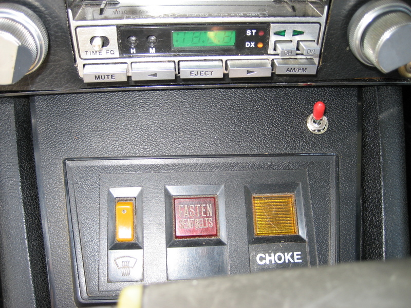

You can either test it or replace the bulb, or make sure there is current running there. The buzzer you are talking about is the seat belt alarm buzzer. There is also a light attached to it that is in the fuse box cover. When you look at the cover there is a switch for the rear defrost, a light for the choke and a seatbelt warning light. If I had a pic I would post it.
Is this by chance the pic you hope you had? If so, this is where the noise is coming from!! :) I think ur right. I will go down to the house today and check it out. Will post results tomorrow.
(on a side note, does anyone know what the switch on the top right could be for? The PO said when he got the Carbs rebuilt the guy put that switch there for extra fuel. But, I was like " i don't see how a switch will do anything since carbs don't have an ECU for fuel.)
The Red fasten seatbelt light. Yes that is the pic. Check to see if it is connected and see if the bulb needs to be replaced. If the light comes on the same time the buzzer does then put your seatbelt on. :) That cover sure looks better than mine.
I am not sure about the switch. Chase the wires and see where they go???
