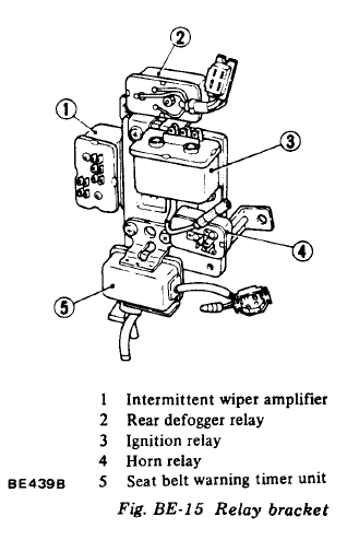

April 29, 200718 yr comment_207560 The relay bracket. Link to comment https://www.classiczcars.com/forums/topic/24130-horn-question/#findComment-207560 Share on other sites More sharing options...

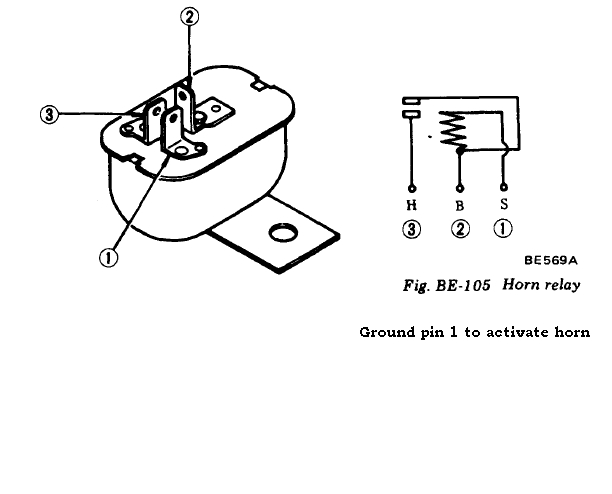

April 29, 200718 yr comment_207561 Sorry, I forgot the relay itself. If you ground pin 1, the horns should sound. Pin 2 should be hot (12v) so check that too, straight away. Then follow the wiring if you have to. Whatever it is, it'll be simple. Link to comment https://www.classiczcars.com/forums/topic/24130-horn-question/#findComment-207561 Share on other sites More sharing options...
