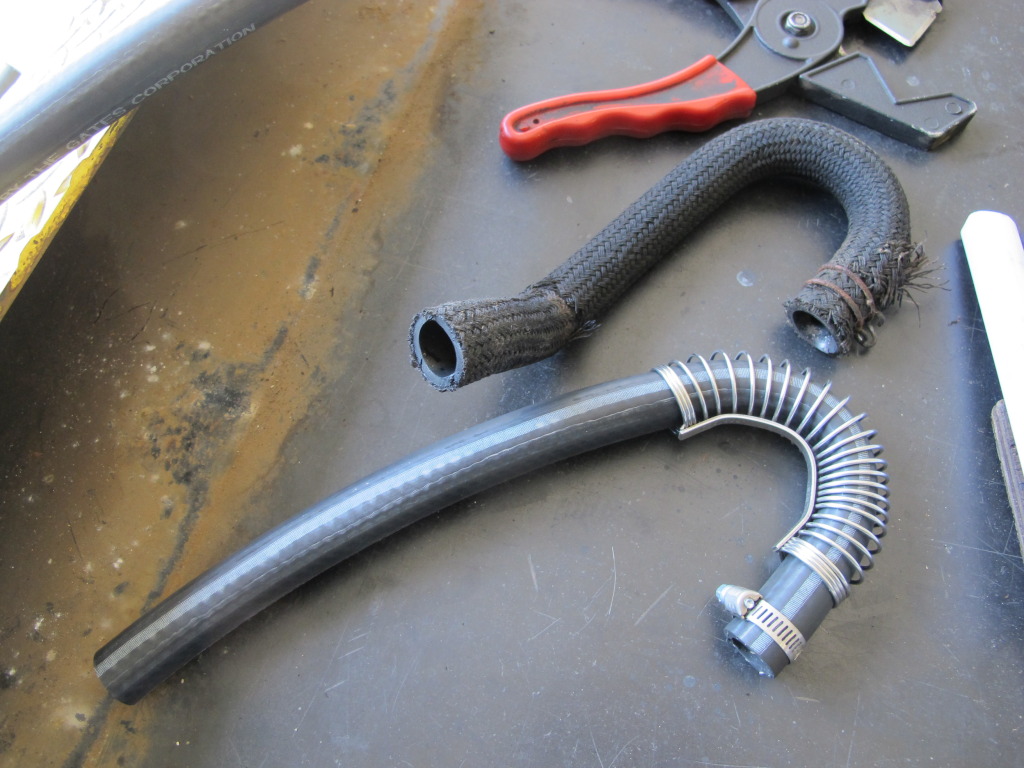

I saw a photo from RatsunZ.
Does anyone try this unicoil hose bender for using this for 17235-E4601, Large diameter hose with several preformed bends, including a 180 degree bend?
Do you think it's safe to use it for vent hose?
