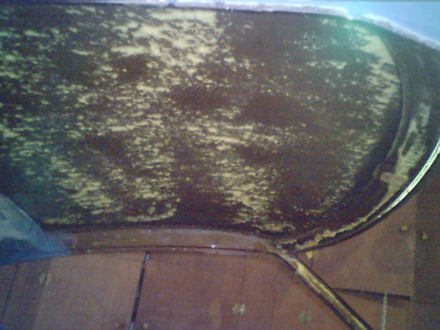

Ok. I have pulled the old roof liner. Now I have all this foam & glue up there too deal with. :sick:
I know I could use A spray on remover. But I dont like the thought of this stuff driping all over me while I am scraping it clean.:( I also know no matter what its gona be A dirty job but dont need chemical burns on top of the heat of the day here. 101 outside and no AC in the shop:tapemouth .
Anyway, Anyone know A way?

I used some sand paper to knock of the majority of it - at least the foam. I didn't do anything else after that because I wasn't restoring mine. Try it on a corner to see if it will work for you.
Don't forget to wear some googles.
I went & used my drill with A wire wheel brush. It made fast work of the foam that was left. Now I have lil foam balls all over my floor n there a real pain too sweep up. :stupid:
This did not do anything with the glue. :ermm:
I am going too try the sandpaper tomorrow after work.
You might try good old lacquer thinner on a rag.
Dampen the rag and wipe the larger clumps. Note that this WILL dissolve the glue, and if you work quickly you will get it off, if you work slowly, all you will succeed in doing is moving it from one spot to the next.
You might also try either mineral spirits, or 3M Adhesive Remover. Mineral spirits may take a lot of elbow grease and the 3M stuff might be not only spendy but also hard to find.
If all else fails, Acetone. This evaporates REAL fast, and you will have to work very very quickly, but it will also remove the glue.
NOTE: USE EYE PROTECTION AND A BREATHING MASK. The fumes from these can literally light you up.
Good Luck
Thanks for taking the time. My main prob. is all the things that will remove the glue are also able & will burn skin. Not my hands ( there use ta it) but drips getting on my back, head , face and so on. :stupid:
Oh. I have my driveline out so no batt. but thanks for the heads up.
I have the 3M adhesive remover. Just not looking forward too doing A 3" x 3" space @ A time in order too keep dripping down. It's HOT outside & in my shop with A barn fan on shows 80.:sick:
Maybe you misunderstood what I meant by dampen, I meant get the rag ...moist, but NOT dripping with thinner.
The reason for the eye protection is that you may knock off a bit of the glue either before or after you hit it with the rag with thinner and in either case it doesn't belong in your eye.
Now the thinner will also evaporate, but you can continue wetting, wiping, and little by little you'll get it done.
No I understood. I was trying that but it was turning into A gum after awhile then drips:cry: So I have used my 3M remover in small spot's then cleaned it and moved on. It seem too be working well. But it's way too hot out there ta deal with it now. Thanks again.
