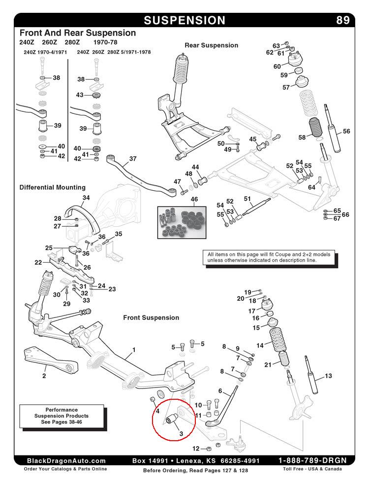

abot the LCA, the longer part should face back the back (check the pic.), the workshop screwed it up once putting one facing the rear and other the front, but now job is done..
