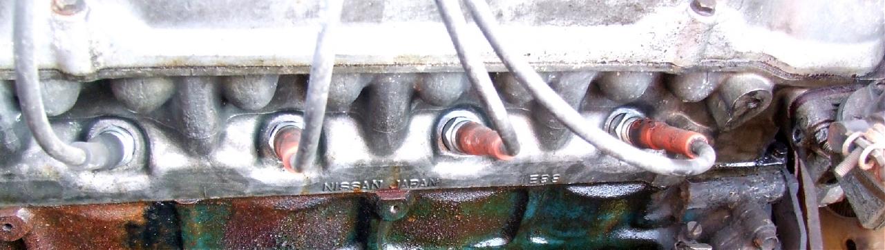

Thanks for the information on the E88 heads, Arne. I had heard of there being different ones, and was aware of the larger-valve variety for 260's, but you have laid this out for us very well. I appreciate that, because I think I now at last understand! I cannot vouch for the E88 on my early '71 as being an original mate to the block..... the engine # is 030185, and I'm pretty sure it is the original block to the car. The engine compartment data plate is missing, but the number falls in line with the range of block numbers for that approximate date of manufacture (according to those of close mfg. date listed in the "registry" ). Have you heard of any way to determine which head is which among the E88's without pulling them off for inspection? Were there any subtle casting mark differences, for instance? Maybe the lettering? I'll include a picture of the one mated up to my '71 in case there is any value to seeing it. (pause) I went out to look at my '72 & '73 E88's ..... the lettering & numbers on the later two years seems larger than the one on the '71. Also, the 'earlier?' one has a sort of a 'flat' cast in it just between the "4 plugs right where it mates with the block. I'll post pix of what I am trying to describe. Maybe those differences mean something ? I have another E88 that I can check out too, but I have no idea of the origin of the head & therefore can't try to date it. It would be great to figure a way to discern among them without having to pull them.... I'm thinking about putting one of them on my driver to eliminate a persistent valve tap that can't be adjusted out (seems to be excessive wear on the lobe where the stethoscope tells me the tap is.) In light of the differences among E88's I'm not sure now that I want to swap the whole head.... maybe just the cam and mated lifters from another head. I'd prefer not to have to start using high octane fuel as a result of getting the valve tap resolved! I guess that's where this thread started, so we've come full circle. (I guess if we start really talking heads a new thread should be created?)

(Both of these pictures are of the same head on my '71.)
Hey DeesZ, looks like your block in the first pic, is a bit wet, kinda like mine is nowadays. Mine has been weeping coolant from the gasket to the outside of the block, and I have to top off the radiator every once on a while.Have you been experiencing the same thing? I recall that our old friend Bambkiller mentioned he had this issue for about three years before he replaced the gasket.
Also, on the '71 block picture, what is the electrical (I guess) unit just to the right of the dipstick? My others don't have that thing. Any clue what it is?
I'm guessing that's te male side of a plug for a block heater used during winter months to keep the water in the block from freezing and cracking the block.
