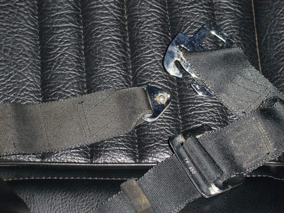

"Correct", my car, 5/70 has the lap belt with the shoulder strap per the picture below. The shoulder strap has a detachable buckle that I discovered by accident when I was re-installing them. I assume these are correct for a 1970. My belts are in decent shape but I have no idea how well they'll hold up in the event of an accident. If I have them redone, I'll lose the OE tags shown sewn on the belts. Safety/originality, safety/originality, what a dilemna! For now I'm just driving slower LOL

70 an 71 seat belts were identical. It you find a set with the detachable shoulder belt mentioned above they're correct.
Be wary of the webbing and stitching after 37 years. Faded or frayed nylon is a sure sign they've been weakened by exposure and use.
Not so. The seat belts from a '69 or '70 built 240Z had a black aircraft-style buckle. Starting in 1/71 they switched to a push-button release with a 'Z' on the button. The later push-button style will fit and work in a '70, but they aren't technically 'correct'.

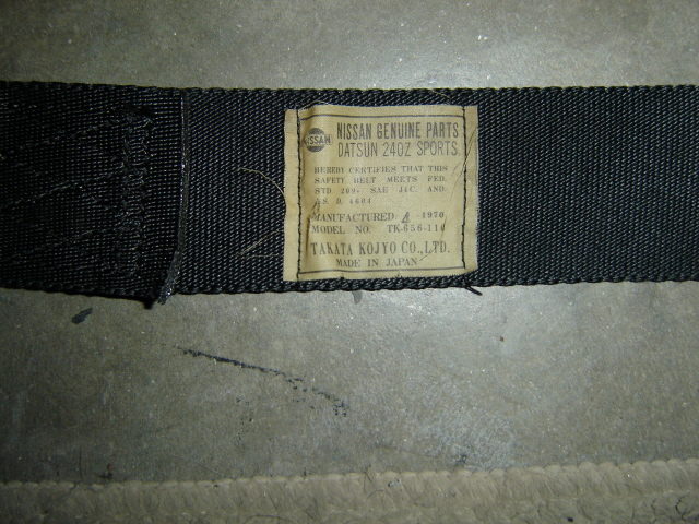

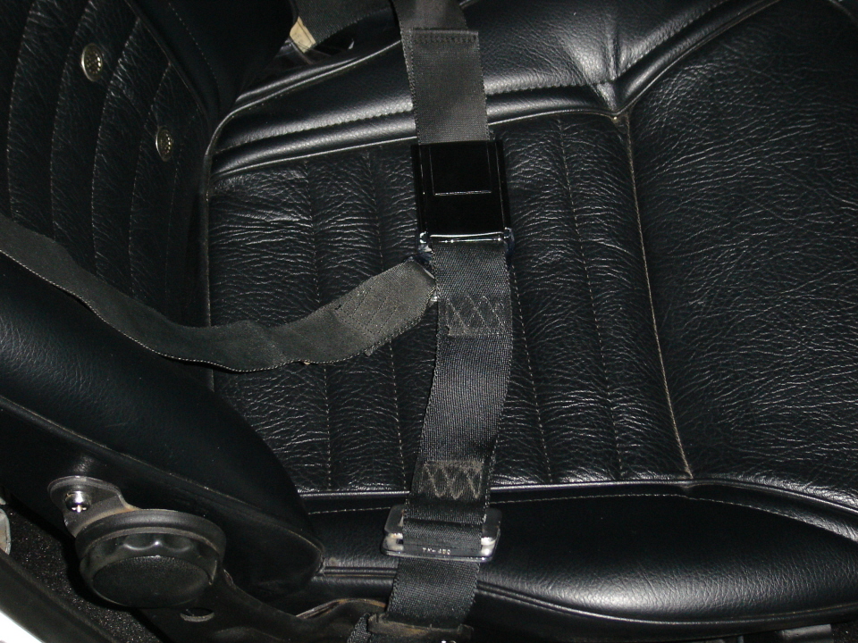

Three pictures of seat belts and a link to the company that restores them. http://www.ssnake-oyl.com/
The first picture is of the correct belts for a '70. The second picture is of the lift style buckle. The third picture is of the later push-button type with the Z logo. The correct belt buckle is black with a portion of the lift handle in a black wrinkle finish. I love the second picture because it is of the early belt style with a 1972 ID tag sewn on to the belt. Very odd.
