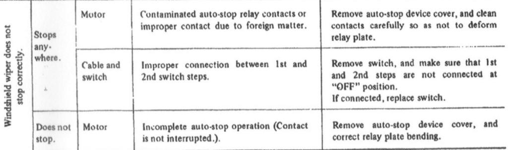

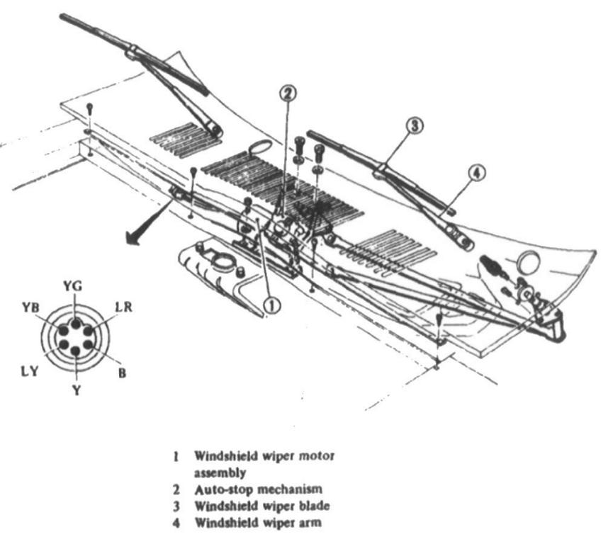

There is a relay in the passenger footwell. The one for the wipers is the one with two plugs and the contacts facing outwards. It however is most likely not the cause of the problem you describe which is actually two problems. The lack of the middle speed is most likely due to dirty or bad contacts in the switch itself and the parking problem is most likely due to dirty or bad contacts in the auto stop mechanism located in the center under the cowl. Do you have a FSM? Pages 59-67 in the Body Electrical section cover the wiper system and would be a bit lengthy to paraphrase here.
I didn't know there was an auto stop mechanism under the cowl. Where would that be? I've had the entire wiper system out, and basically all there is under the cowl is the motor and the linkage arms. From discussions here & on HybridZ, the auto-stop switch is inside the wiper drive motor.
hornz-
You might first try cleaning all the connectors; on the wiper control amplifier, and the motor connector under the hood.
