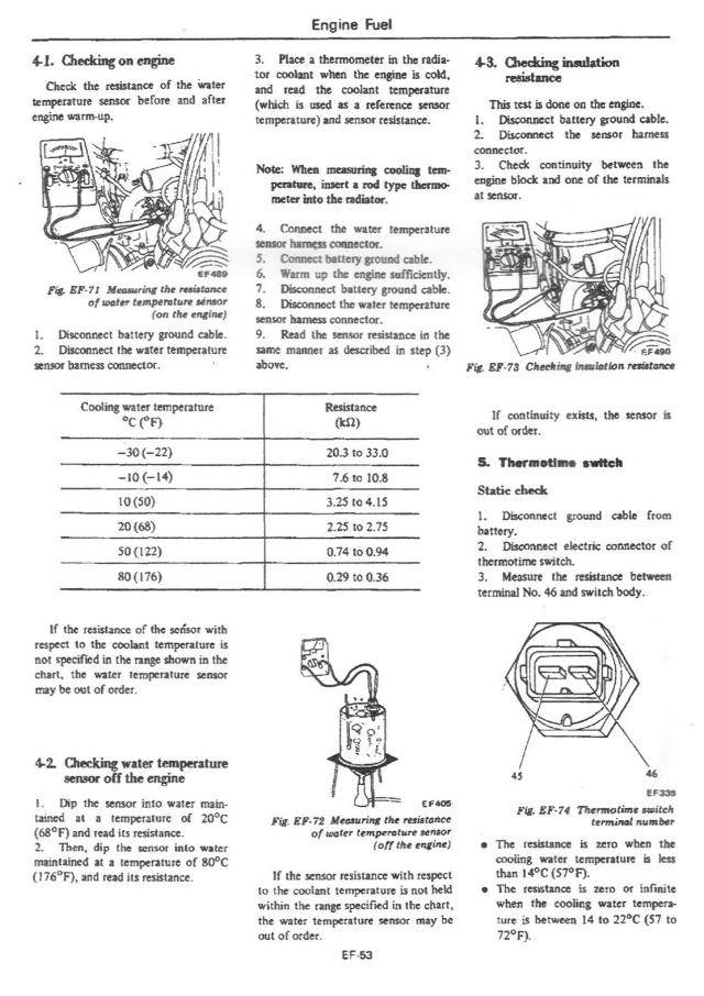

June 29, 200718 yr Author comment_213648 I tested the temp. sensor on the ECU harness, it read approx. 600 ohms when the air-temp sensor was about 1100 ohms, is that normal.I was going to replace the temp sensor anyway, but I didn't realize a bad one could cause these symptoms. Thanks for the heads up. Link to comment https://www.classiczcars.com/forums/topic/24734-help-surging-hesitation-backfire-on-efi/#findComment-213648 Share on other sites More sharing options...

June 29, 200718 yr comment_213664 I tested the temp. sensor on the ECU harness, it read approx. 600 ohms when the air-temp sensor was about 1100 ohms, is that normal.I was going to replace the temp sensor anyway, but I didn't realize a bad one could cause these symptoms. Thanks for the heads up. Here's the test procedure for the temp sensor from the 76 FSM: Link to comment https://www.classiczcars.com/forums/topic/24734-help-surging-hesitation-backfire-on-efi/#findComment-213664 Share on other sites More sharing options...
