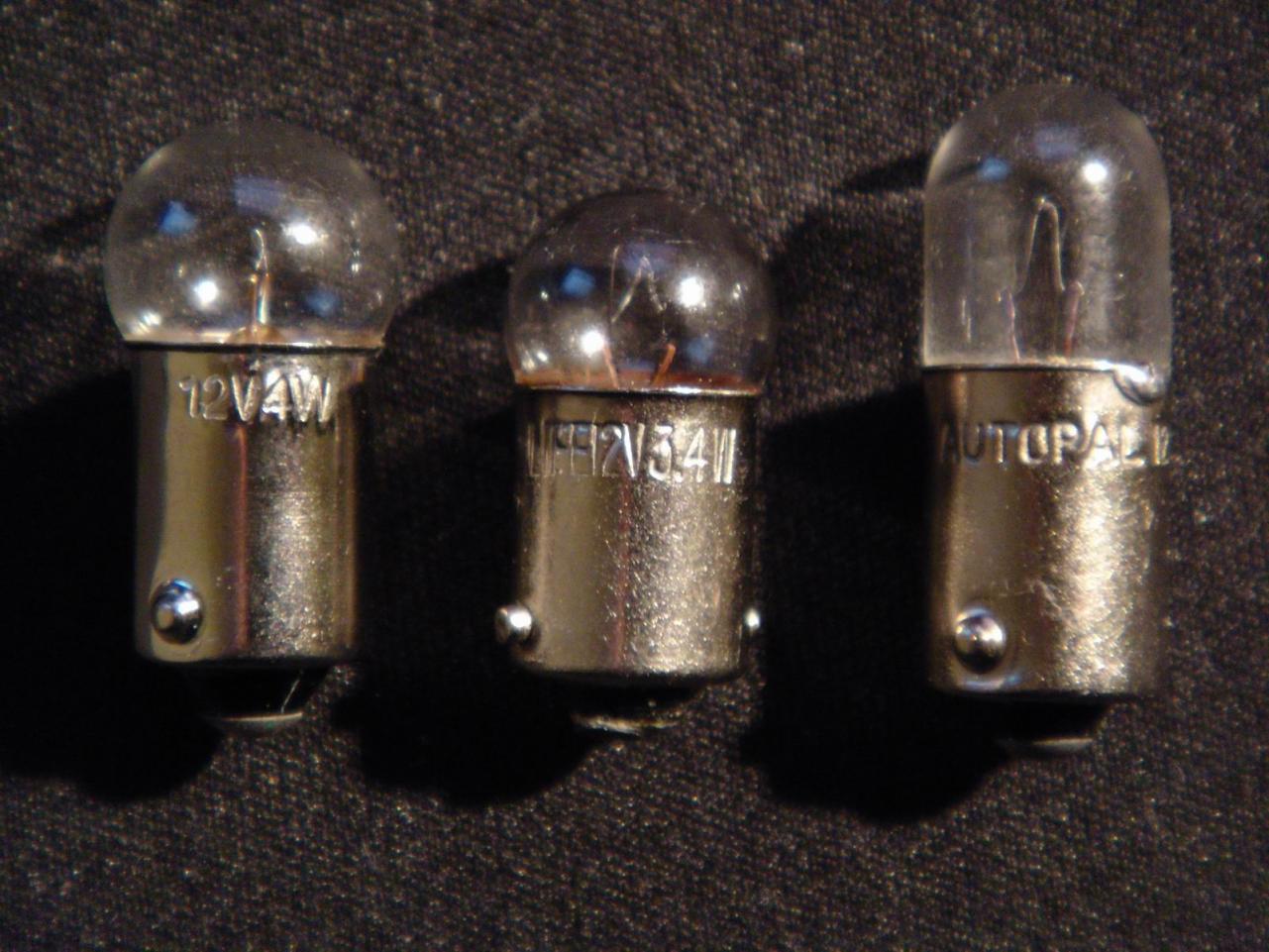

April 19, 201014 yr comment_316452 Finally received the Eiko A-72 bulbs. Got 30 of them for only $12 plus shipping from PlanetBulb. In comparing the three types I now have, they are not an exact match for the LIFE 12V3.4W bulbs that were in there, but hopefully they will fit. They are much closer than the Autopal bulbs MSA is selling. The car is up on stands right now for new ball joints and tie rod ends, so I'm not inclined to jump inside and monkey around with my body hanging out the door to reach the gauges, but maybe by the weekend. As you can see from the picture, the Eiko bulbs (on the left) are slightly larger than the perfect-fitting LIFE bulbs. I whipped out my caliper and figure there should be about 0.020" clearance between the glass and the green dome, based on my previous measurements. I just can't believe MSA is selling these Autopal bulbs, when clearly they have issues, at least for some of us. 28 bucks down the drain! Link to comment https://www.classiczcars.com/forums/topic/24784-dash-lights/?&page=2#findComment-316452 Share on other sites More sharing options...
