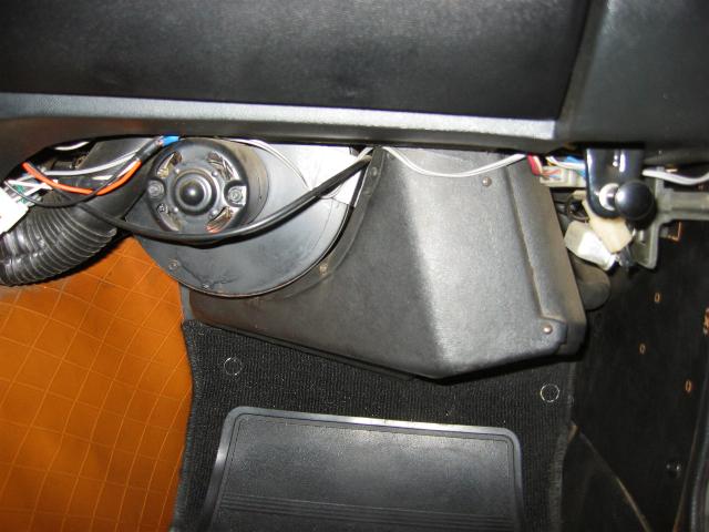

You might not be clear on the term 'evaporator'. It's located under the dash and the capillary tube sits between the fins of the evap to sense the temperature. You want it to shut off if the evap starts to freeze up. It will save your system. Which system do you have? Is you compressor upright or rotary? If it's the typical aftermarket system as there was no factory air in the US in a 72, it will look something like this. To get to the evaporator, you'll have to open the case. Make sure that drainage tube is not blocked because that could be the source of your problem as Ron earlier stated.
