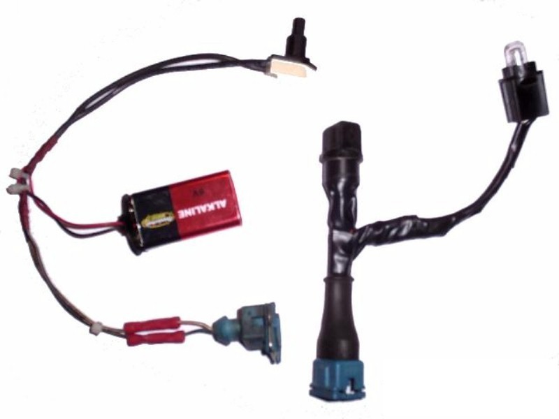

July 14, 200717 yr comment_215060 Welcome to the club and congrats on lovin Fords! I'm with ya on that one. Go back to the jy and get an injector harness, just the end that goes on to the injector. Hook up a push button switch to a 9v battery and listen to hear if your injectors are clicking. If they click they're working. No garauntee if they're workin good but you'll know at least. Link to comment https://www.classiczcars.com/forums/topic/24882-no-start-no-run/#findComment-215060 Share on other sites More sharing options...

July 14, 200717 yr comment_215080 Welcome to the club and congrats on lovin Fords! I'm with ya on that one. Go back to the jy and get an injector harness, just the end that goes on to the injector. Hook up a push button switch to a 9v battery and listen to hear if your injectors are clicking. If they click they're working. No garauntee if they're workin good but you'll know at least. Like these? The on on the left is the on you described. The one on the right allows you to see the signal while the car is cranking or runing by placing the bottom connector on the injector and the injector harness connector on the top. I made these up about ten years ago and they've both been very useful. Link to comment https://www.classiczcars.com/forums/topic/24882-no-start-no-run/#findComment-215080 Share on other sites More sharing options...
