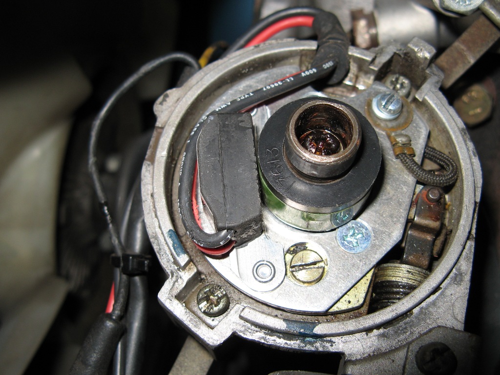

I'm having my '73 240Z engine rebuilt and am trying to install the Petronix ignition system in the stock distributor. I purchased the unit, but the garage that is rebuilding the car is telling me that the system isn't fitting correctly in the distributor. Something about the unit not being able to rotate.
Can anyone tell me if the system does just "drop in" or is there something else that needs to be done? I have a manual transmission if that info is needed.

You'll find that most people (myself included) who have done the mod to electronic ignition have used the E12-80 Nissan distributor mod to their 240's. That's a distributor from a later year Z (78 or 79, others will undoubtedly chime in and correct me).
I know the problem your mechanic is referring to, as I've done that same mod on my 1600 and 2000 Sports Roadsters.
The problem is that the jig they use to drill the mounting holes for the Pertronix base plate has the centers of the holes just slightly off and the sensor on the plate rubs against the magnet holder that mounts over the dwell nut....mostly due to the tape they had to add to the magnet to ensure the magnets don't fly out of the holder.
The jig they designed years ago to hold the plate did NOT have the thickness of the tape being considered as part of the diameter of the magnet holder. As a result, the magnet ring with the green tape RUBS against the face of the sensor and it's impossible to move the base plate out enough to provide a gap of any size. I called Pertronix about this and unfortunately there's some bozo there who is convinced that since they've been manufacturing them for over 35 years (his words) that there isn't anything wrong with their manufacturing process and the problem MUST lie with your car's distributor.
(Makes you wonder how their QC dept must do their job.
"Did you do it the same way we've been doing it, even though there's been a change?";
"Yes!";
"Then it MUST be OK. Tell the customer he's full of beans.")
The solution I came up with was to very carefully slot the mounting holes (and we're talking THOUSANDS of an inch) such that you could in fact move the base plate and the sensor away from the magnet holder. Be careful of this, remember you only need enough clearance for the sensor and ring to NOT touch. Be sure that your distributor has no play in the shaft (no wobbling back and forth) and you should be fine.

I had no problems of that sort with my installation..... but yes, there was very little clearance as mentioned above - a bit less than the installation instructions called for if I recall correctly. I'm pleased with the unit and its performance.
Thanks for the info. I printed out the messages and passed it along to my garage. Hopefully they'll be able to cut the notch and make it work. I also purchased a 280ZX dizzy with the E-1280 module last night on e-bay if this doesn't work out. Now the 280ZX dizzy should be a direct drop in, right?
