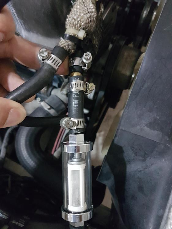

March 8, 20187 yr comment_544018 Still checking. By the way i would like to know if a 5/16 inch is the right hose to connect to the fuel rail that goes to the carbs???? Its not a snug as tight at is should be but at least its not dripping any fuel after i tight it with a precision clamp. Link to comment https://www.classiczcars.com/forums/topic/24943-carter-4070-issue/?&page=2#findComment-544018 Share on other sites More sharing options...
March 8, 20187 yr comment_544025 If it's not leaking, I'd leave it alone. Link to comment https://www.classiczcars.com/forums/topic/24943-carter-4070-issue/?&page=2#findComment-544025 Share on other sites More sharing options...
March 8, 20187 yr comment_544027 Not leaking just wondering if sliding a 5/16 hose is the correct measurement. Link to comment https://www.classiczcars.com/forums/topic/24943-carter-4070-issue/?&page=2#findComment-544027 Share on other sites More sharing options...
March 8, 20187 yr comment_544028 Due to the diameter of the tube, you're left with the option of trying to force a 1/4" hose on or tightly clamp a 5/16". The 5/16" looks fine to me. Link to comment https://www.classiczcars.com/forums/topic/24943-carter-4070-issue/?&page=2#findComment-544028 Share on other sites More sharing options...
