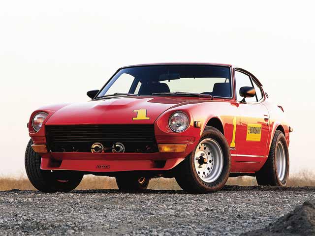

Style 2 would be my choice. I was looking at that wheel for myself but I couldn't find this wheel in the 15" size. Who's wheel is that anyway? There's a picture of an orange Z that an old race car driver uses to teach racing out in california. Unfortunately I can't remember his name but here's a picture of his car. I think this car looks pretty nice.
