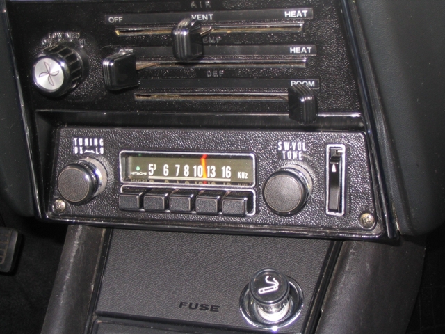

rtaylor Posted August 10, 2007 Share #1 Posted August 10, 2007 Some months ago I bought an AM radio from Ebay. When it arrived the faceplate had been broken in two. The break occured directly down the center of the amtena switch hole. And the bottom corners had been broken off at the screw holes. Additionally, all of the chrome letters had been worn off from 35 years of use.My original clock was not functional either (surprise). So I bundled both items up and sent them off to the master.I got both items back last weekend. I could not believe my eyes when I saw the faceplate. It was in one piece, the corners had been rebuilt, the broken faceplate was now one piece and the raised letters were now silver/chrome colored. It had been painted black and it matches the rest of the dash. What great craftsmanship!!!And, to top it off, the clock works! The expertise of our members and the willingness to help one other is what sets this club apart from the rest.Thanks E. Link to comment Share on other sites More sharing options...

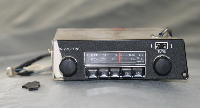

mally002 Posted August 10, 2007 Share #5 Posted August 10, 2007 Here is a picture of mine, can it be fixed? I have been searching for a faceplate for three weeks with no luck. I bought one off ebay that was described as "not broken" but of course it was. (seller did refund my money though)........So if that mystery person is interested let me know. Thanks, Randy Link to comment Share on other sites More sharing options...
rtaylor Posted November 27, 2007 Author Share #6 Posted November 27, 2007 Sorry for the delay in a picture. Just got my camera back from repair. Here is a picture of the repaired faceplate. The broken piece ran down the antenna slot, it was snapped off there. Almost identical to the break in your's Randy, but yours is on the left side where mine was on the right side. Also, both bottom corners were broken off and the embossed paint was worn off. As you can see, the repair is almost invisbile. The corners look like new. Saved me $400+ to buy a new radio. Link to comment Share on other sites More sharing options...

EScanlon Posted November 27, 2007 Share #8 Posted November 27, 2007 Randy;It is fixable. Haven't heard a definite date on the article in Nissan Sport.E Link to comment Share on other sites More sharing options...
