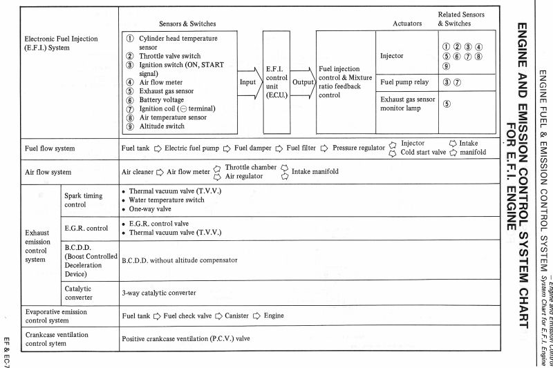

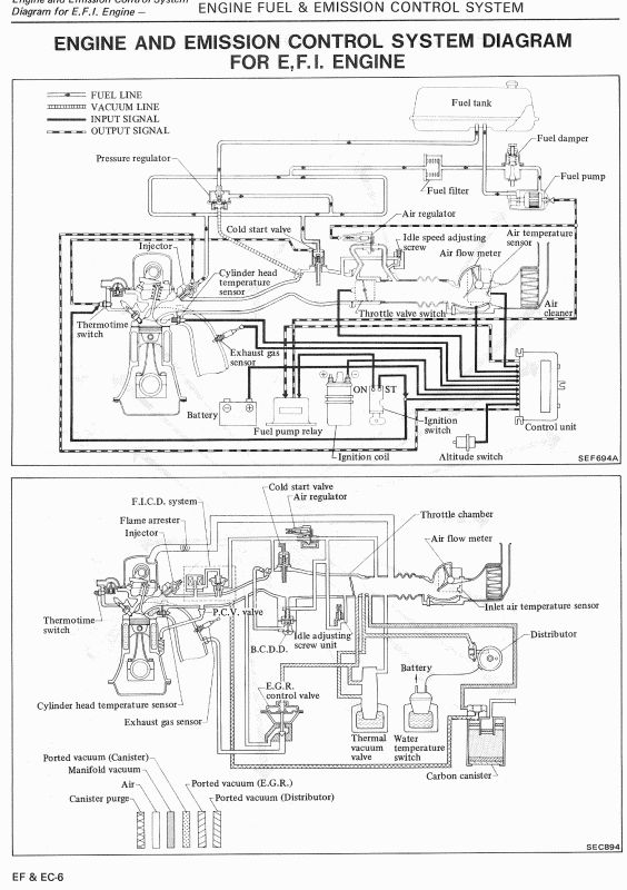

F.I.C.D. = Fast Idle Control Device. Basically what it does is speed up the idle when your air conditioning is on. I don't own a ZX. I have a 1978 280Z and a 1979 810. There are slight differences between the systems on my cars and ZX's. Also ZX's had two different engine control systems. The regular EFI system, and the ECCS system. I'm not at all familiar with the ECCS. It's more like a modern car with micro processors, crank angle sensor, air/fuel ratio feedback, more valves and sensors, etc. I'm hoping zbane will chime in here since he owns ZX's and seem to be quite knowlegable on them.

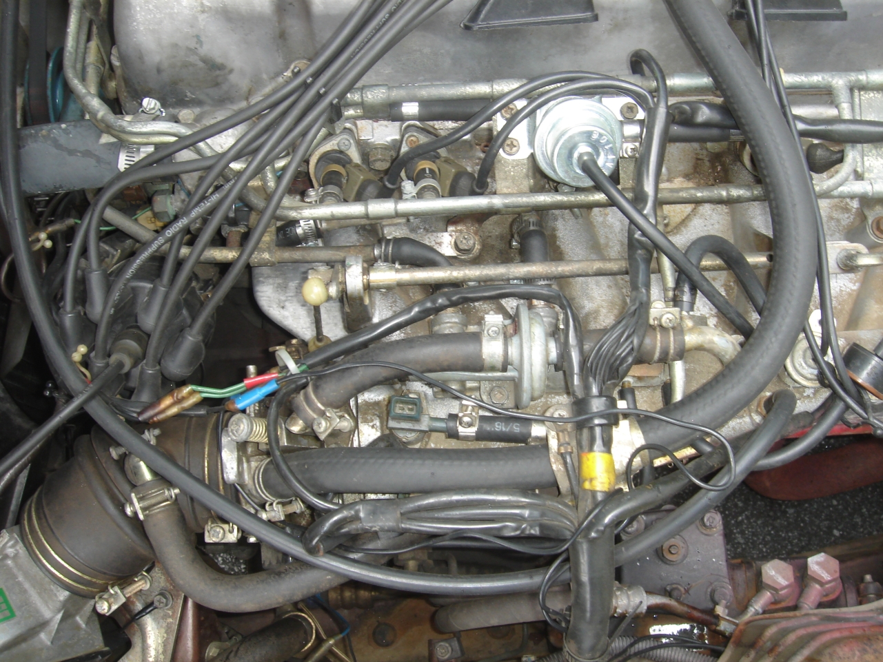

However, I can provide photos of a mostly not messed with 3ngine bay, so here are some photos of my engine bay (taken real quick 'cause I'm at work).
Looks like I updated my page and post after Will had posted his. Thanks for the diagram. I think that the 82 service manual I have is basically the same, so there we have it. I'll see what sense I can make of it and be back later. Thanks for the help.

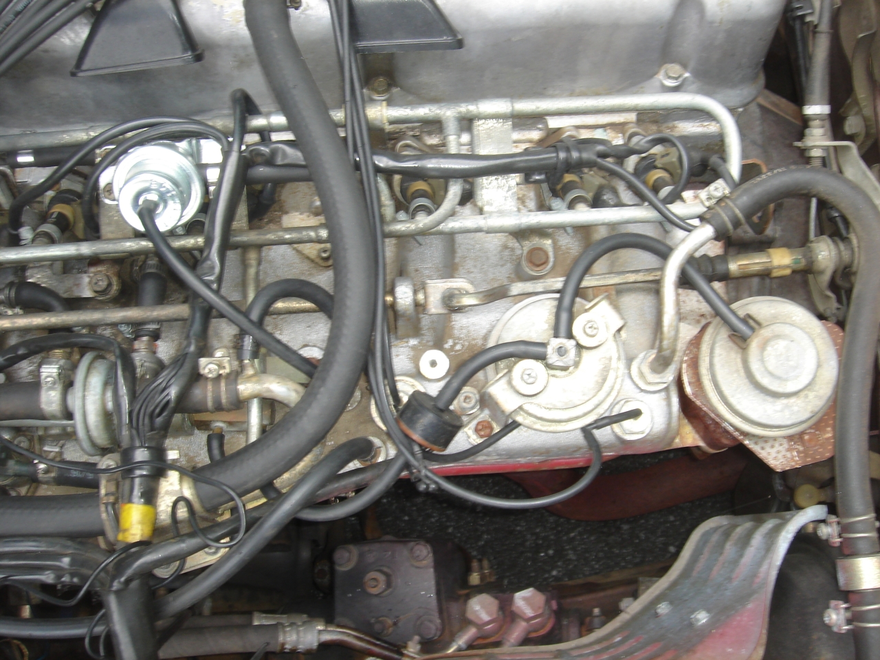

Here goes:
I took off the fuel rail to replace the injectors, so that is gone in the pics. The pictures posted are of the underside of the throttle, the vacuum advance, the EGR and surrounding vacuum connections, and then of the mysterious vacuum control module. How do I hook up the control module? It never appears in any of the service modules.
You can see in the pic of the EGR that I have some unused and badly plugged vacuum ports. Any idea of where they go or what was supposed to be there?
I checked the VIN and there is no "T" in it, so I don't think I have a hacked turbo.
Basically I need to see a good example of what a good vacuum routing looks like so I can compare it to mine.
Almost forgot. In the last picture you can see the vacuum control module. Is it needed? Why does it only appears in the routing diagram for the turbo model? In the manual I have it is supposed to go to the EGR as well as the auxiliary air control valve. It has four vacuum ports on it, so it is trying to be a big player in this vacuum system.
