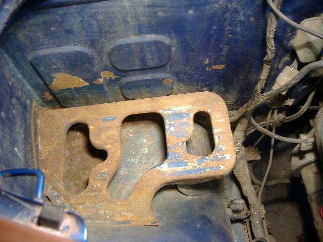

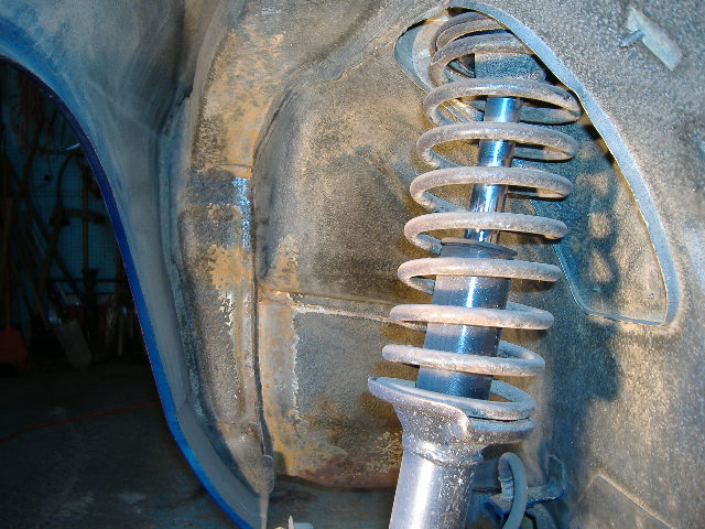

The amount of rust in and around the battery tray is the worst on the whole car. It shows the original condition, no corrosion down the side of the fender, because the old battery was in the plastic tray with drain. All of the metal is solid by the hammer or screwdriver test. I will neutralize the acid then a naval jelly (NAPA, pink) product, then see what is left, then protect.

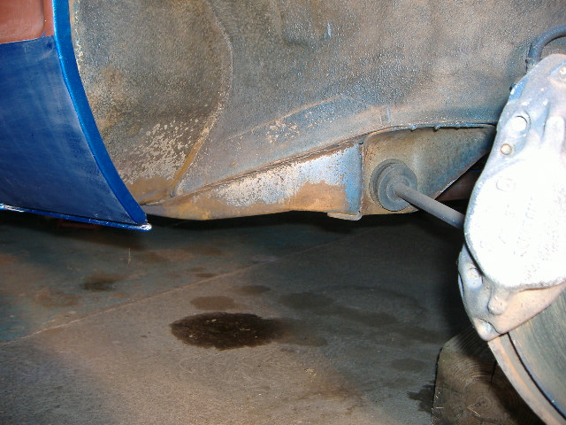

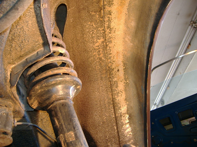

Looking through the headlight bucket shows a band of missing undercoating from road gravel rash the width of the tire or less. The metal showing has surface rust only. The driver side is about the same.

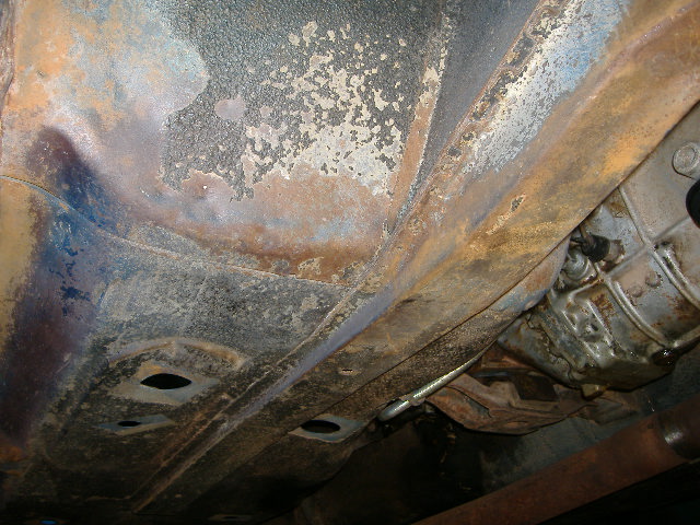

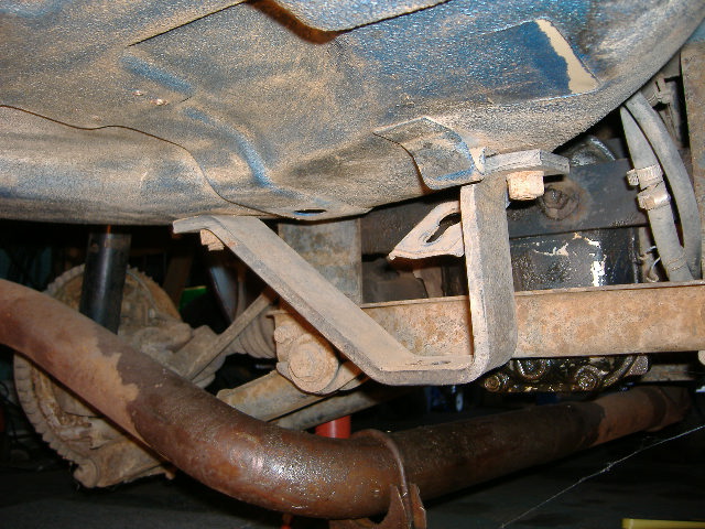

The passenger and driver floor pans and frame rails are the same. Both have the famous jack dents, (prolly me and PO):finger:, and yes that is original paint and primer on the side of the frame rails. These pics were taken after a complete wire brushing of the underside. Again, any rust is only on the surface.

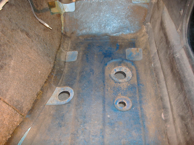

Both sides of the interior are the same also, there is no visible rust in here.

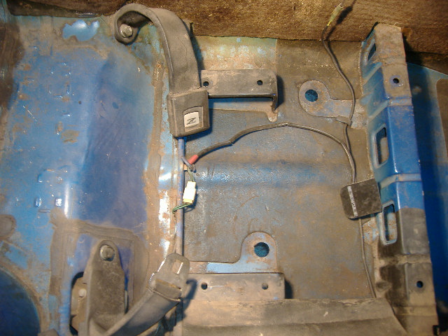

The rear fender area shows a smaller amount of missing undercoating, can't explain. Again, just surface rust. It looks rusty because it has a large amount of primer overspray. Lesson learned here? 1 OUNCE OF OVERSPRAY = 10 POUNDS OF OVERTIME!!!:mad:

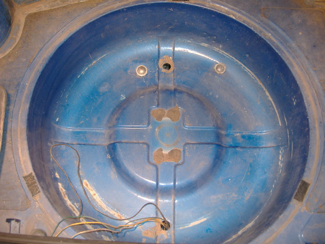

The spare tire area also shows the lack of any rust, although the spare did rub through the blue at the bottom of photo. This car also came with a trailer hitch, brace installed, tounge is 1/2 inch below the fuel tank and is supported by the bumper.

For being stored in the barn for 26 years your car has faired well. Just a matter of stopping the rust and protecting it, before it becomes necessary to replace metal. Those are nice pics. I wish people selling their Z's would include pics of this type of these areas. Good luck finding someone to shoot the color. Should be a real nice car once again.
