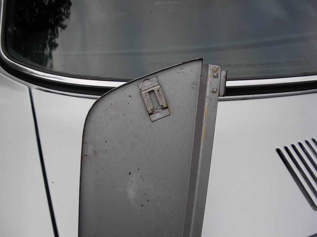

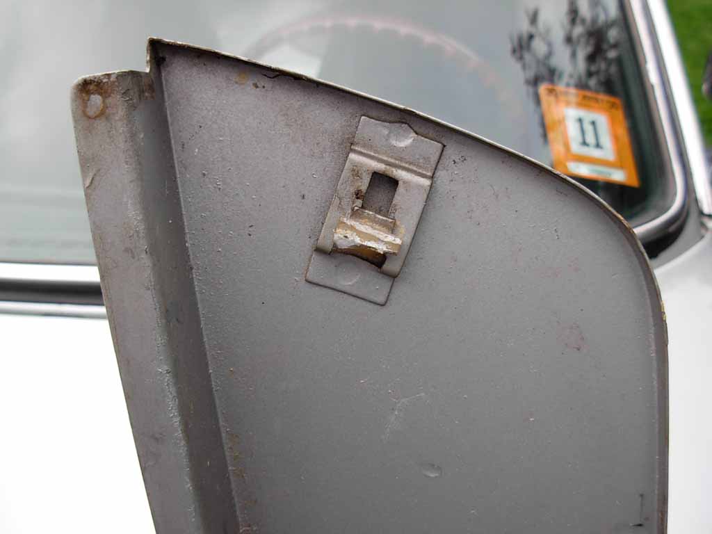

Apparently #237 has a riveted tab on the passenger side, but no tab on the drivers side. The drivers side looks to be original to the car.
I may also have found a place that can reproduce the plastic inspection lid clips. The problem is that the ones on my car are broken, so I need to find 1 or 2 unbroken ones to rent/borrow/buy so they can make a mold. If anyone is interested let me know.

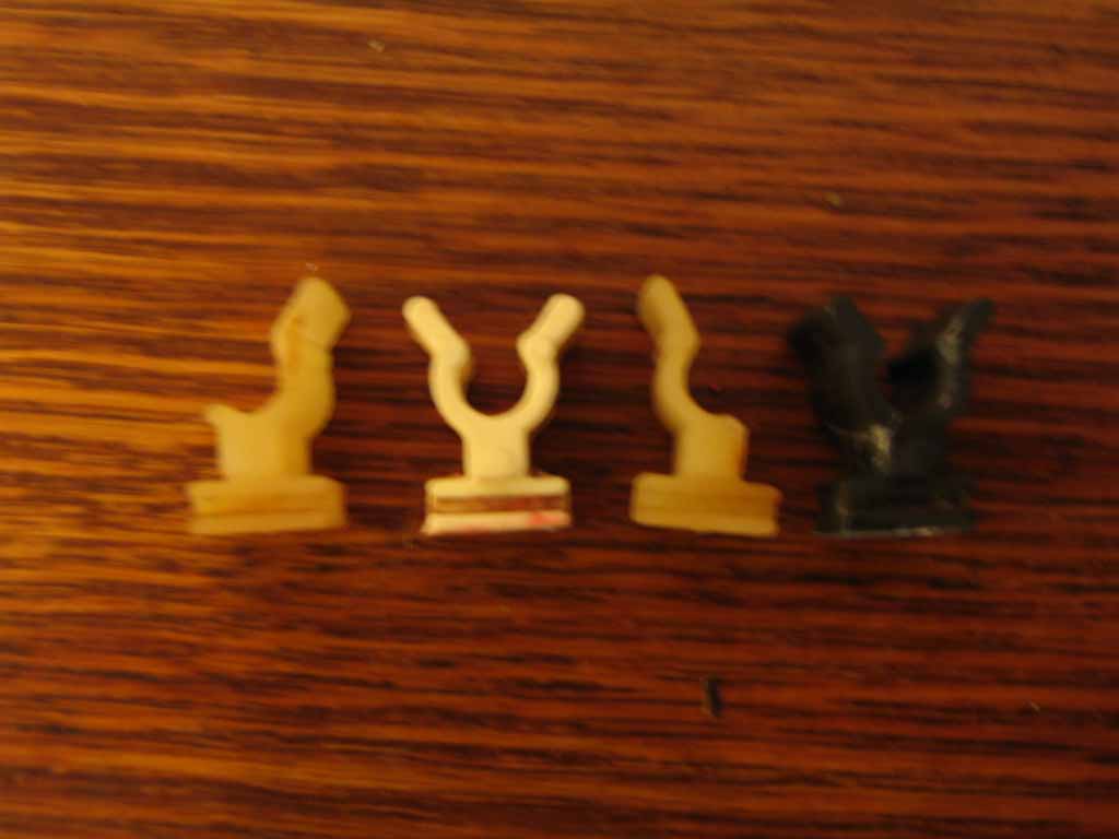

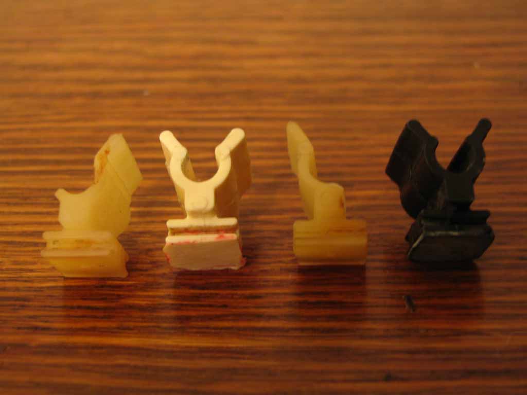

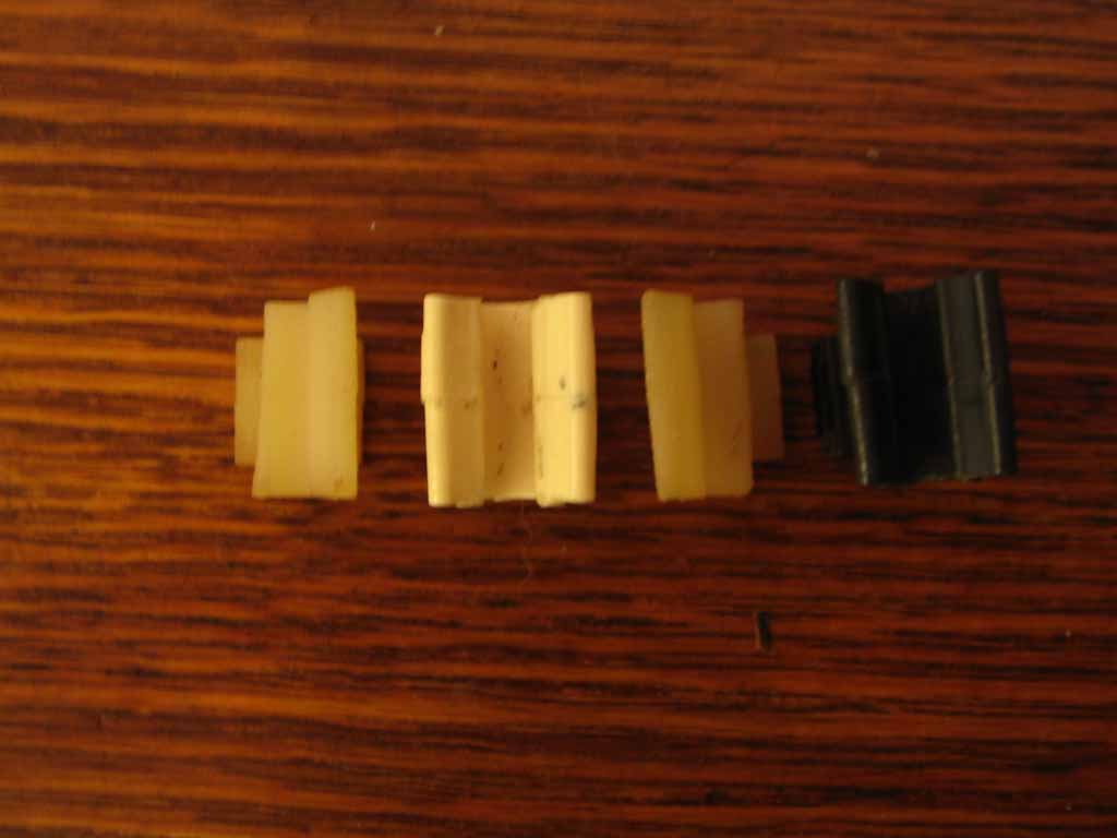

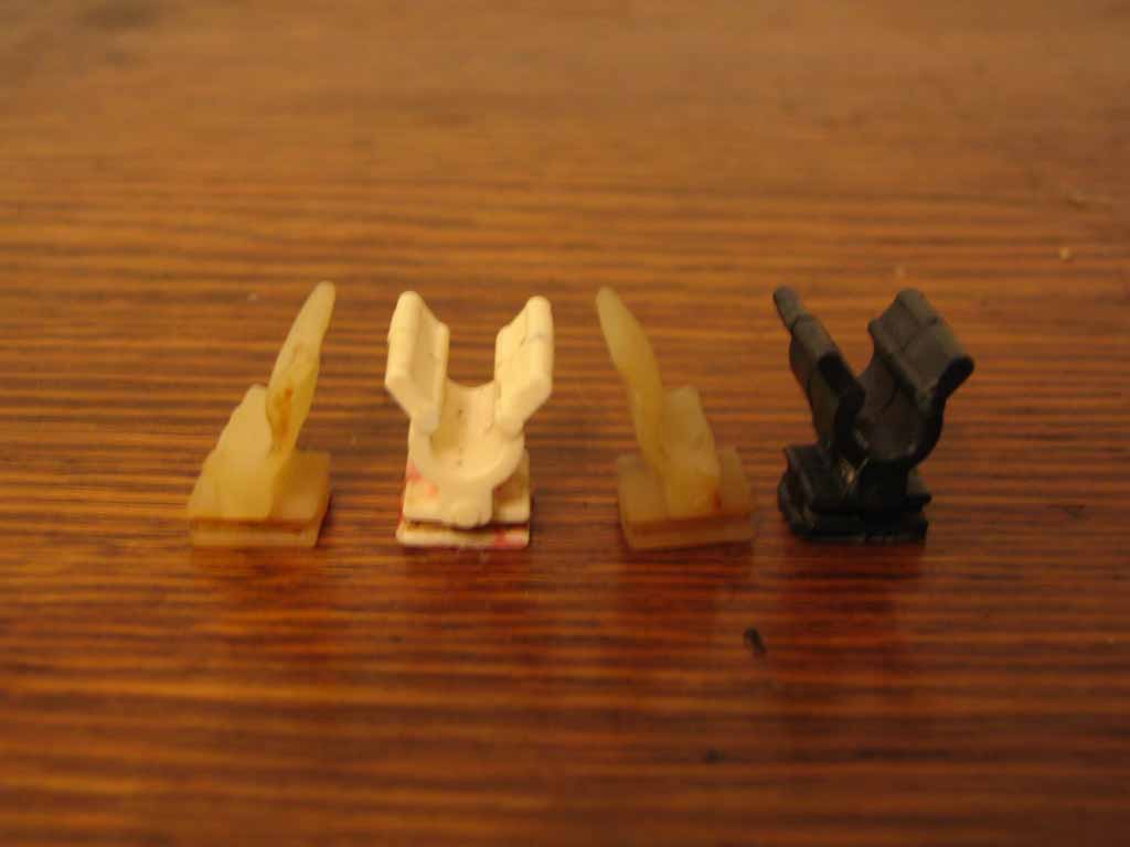

I was able to use the clip I borrowed from Fred to have a mold made and the test versions of the clips arrived today. It was too dark to take pictures mounted on the car, so I will have to do that tomorrow. Here are some pictures of the reproductions (in white and black) compared to two of my broken originals. I think they turned out very well and I should have some available for sale to anyone interested soon.
