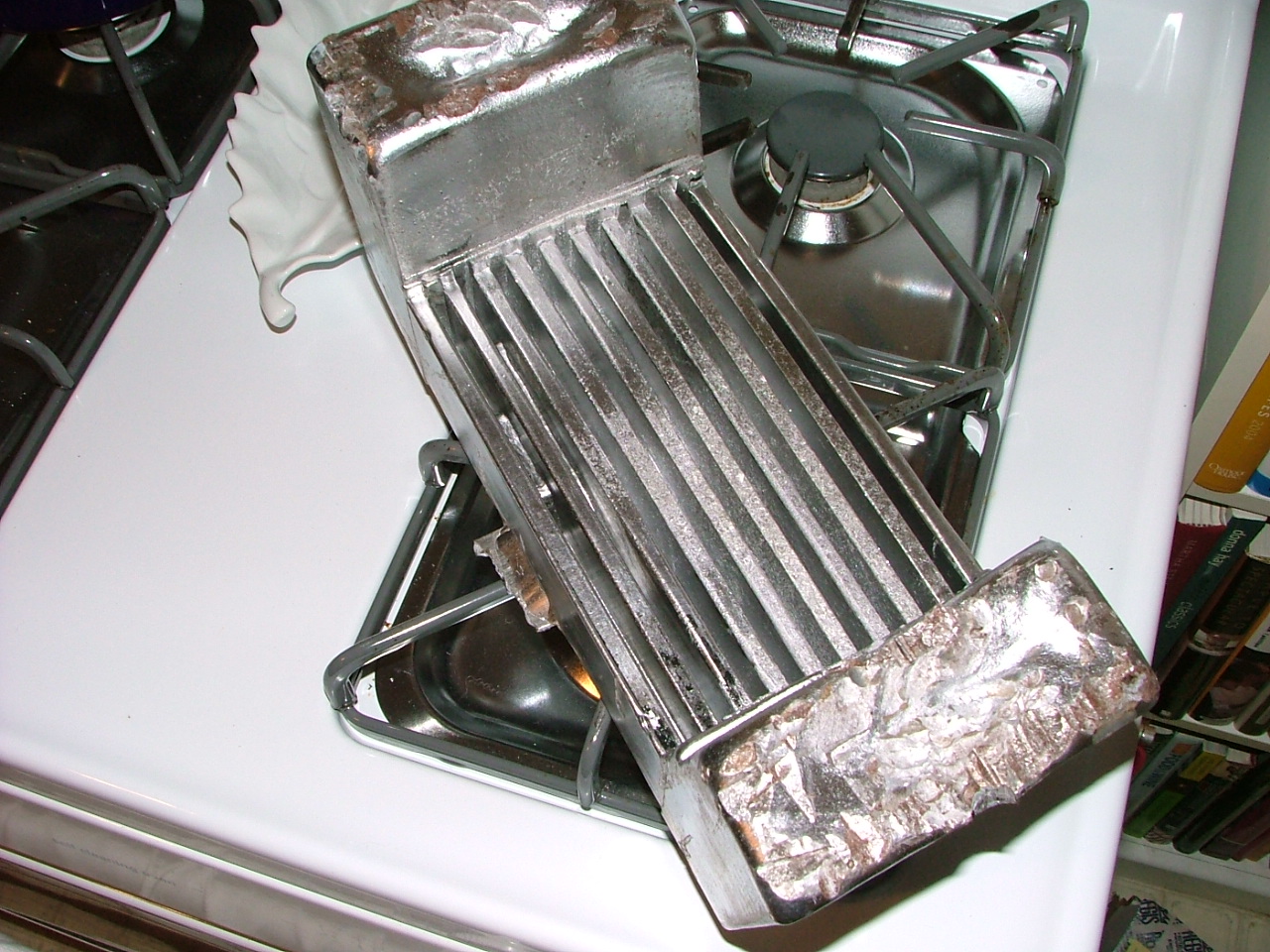

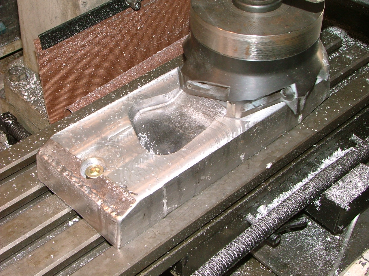

Here's a couple pics of some head castings I've made. They are for an L-head air cooled motor and are a far cry from the 24 valve I-6 undertaking. The fins could be smaller but I was using permanent mold. I'll do lost foam on the I-6 of course.
