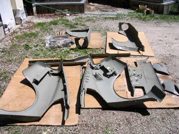

September 27, 200717 yr comment_222853 hls30.com said: The interior of the panels are different as well, there is a distinct "floor" in the fender area is on the earlier cars and on the later cars the whole area is closed from behind-still useable though modification is required.Will Here's a good pic of the insides of the quarter panels I swiped from the new "for sale" listing for #59 in the classifieds section. http://www.classiczcars.com/classifieds/showproduct.php?product=2206&cat=9&limit=recent Link to comment https://www.classiczcars.com/forums/topic/25676-280z-quarter-panels-on-240z/#findComment-222853 Share on other sites More sharing options...
September 29, 200717 yr Author comment_223102 moonpup said: Here's a good pic of the insides of the quarter panels I swiped from the new "for sale" listing for #59 in the classifieds section.http://www.classiczcars.com/classifieds/showproduct.php?product=2206&cat=9&limit=recentYeah, just saw those too, wish he was selling the parts separately. That's the first time I've seen a whole new quarter [but then, I've only owned my Z for three weeks now :classic: ] Link to comment https://www.classiczcars.com/forums/topic/25676-280z-quarter-panels-on-240z/#findComment-223102 Share on other sites More sharing options...
