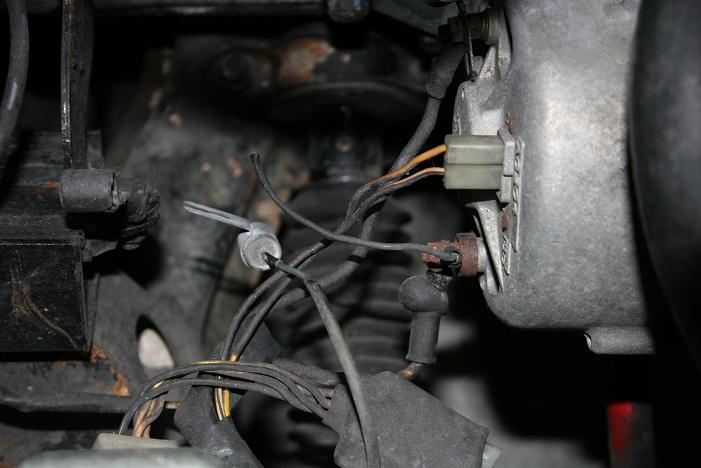

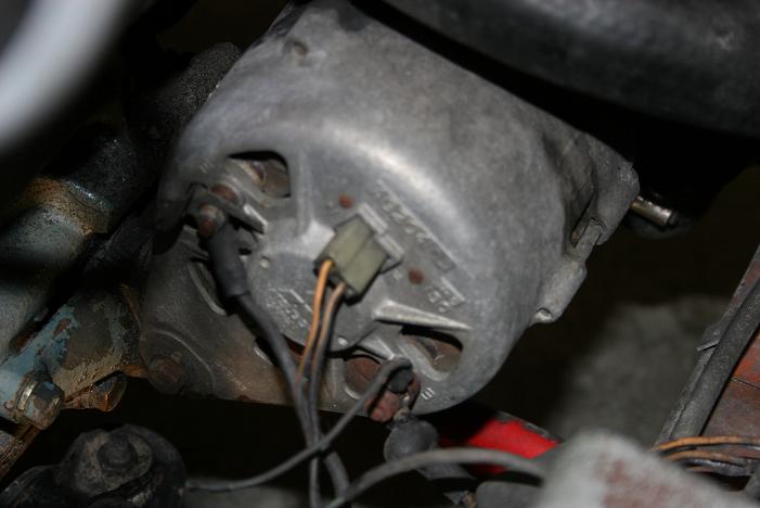

Earlier I posted about dim lights and motor hesistating. I started to begin removing the alternator and found a wire disconnected, and another "object" that I wasnt familiar with.
Is this a ground wire from the alternator and if so would it being disconnected cause the alternator not to work?
Also what is the other "object" that is attached to a wire, I checked my manual but didn't find anything. I hate to buy a new alternator if this might be the problem.....any thoughts.

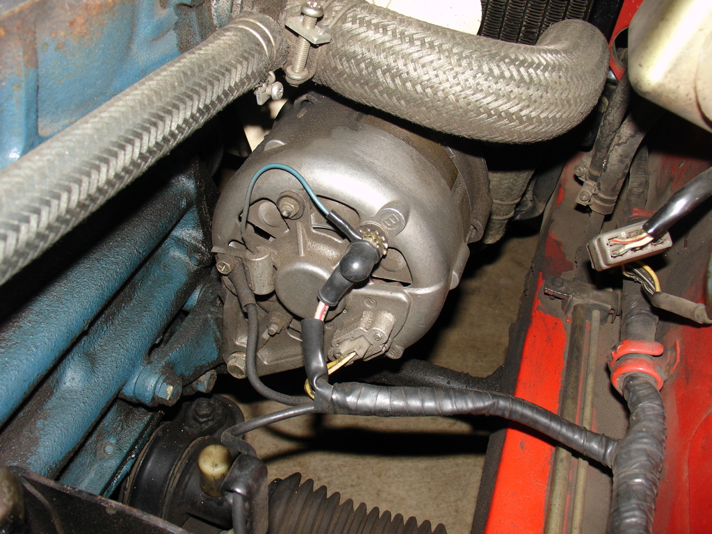

Don't know if this helps but here is a pic of mine. Large black wire goes into harness FWIW.

As Jimmy pictured, there should be four wires to the back of the alternator. The pair in the plastic connector, a white/red wire, and a heavy black wire that connects to the alternator case to ground it. The capacitor is not strictly necessary, it serves to suppress radio interference.

It looks like some previous owner had added a second lead from the Positive Post. This is usually done to channel power directly to the battery (rather than having it all go though the cars wiring harness - when super amplifiers are added etc.).
Looks like someone just cut it off, rather than removing it from the Positive Post....
If that's the case, just remove it from the Positive Post on the Alternator and discard it.
A clear picture looking at the rear of the Alt. would be better...but the above is what it "looks like" to me.

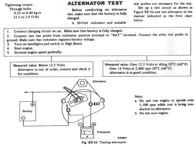

As I noted above, and the attached picture shows, there are only 4 wires connected to the alternator from the factory. The two small wires in the plastic T-connector, a large white/red that connects to the 'B' terminal, and a large black that connects to the 'E' terminal ('E' for Earth or Ground). The condenser (if present) bolts to the ground with the black wire, and its wire goes to the 'B' terminal.

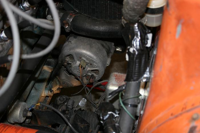

I, of all fricken people (Stereo installer by trade) have engine noise but did'nt get it until I installed the ZX alternator into the 240Z.

The 'E' terminal is a ground, as stated earlier. Since the in car test is conducted with a voltmeter with the positive probe on the 'BAT' terminal and the negative probe on the 'E' terminal, I'd say that bottom black wire needs to be grounded.
