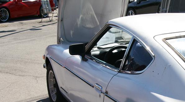

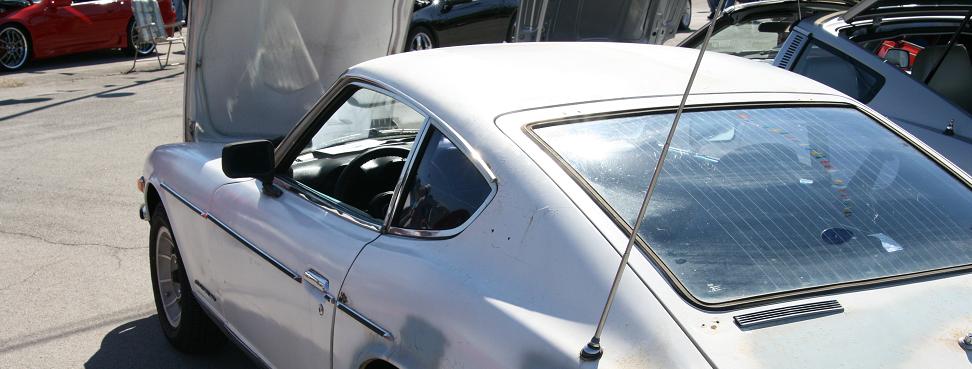

Don't know if this helps or if you can even tell but here's a picture of #797 that I took at our Z car show, it looks tinted to me but can't be sure.
Randy
Thanks Randy. It is hard to tell from the pictures. Even if they were dead on from the side the tint isn't very dark, so it isn't real noticable unless you compare the two side by side. I'll take a picture of the tinted and untinted door glass and post for comparison. I think the best way to tell is comparing the numbers etched in the glass (M-214 or M-224).
