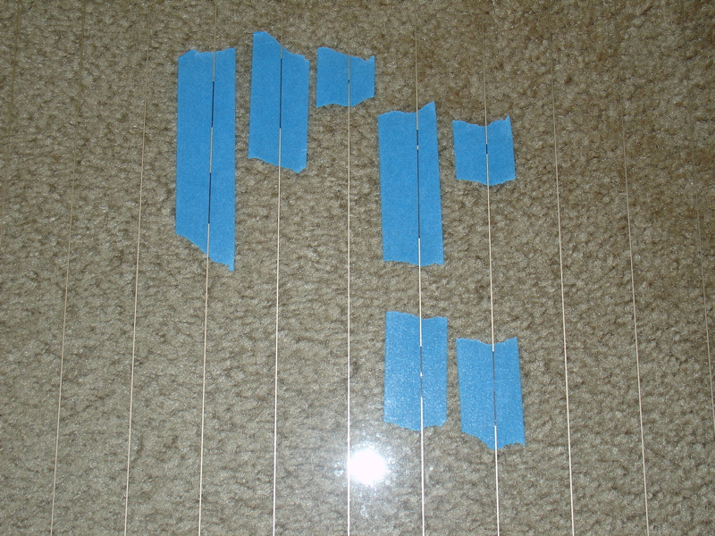

Well Stephen, I just re-did the grid on my car this weekend, because the early style windows with vertical grid-lines haven't been available for quite some time. I used a two-part epoxy designed for this task, and it seems to have worked quite well.

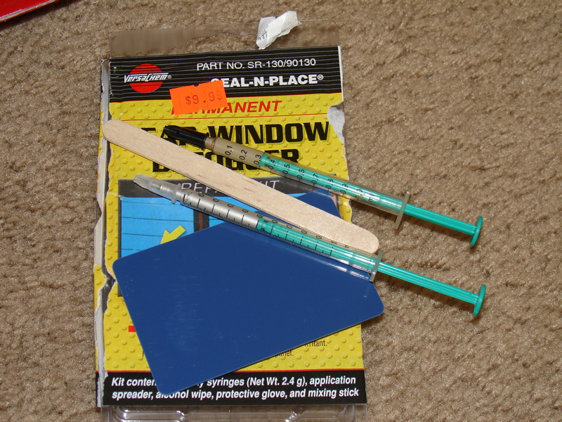

The product I used was from VersaChem, Epoxy Rear Window Defogger Repair Kit, part #SR-130/90130. It included two prefilled and measured syringes with the A and B compounds, a wooden mixing stick, an alcohol wipe, and a plastic spatula to apply it. The instruction recommended masking the gridlines with ordinary scotch tape and then applying the epoxy. I liked the idea of the epoxy better than the normal conductive paints I've seen, and the kit says that the epoxy will repair damaged lines up to 10" in length and can also be used to reattach terminals.

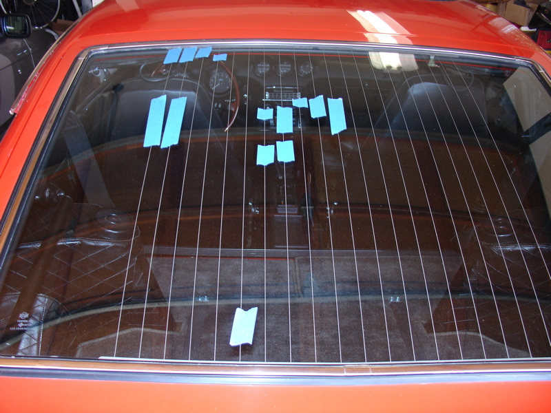

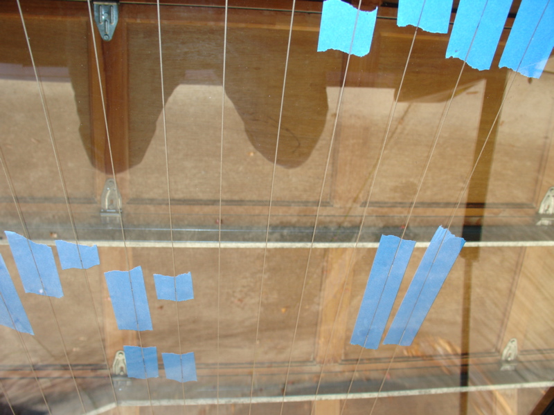

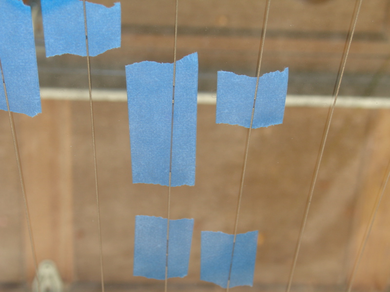

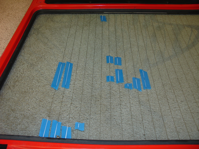

In the pictures below you can see the missing grid areas, which I marked by applying blue masking tape to the outside of the glass. I then removed the hatch so that I wouldn't be trying to do this while lying on my back in the car.

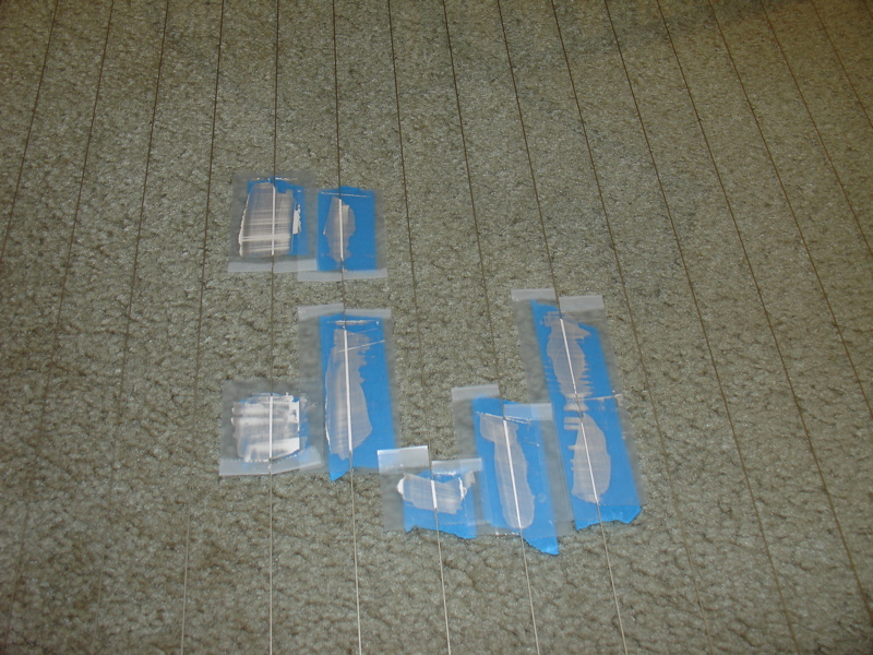

After masking with the scotch tape, I mixed the epoxy. The kit says you have 25 minutes to work with it. I found the spatula was too wide to do the right job (it bridged two gridlines), so I cut it in two with a scissors. After applying a thin amount to the damaged area (the thickness of the scotch tape), I let it skin over for about 5 minutes and then removed the scotch tape and put the hatch back on the car.

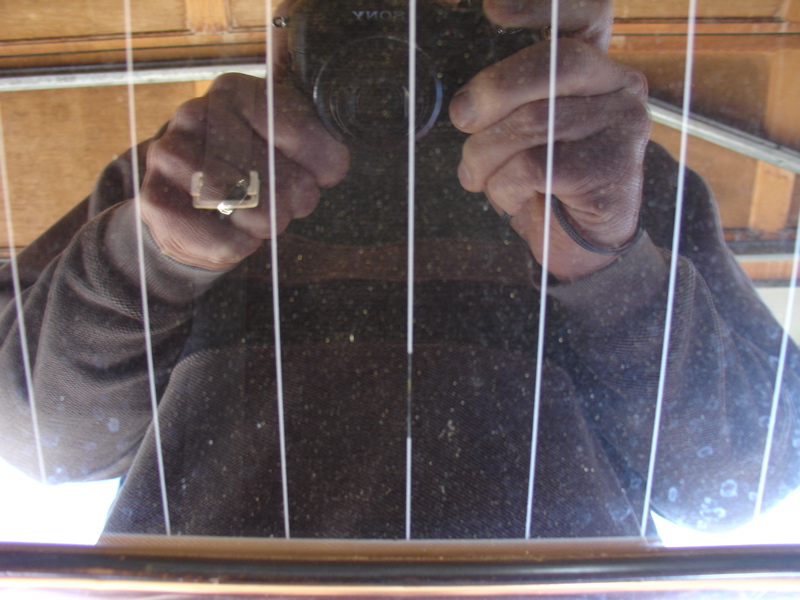

The final picture shows the repaired areas as quite light in color, but that is only visible from certain angles. In the mirror, or from the outside they are almost invisible.
The instructions say you can apply current immediately, which will actually accelerate the cure time. Without any heat, allow 24 hours for it to fully cure.
I tested it today, and my grid seems to work like new. I spent $10 on the kit.
