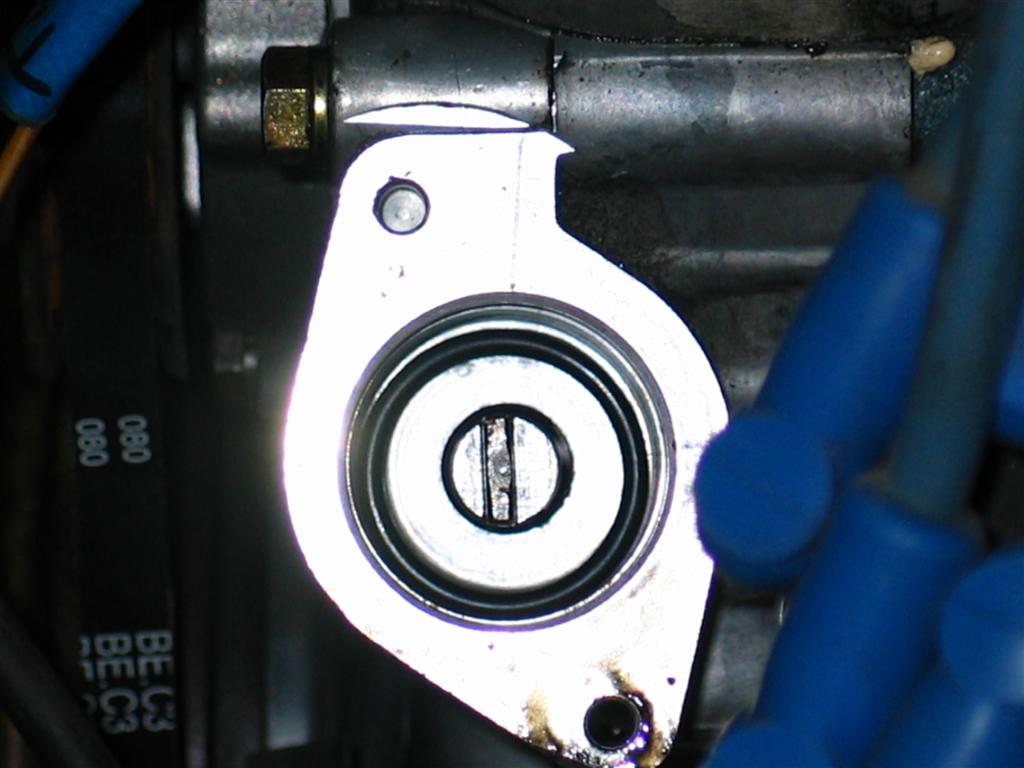

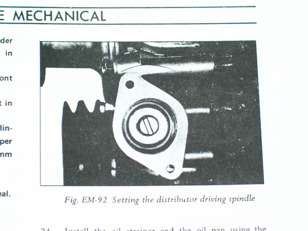

November 8, 200717 yr comment_227807 It appears from the photos of the book and actual tang position that you're off a tooth clockwise. I'd reposition the shaft.I had a similar experience with my L24 about 5 months ago. Regards,Frank Link to comment https://www.classiczcars.com/forums/topic/26039-troubleshooting-advice/?&page=2#findComment-227807 Share on other sites More sharing options...

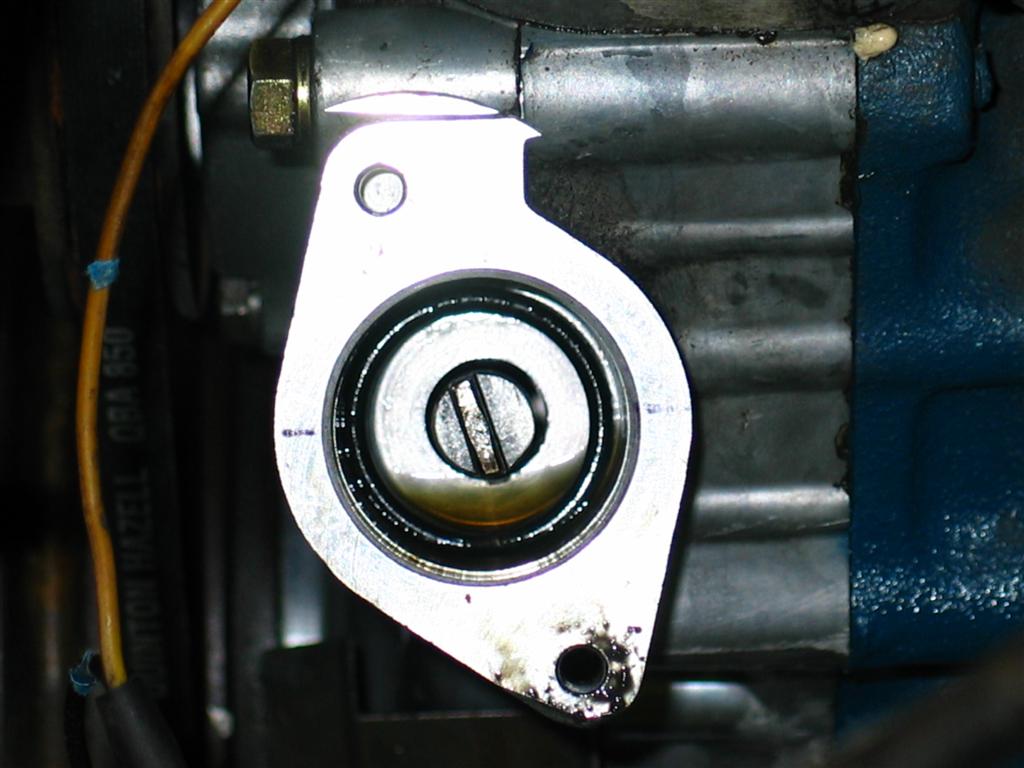

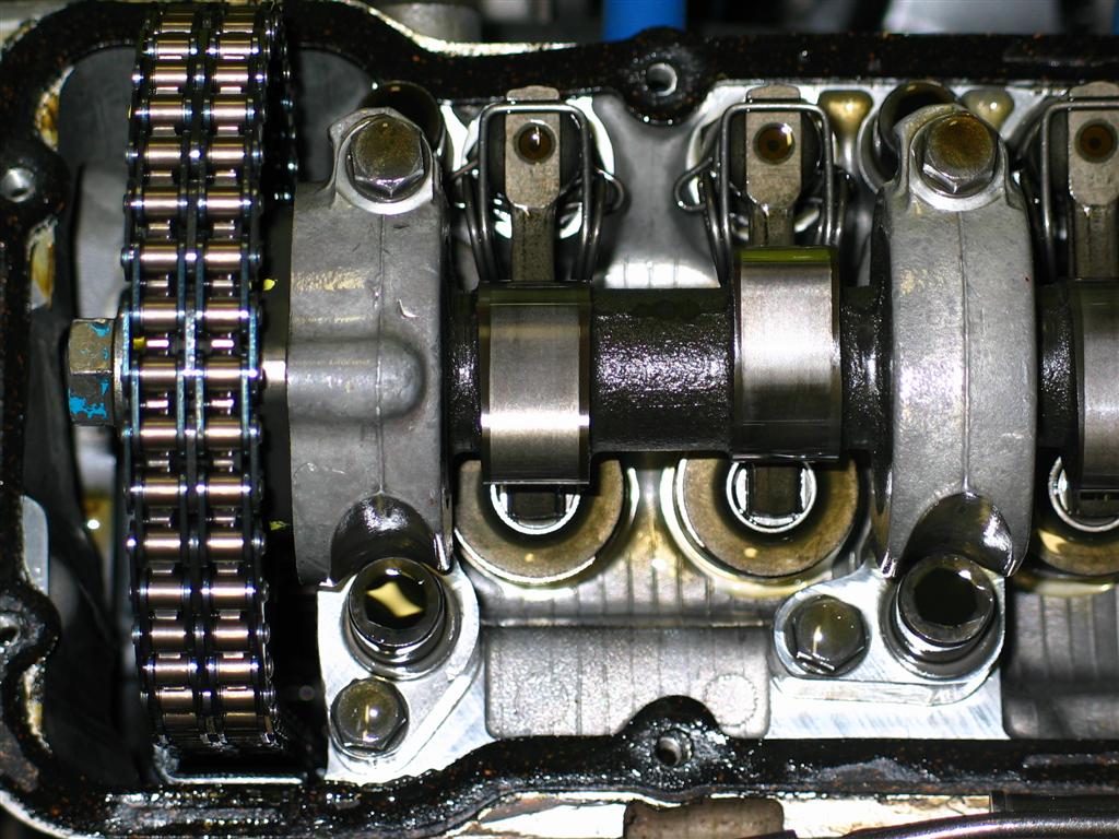

November 12, 200717 yr Author comment_228317 Finally got some time to correct the distributor spindle tang. Turned ACW one tooth and it looks much better. In golf terms that would be a "right edge" putt with the upper screw hole the target and looks more like 10:30 o'clock than 11:25....but whatever. Fired up with a little coaxing (overcorrected timing from the prior tang orientation) and once the timing was readjusted the engine ran very well. It settled into a mild loping idle from the non-stock cam with a pleasing rumble from MSA's new premium exhaust system. Vacuum advance mechanism works well, now just to synch up the carbs, install the windshield (er..have it installed:finger:) and I'll be driving the Z this week! The pics below consolidate the situation...#1 is initial orientation, #2 is the book's depiction, #3 is the corrected position. #4 is there to show TDC at #1 cylinder. Thanks for the help! Steve Link to comment https://www.classiczcars.com/forums/topic/26039-troubleshooting-advice/?&page=2#findComment-228317 Share on other sites More sharing options...

November 12, 200717 yr comment_228335 Glad to hear that you've got it under control. Your pic #3 looks just like the one I posted in post #9. The first L series I ever worked on was a 69 510. 4 cyl but the same premise. I must have moved that spindle 10 times before I was able to get everything in the right relationship. That was about 38 years ago so I've had a lot of practice. Nothing else seems to work right until that is properly set up. The '11:25' thing can be confusing. To me it's just a visusal thing. I know when it looks right and when it doesn't so I never run into that problem anymore. Link to comment https://www.classiczcars.com/forums/topic/26039-troubleshooting-advice/?&page=2#findComment-228335 Share on other sites More sharing options...
