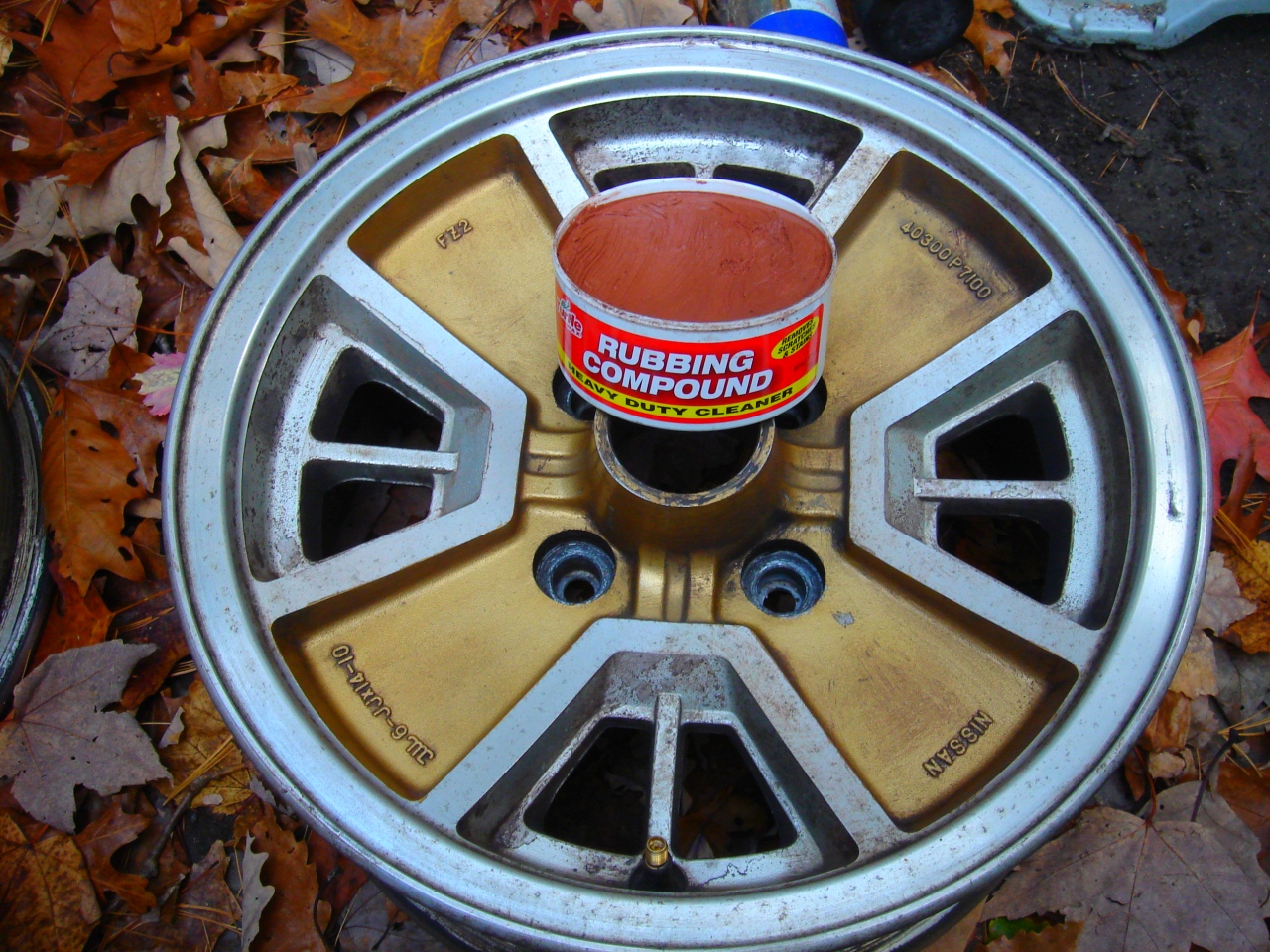

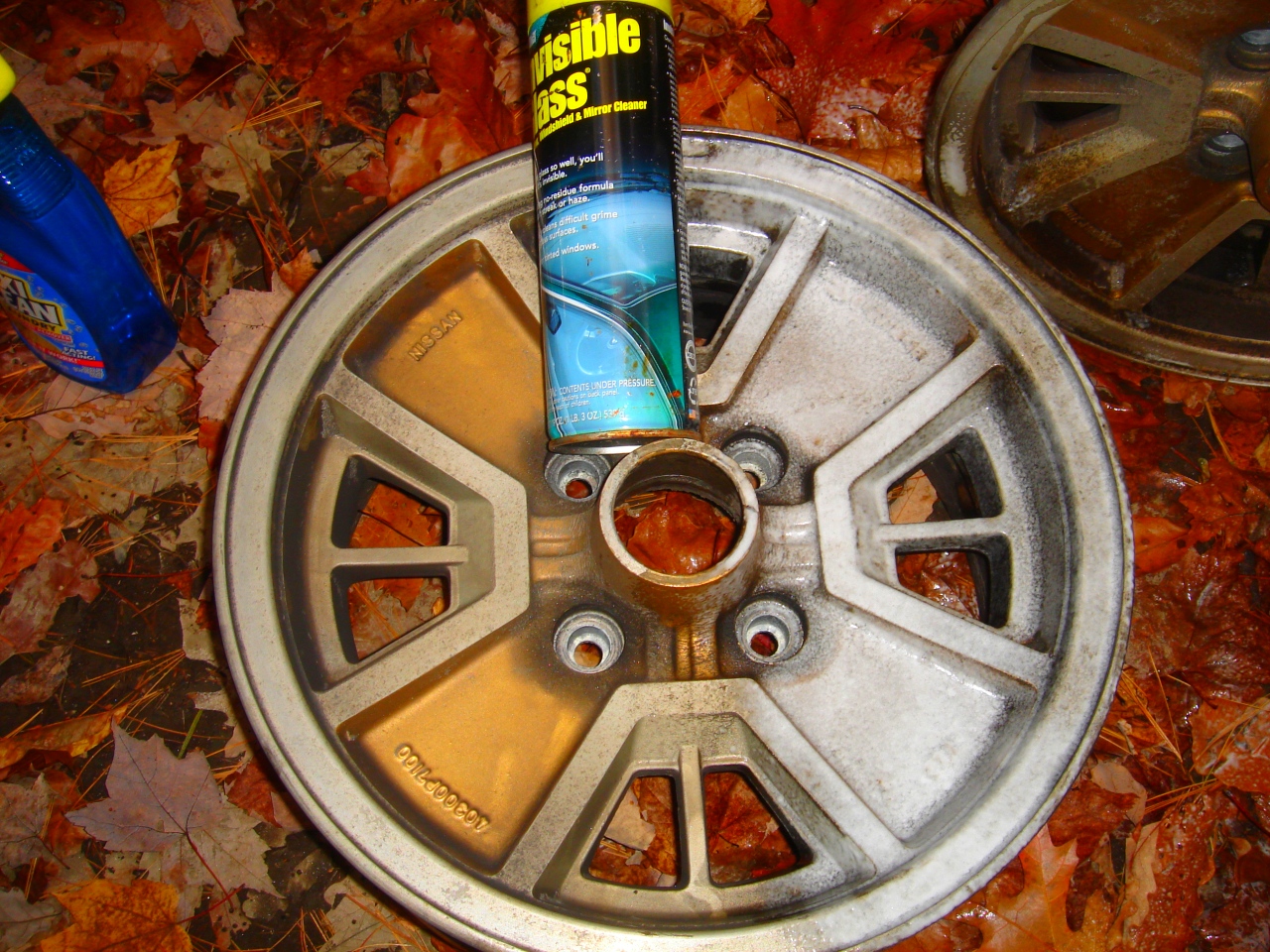

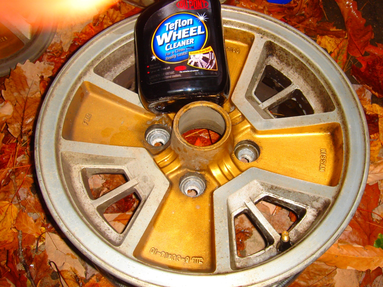

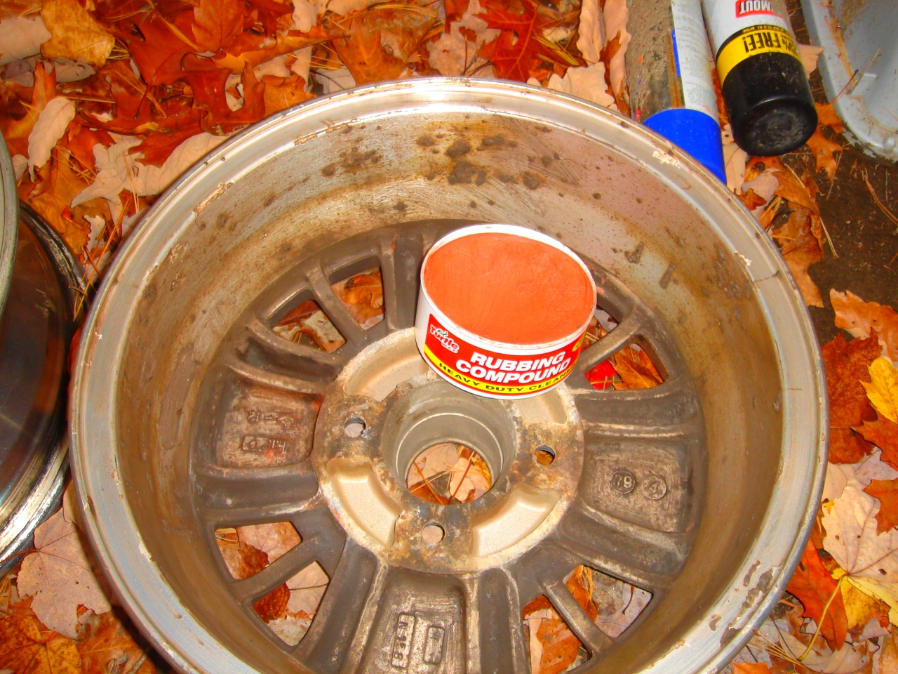

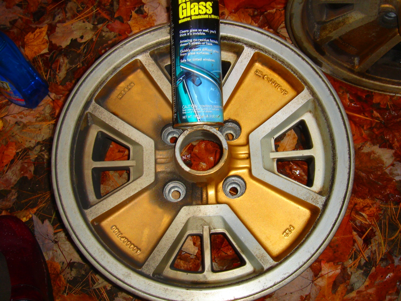

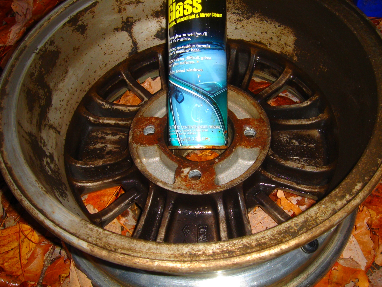

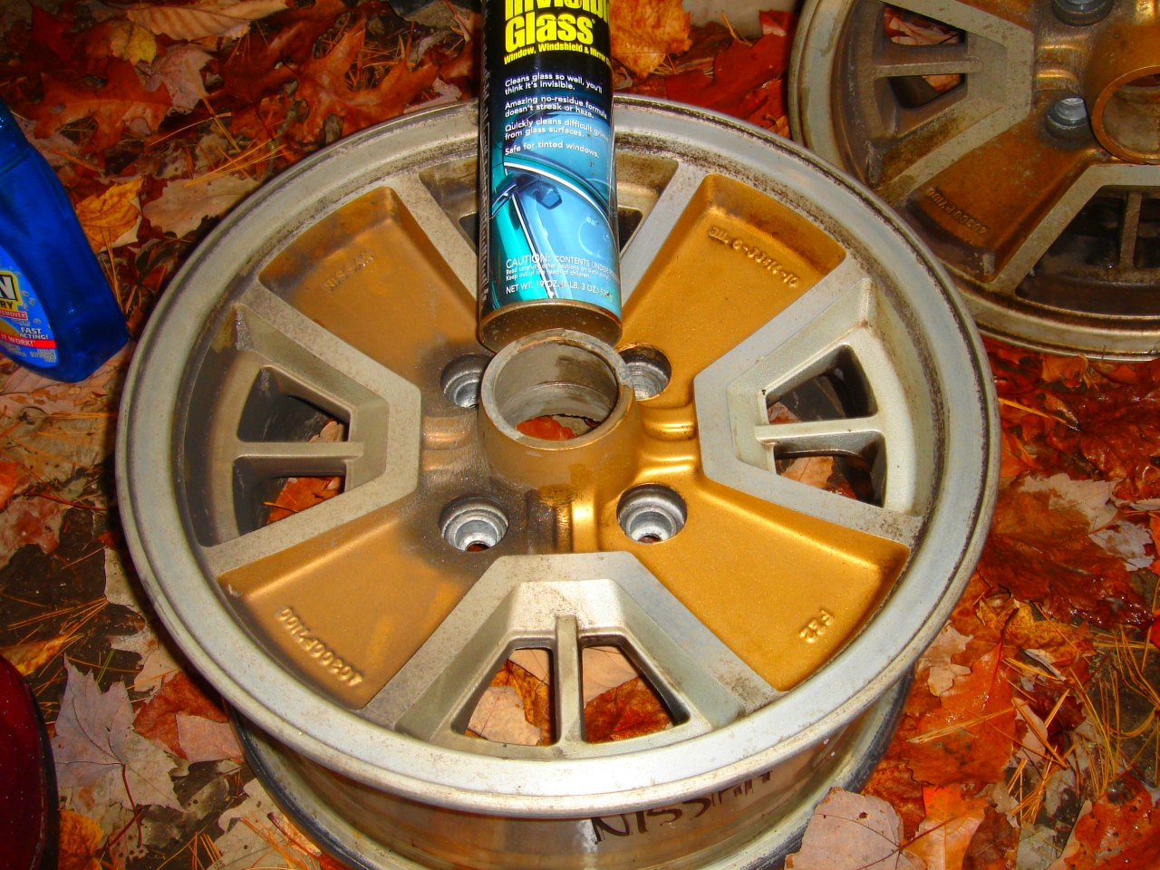

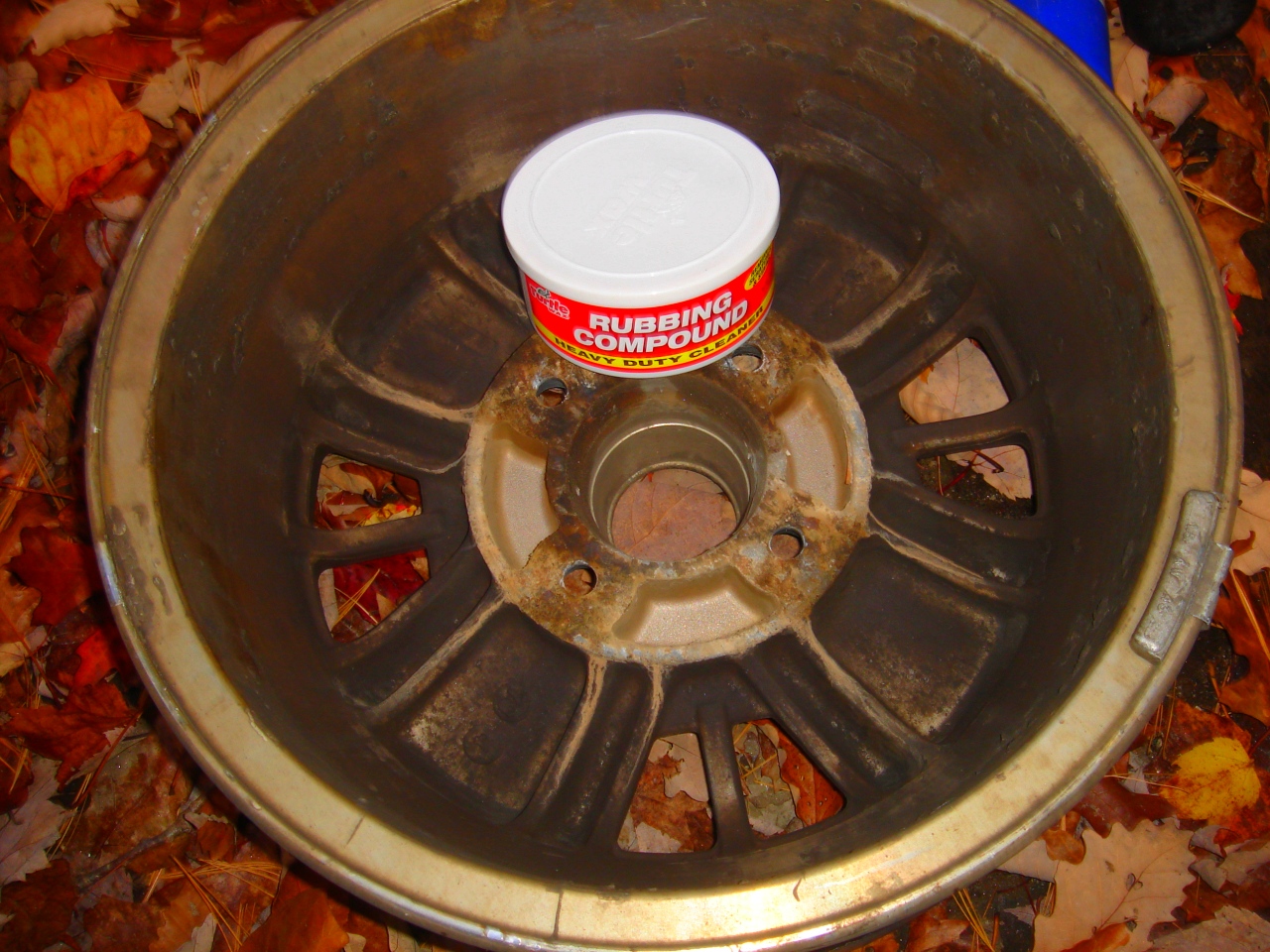

Posted November 3, 200717 yr comment_227098 Since I just replaced my stock rims with Westerns, I figured I would clean up my old (once shiny) "Iron Crosses." I have accumulated a variety of cleaning supplies for various uses, and thought I would document several of the cleaners I have. Here is what I have found: In the first 4 photos I used Turtle Wax Rubbing Compound. It did a good job, but did require a bit of scrubbing. The next photo show DuPont's Teflon Wheel Cleaner. It did nothing on the nasty accumulation but get it wet, and wash off some of the loose stuff. The last photos show a promising contender for the "most versatile cleaner" award- Stoner's Invisible Glass! Note the inside of the rim- the parts that are fairly clean pretty much cleaned themselves. I had sprayed the stuff on the inner rim (only half), and flipped the rim over. A couple minutes later, I flipped it again, and much of that stuff just slid off. A little wipe, and much more wiped away. Next time I'm at the store, I plan on getting another can of spray, apply it, clean the majority of stuff off, and then attack the truly stubborn parts with the rubbing compound. Just thought everyone might like to know that you don't have to buy the expensive wheel cleaners. Nothing against the DuPont stuff, I imagine it is more for light cleaning of brake dust, not serious road grime. And by the way, the Oxy Clean seen in the edge of a couple photos didn't do anything (didn't think it would, but you never know). Link to comment https://www.classiczcars.com/forums/topic/26102-cleaning-rims-an-experiment/ Share on other sites More sharing options...
