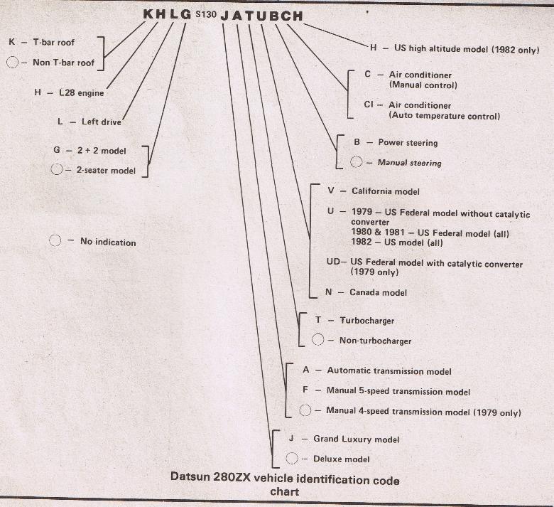

Posted November 5, 200717 yr comment_227372 I have looked and tried to find the decoding for the VIN of this car but I can't find any info on it. This car 1980 RHD 280ZX is on ebay right now, very cheap thus far, and I was wondering what can be found out from the VIN above?Link to auction http://cgi.ebay.com/ebaymotors/ws/eBayISAPI.dll?ViewItem&item=230187076332&ssPageName=ADME:X:RTQ:MOTORS:1123I'd be interested in it to have a 2nd Z car, the RHD is just a bonus. also is there a way to know what rear end would be in this car or the final drive ratio? Link to comment https://www.classiczcars.com/forums/topic/26124-80-280zx-rhd-hgs130002146/ Share on other sites More sharing options...
November 5, 200717 yr comment_227397 This might help. Don't think it will give you the rear end though... Link to comment https://www.classiczcars.com/forums/topic/26124-80-280zx-rhd-hgs130002146/#findComment-227397 Share on other sites More sharing options...
