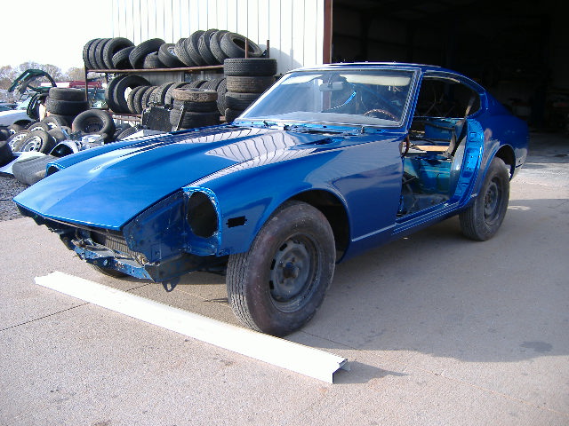

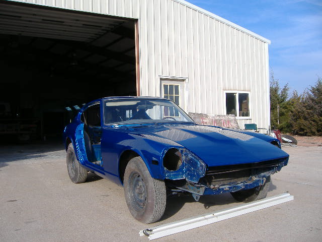

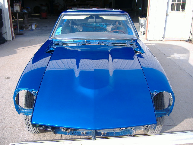

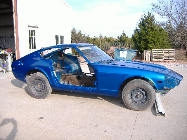

Posted November 12, 200717 yr comment_228265 "Painter Ray" and myself put the last coat of clear on Friday night at 11:30. We brought it out in the sun saturday afternoon for these photos. Now for final sand, buffing and assembly. I wonder if I will remember how it goes back together after taking it apart 27 years ago? Having it finally painted after all these years, is a shock to my system to see it all one color and this BLUE. I am very happy with the way it turned out. Bonzi Lon Link to comment https://www.classiczcars.com/forums/topic/26197-bonzi-turns-blue/ Share on other sites More sharing options...

November 12, 200717 yr Author comment_228329 Thank you all for the compliments.gogriz01: The color in not EXACTALLY 115 Blue Metalic, but "Painter Ray" found a chip in his system from a 1991 Chrysler Import called Fiji Blue Metalic, real close. We mixed it and not quite right so we tweeked it a little (extra silver metal and pearl) and came up with this, a few shades darker and brighter than what we could find next to original. We dubbed it " 115.5 Bonzi Blue Metalic". Mixing samples can get expensive, so choice WAS made.Big Oak: I hope it never looks like that again, that took 27 years.d240zx2: Painter Ray would of done it any number of ways depending on amount of time=cost. I'm on a budget so fenders and hood stayed on. Doors and hatch were removed to spray the jams in and out (were black, don't ask), the hatch was painted at angle and the doors were upright. The scoops were already off and he took the inspection lids and gas door off to get evey edge on these.280~Master: I know we will find someplace we got light, I have a pint left.Justin260z: The only real way to tell is put both side by side, but I bet there is some difference, the chances of being spot on is astronomical. I'd really like to see group of blue Z's just for the shading, tones and hues, let alone shine, metalics and pearls.Thanks again, Bonzi Lon Link to comment https://www.classiczcars.com/forums/topic/26197-bonzi-turns-blue/#findComment-228329 Share on other sites More sharing options...
