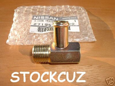

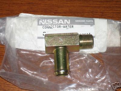

Posted November 20, 200717 yr comment_229185 I'm trying to find the name of this part and it's part number hopefully. It bolts onto the side of the Thermostat Housing on a 1977 280Z, (California Model if it makes a difference). Looks like a water inlet elbow like this one on Ebay for a 520 and 521 pickups. It's also shaped exactly this one right here. ~Z~ Link to comment https://www.classiczcars.com/forums/topic/26292-whats-this-part/ Share on other sites More sharing options...
November 20, 200717 yr comment_229189 I'm not certain, but it looks like the same elbow that goes into the rear of a 240Z cylinder head, just below the #6 spark plug. If so, the part number is 27195-E4400, my dealer charged me less than $7 for it last year (club discount). Link to comment https://www.classiczcars.com/forums/topic/26292-whats-this-part/#findComment-229189 Share on other sites More sharing options...

November 20, 200717 yr Author comment_229192 I'm not certain, but it looks like the same elbow that goes into the rear of a 240Z cylinder head, just below the #6 spark plug. If so, the part number is 27195-E4400, my dealer charged me less than $7 for it last year (club discount).that's what i was thinking...Yeah thats what the Ebay guy said it was too, except the part I'm talking about is about 1/3 that size but the same shape and look.It bolts on the lower half side of the Thermostat Housing Block with a 2 inch rubber hose coming off it connecting to the Fuel Rail area. Link to comment https://www.classiczcars.com/forums/topic/26292-whats-this-part/#findComment-229192 Share on other sites More sharing options...
