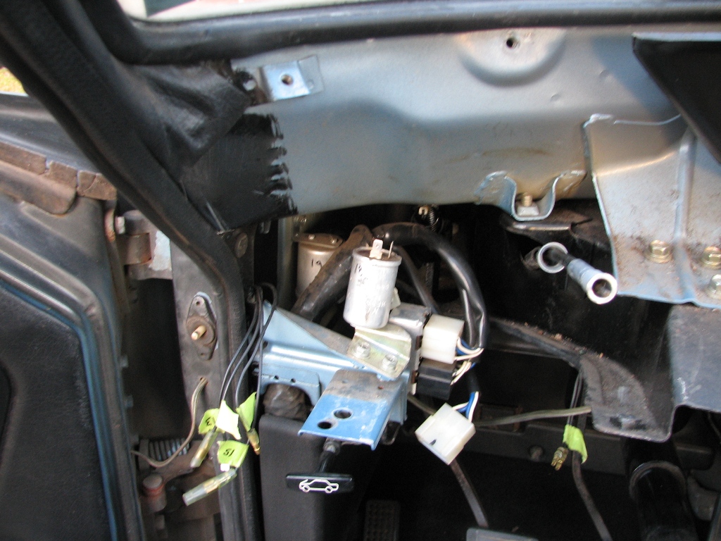

There are 2 flasher units under the dash. Did you check both of them? They are both on the left side. If your flashers are out then here is where they are. Start at the basics. Fuses, Flashers, Hazard Switch, Wiring, Turn signal switch ect. Take a look at the pic for placement.
I mentioned that in my other post and I was going to attach a picture until he said:
I had replaced the hazard flasher, I didn't see the turn signal flasher. I swapped out the new flasher for the turn signal flasher...
