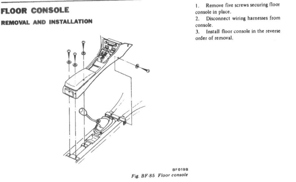

November 24, 200717 yr Author comment_229587 It's seems stuck solid at either side of the shift boot just below. The plastic is old and brittle and I'd hate to crack it removing this thing. My Haynes manual only shows a console diagram from a 240 and the 280 is different. We found 2 screws on either side up under the dash, 2 more at opposite end of the console in the storage box, but thats it so far. Took out the ash tray and couldn't find any clips or screws there. Do I need to remove the leather bonnet around the stickshift to get into underneath there to get at more screws or clips?Any help would be great. Thanks!- John Link to comment https://www.classiczcars.com/forums/topic/26328-1978-console-removal/#findComment-229587 Share on other sites More sharing options...
November 24, 200717 yr comment_229594 There should be three screws in the storage box, two at the rear and one at the front. Lift it up, unplug the ashtray light and the lights/switches below the radio opening and it should lift out. Link to comment https://www.classiczcars.com/forums/topic/26328-1978-console-removal/#findComment-229594 Share on other sites More sharing options...
November 24, 200717 yr comment_229598 I just removed mine recently. There are two screws up front, on the side near the radio. As I recall, there are four more screws in that area which hold the radio mounting bracket to the console. Don't need to remove those.Then there are three screws in the storage compartment. That is it except for the wires that need to be unplugged.Good luck!John Link to comment https://www.classiczcars.com/forums/topic/26328-1978-console-removal/#findComment-229598 Share on other sites More sharing options...
