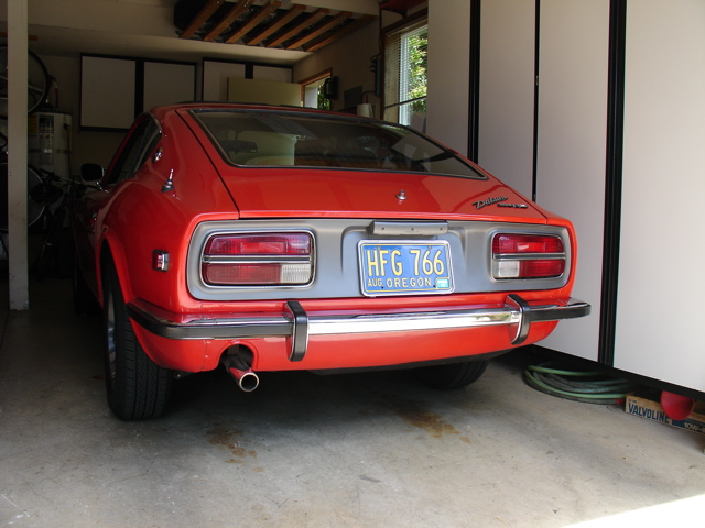

Hello , The formula I quoted is from the book , " how to restore your Z-car " by Wick Humble , ISBN # 1-931128-02-2 . This is a great book, get it from California Bills automotive handbooks . My friend did a complete resto on his 70 and this was his guide along the way . His t-finishers where painted following this formula and they look awesome, IMHO , as well some of you might recognize the factory pearl white from 70 also . I hope this pic will help in some of your decisions .
See ya
Chris
