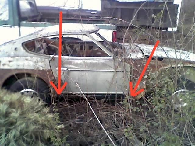

For these repairs, I would suggest that you use jack stands or ramps. Between the rear edge of the doors and in front of the rear tires you should finds some indentations in the sheetmetal's bottom edge. These indentations notch right into your stock scissor jack, and if you have the stock jack, it should show you where to put it. I have seen people use a hydraulic floor jack on the rear differential, but I've never been to keen on this method.
Here's a poor quality photo that should at least help point you in the right direction.
