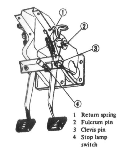

December 6, 200717 yr Author comment_230624 Well I didn't realize having a POS alternator would make it impossible to tell if my dash lights and turn signals work, but they do now. Haha, now the tail lights need to be sorted out. I can't seem to find the brake pedal switch. Its way up behind the dash right? Link to comment https://www.classiczcars.com/forums/topic/26363-bucking-and-then-died-and-wont-start-again/?&page=3#findComment-230624 Share on other sites More sharing options...
December 6, 200717 yr comment_230636 Left side of the lever about a foot above the pedal. Link to comment https://www.classiczcars.com/forums/topic/26363-bucking-and-then-died-and-wont-start-again/?&page=3#findComment-230636 Share on other sites More sharing options...

December 6, 200717 yr Author comment_230657 So thats where that thing is supposed to go. I don't have one unfortunately. Link to comment https://www.classiczcars.com/forums/topic/26363-bucking-and-then-died-and-wont-start-again/?&page=3#findComment-230657 Share on other sites More sharing options...
December 7, 200717 yr comment_230659 Check the grounds on the bulbs ..... If you have a multi-meter check for voltage... Link to comment https://www.classiczcars.com/forums/topic/26363-bucking-and-then-died-and-wont-start-again/?&page=3#findComment-230659 Share on other sites More sharing options...
December 7, 200717 yr comment_230684 So thats where that thing is supposed to go. I don't have one unfortunately.Are the wires there? Two green/red tracer with female connectors somewhere in the vicinity of where the switch would be. If you jump them together you can see if your brake lights work. Also, when you do get a switch, make sure the plastic piece that goes in the hole on the shaft is there. If not, the plunger on the brake light switch will go through the hole and your brake lights will stay on. Link to comment https://www.classiczcars.com/forums/topic/26363-bucking-and-then-died-and-wont-start-again/?&page=3#findComment-230684 Share on other sites More sharing options...
December 7, 200717 yr Author comment_230693 Well I got one from the parts store (I know I could have gotten one from the JY but its dark and raining). Its for a 260z, does that matter at all? I hooked it up to what I thought was the right wire and now it keeps blowing fuses. They DID work for a little bit though which is very encouraging. Link to comment https://www.classiczcars.com/forums/topic/26363-bucking-and-then-died-and-wont-start-again/?&page=3#findComment-230693 Share on other sites More sharing options...
December 7, 200717 yr comment_230702 Should be the same switch. Sounds like you have a short somewhere in the brake light circuit. Possibly the reason that the PO removed it. Link to comment https://www.classiczcars.com/forums/topic/26363-bucking-and-then-died-and-wont-start-again/?&page=3#findComment-230702 Share on other sites More sharing options...
December 7, 200717 yr Author comment_230750 alright, well How would I wire it with new wire? does it go battery-switch-fuse light? Or Battery-Fuse-switch-fuse-light? Something else? Link to comment https://www.classiczcars.com/forums/topic/26363-bucking-and-then-died-and-wont-start-again/?&page=3#findComment-230750 Share on other sites More sharing options...
December 7, 200717 yr comment_230760 It should just plug into the two wires I described in post #32. You'd have to look at a schematic to see path they take in order to rewire it yourself. The fact that they work but eventually blow the fuse indicates a short somewhere along the way. Might be easier to trace the short than rewire it. Check the sockets that house the brake lights and the connection there as well. Check the wires where they plug into the switch. Do they have the plastic covers on them where the terminals plug in? Link to comment https://www.classiczcars.com/forums/topic/26363-bucking-and-then-died-and-wont-start-again/?&page=3#findComment-230760 Share on other sites More sharing options...
