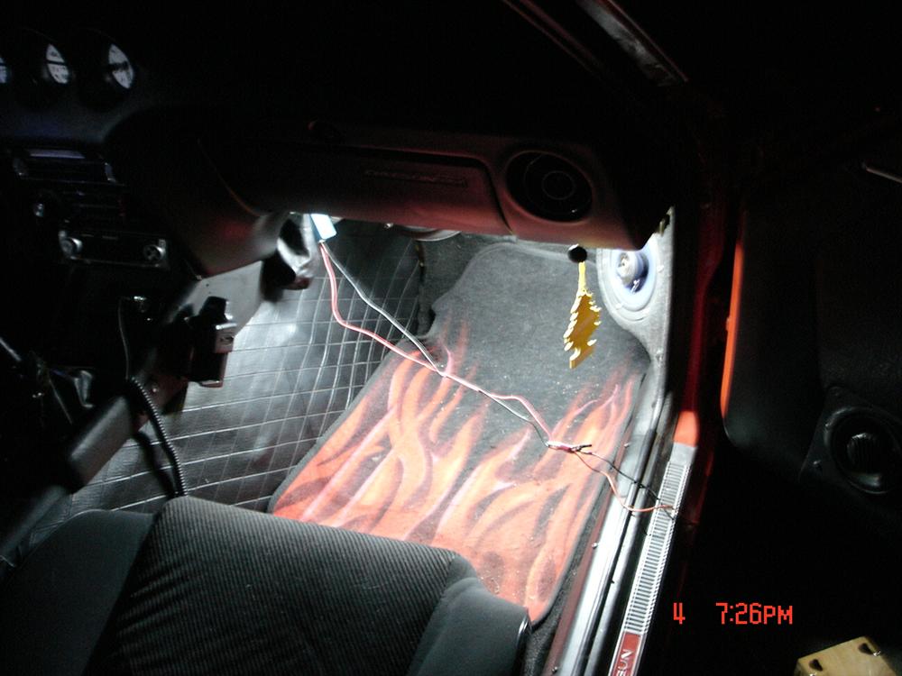

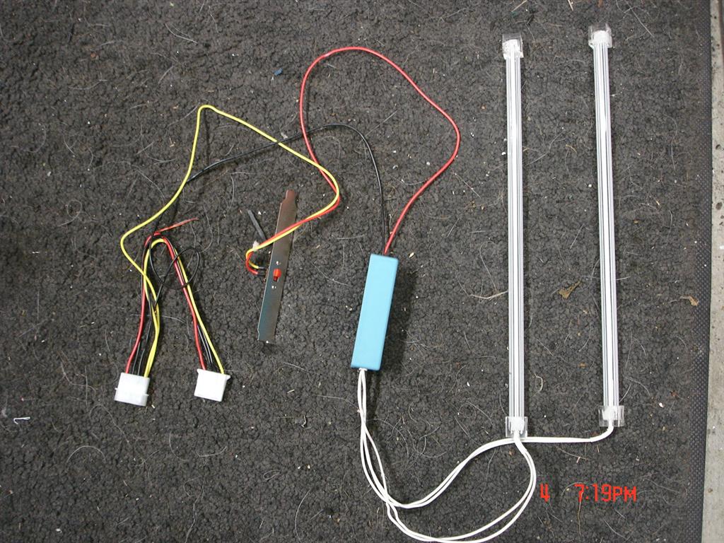

So I got on line and started looking for your basic 12 volt interior lights. this turned out to be Mission Impossible. So I used Goooogle to look deeper and found this site.... http://www.directron.com/clk12wt.html
It's a Computer supply site and I found 12" 12VDC Cold Cathode Tube lights. Used to light up the inside of a computer case with a clear side panel.

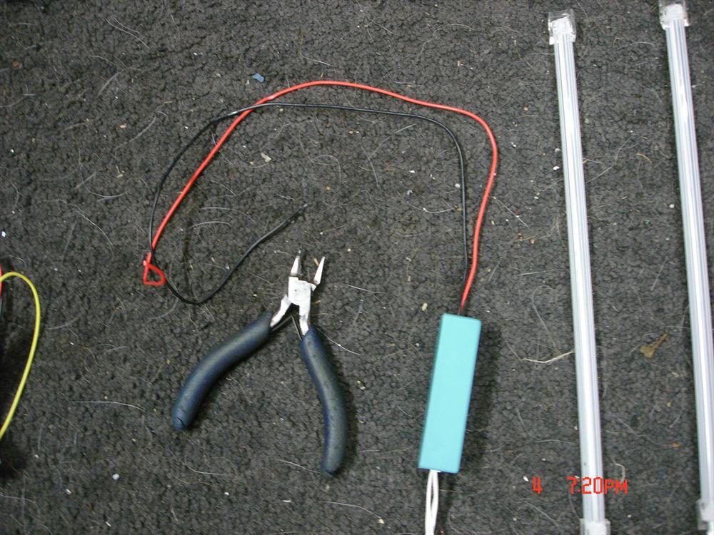

They only require 5.0Ma which is like Nothing, practically. The picture below will show before and after as well as cutting off the "T" plugs that normally plug into the inside of the computer.

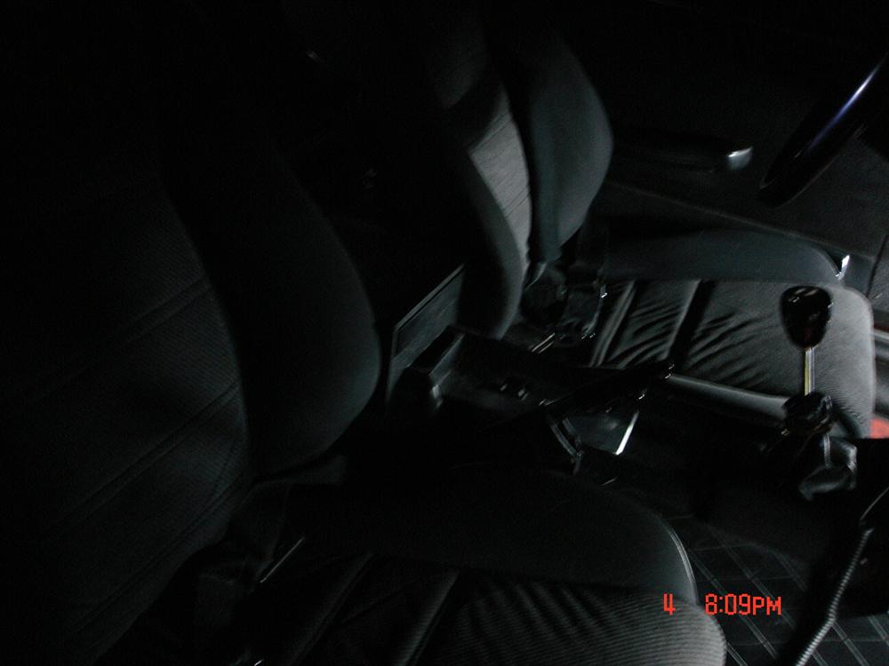

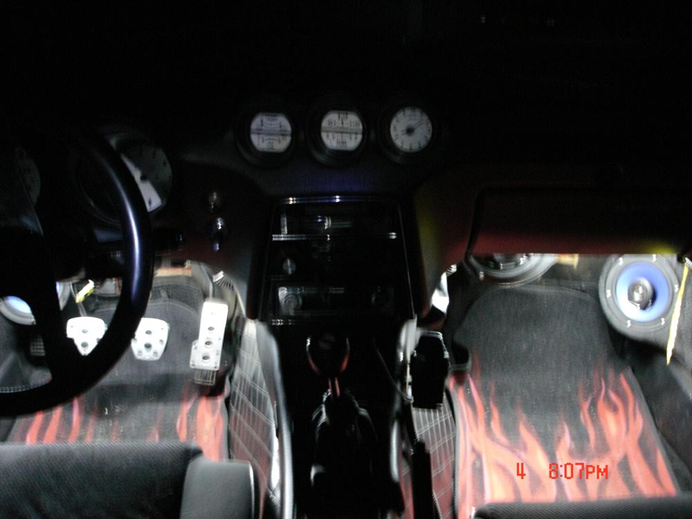

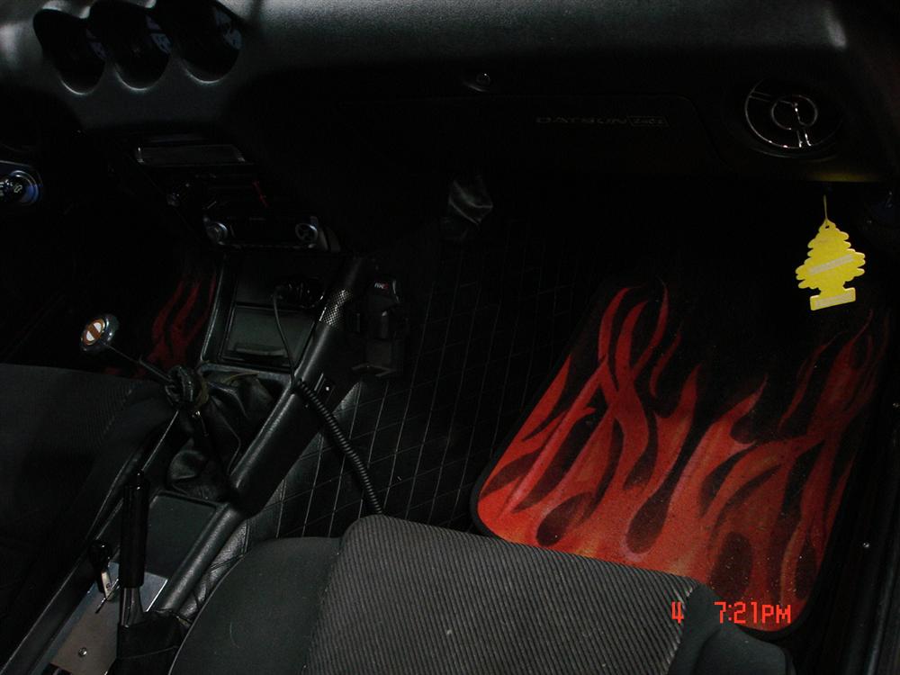

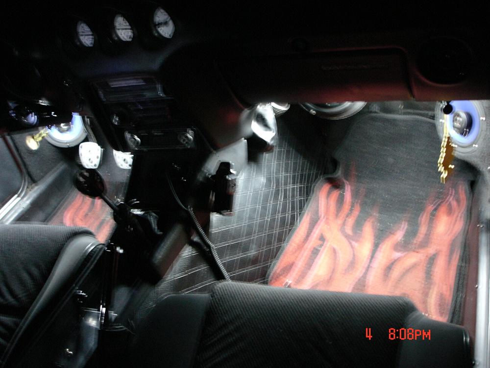

They put off a Beautiful white light when placed under the dash. I mounted the first tube at the bootom back corner of the glove box, using the supplied Velcro that came with it. It sits just on the back corner but not on the down facing panel of the glove box. Out of site but able to light everything up.
The drivers side was different. The tube sits on the upper side of the steering columnm, with the wired end touching the defrost tube and the other end just barely touching the curved dash support on the left of the steering column.
Best $15 I ever spent on lighting up a very dark interior. They sit low enough to even light the dark seats, just enough to make sure I don't end up with seat belt up my butt, AGAIN!!:tapemouth:eek:
Here's the pics..
